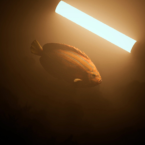

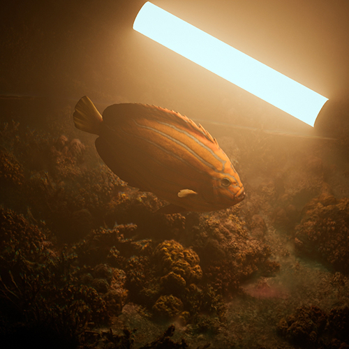

Scales the diffuse shading contribution from scene lights. Use a non-zero value to have splats respond to Arnold lights; set to 0.0 for an unshaded, radiance-only look.

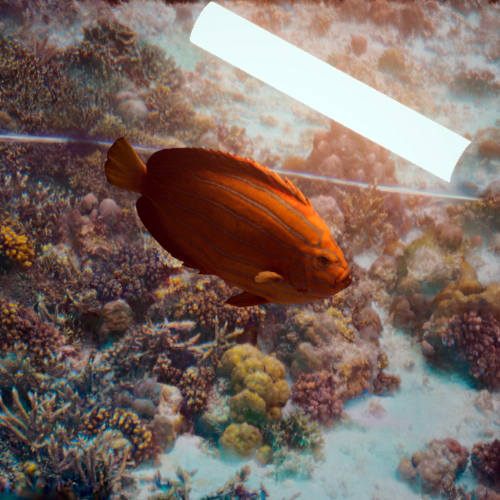

Note that the fish in the example below is a polygon mesh. This demonstrates that Gaussian splats can be mixed with meshes, curves, and volumes in the same scene, while still supporting ray-traced effects such as reflections and refractions.
| Diffuse Weight: 0 (default) Emission Weight: 0. | Diffuse Weight: 1. Emission Weight: 0. Coral splat receives diffuse lighting. | Diffuse Weight: 0. Emission Weight: 0.3. |

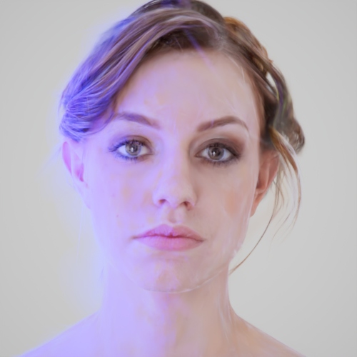

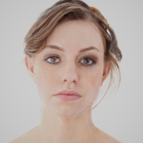

Applies a color multiplier to the diffuse component of each splat.
| No Diffuse Weight | Diffuse Tint: blue |
