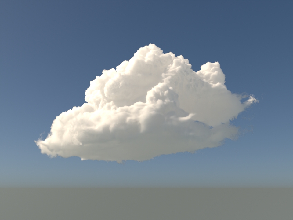

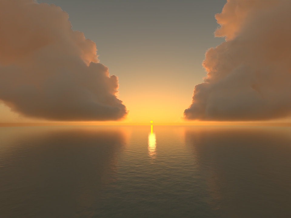

CPU volume mip-mapping speedups
wdascloud byc-cloud composition 1 composition 2 sunset clouds
original volume wdascloud original volume byc-cloud original volume composition 1 original volume composition 2 original volume sunset clouds original volume
mip-mapped volume (3 levels) wdascloud mip-mapped 3 levels byc-cloud mip-mapped 3 levels composition 1 mip-mapped 3 levels composition 2 mip-mapped 3 levels sunset clouds mip-mapped 3 levels
Speedup 1.5x 1.9x 2.6x 2.1x 1.8x
mip-mapped volume (6 levels) wdascloud mip-mapped 6 levels byc-cloud mip-mapped 6 levels composition 1 mip-mapped 6 levels composition 2 mip-mapped 6 levels sunset clouds mip-mapped 6 levels
Speedup 2.0x 2.8x 5.2x 3.2x 2.7x
mip-mapped volume (11 levels) wdascloud mip-mapped 11 levels byc-cloud mip-mapped 11 levels composition 1 mip-mapped 11 levels composition 2 mip-mapped 11 levels sunset clouds mip-mapped 11 levels
Speedup 2.1x 2.7x 7.0x 4.0x 3.2x
