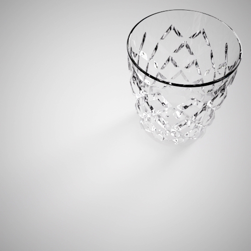

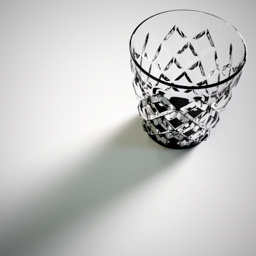

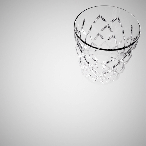

Transparent objects like clear glass now cast shadows. The look of the shadow is controlled by the new transmission_shadow_density parameter on the openpbr_surface and the standard_surface shaders. (ARNOLD-6881, ARNOLD-15863, ARNOLD-15828)
| 0 | 0.5 | 0.9 | 1 |
