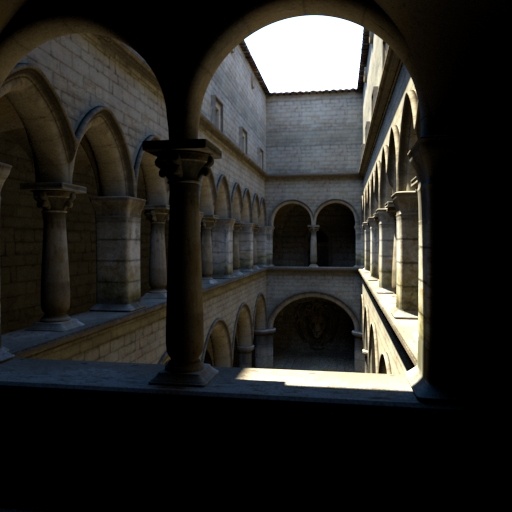

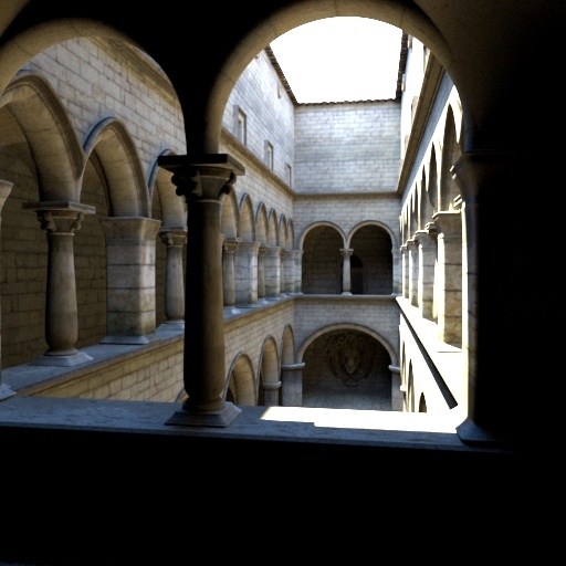

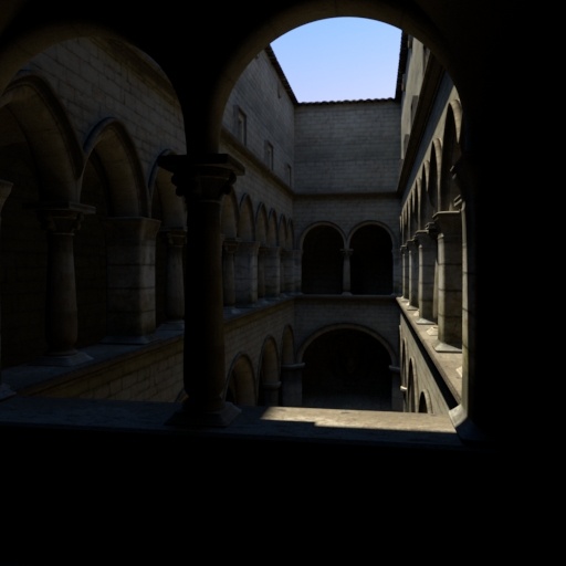

Weights the camera sample by a scalar amount defined by the shader linked to the filtermap. This shader will use as an input, u,v coordinates in image-space coords [0,1) and x,y in pixel coordinates. This allows you to darken certain regions of the image, perfect to simulate vignetting effects.
There is an optimization in place where if the filter returns pure black then the camera ray is not fired. This can help in cases such as when rendering with the fisheye camera where, depending on its autocrop setting, parts of the frame trace no rays at all.
Circular ramp mapped to the camera's filtermap to create a vignette effect

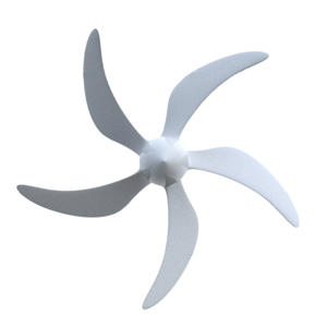

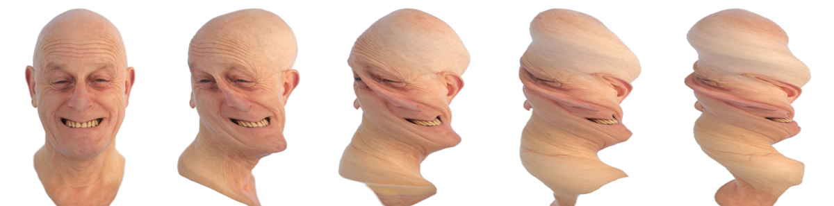

Rolling_shutter is used to simulate the type of rolling shutter effect seen in footage shot with digital cameras that use CMOS-based sensors such as Blackmagics, Alexas, REDs, and even iPhones. This method is implemented by rolling (moving) the shutter across the camera area instead of the entire image area all at the same time.
| with rolling_shutter | without rolling_shutter |
The rolling_shutter direction specifies the direction that the rolling shutter takes place. The default is off and can be set to top (top to bottom being the most common scanning direction), bottom, left or right.
| top | bottom | left | right |

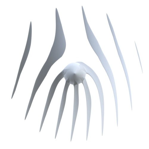

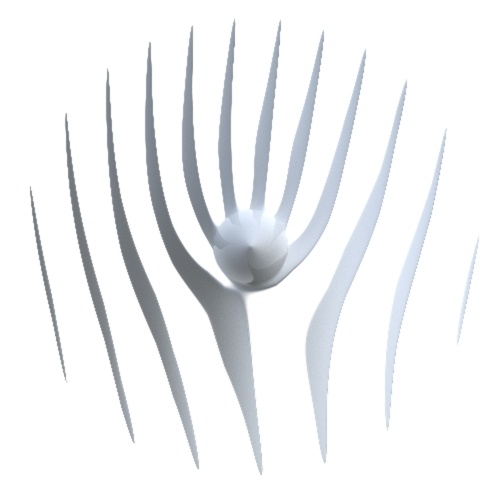

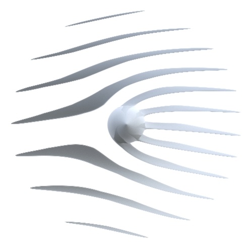

Interesting effects can be achieved when combining motion blur length with rolling_shutter:
Motion blur length from 0 to 2

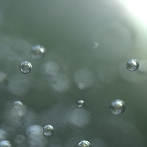

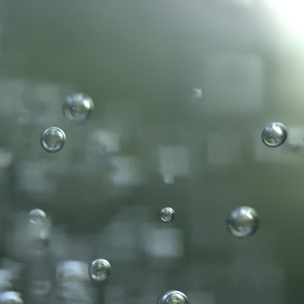

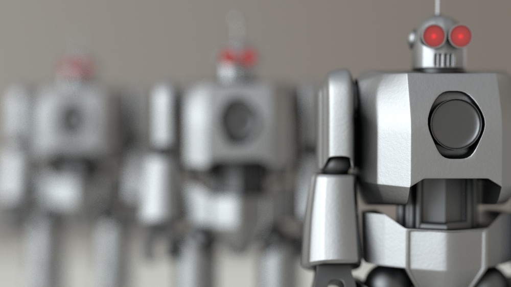

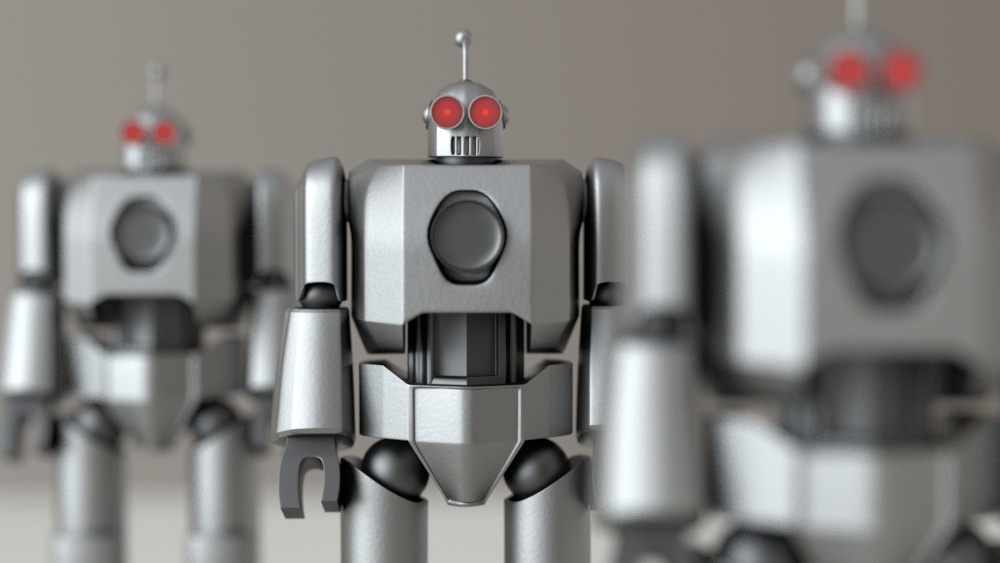

| without DOF | DOF with a large aperture_size |
This is the distance at which objects appear in perfect focus, for a non-zero aperture value.
| 6 | 8 | 10 |
The radius of the aperture in world units. The smaller the aperture, the sharper the images (shallower depth of field). In the limit, a size of zero produces no depth of field blurring.
| 0.1 | 0.2 | 0.3 |

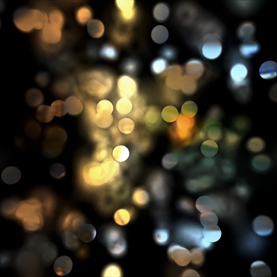

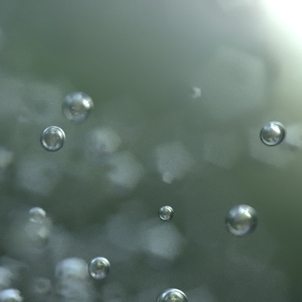

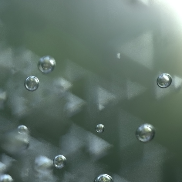

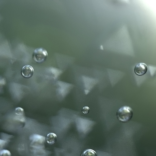

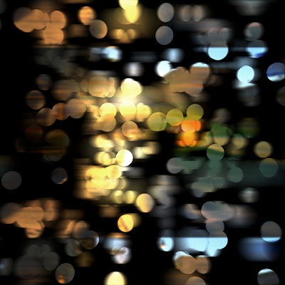

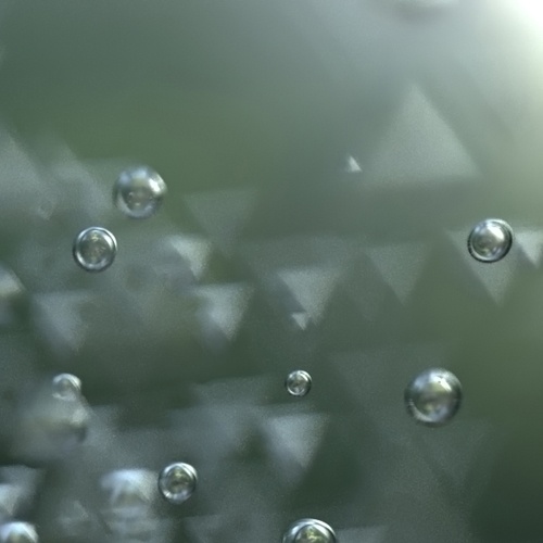

A number of blades (or polygon sides) of the polygonal aperture. 0 is considered a circle aperture.
| 3 | 5 | 7 |
The curvature of the polygonal aperture sides. A value of 0 means hard straight sides. Increasing this value results in progressively more curved edges, all the way to 1.0 which produces a perfect disk. Negative values produce a "pinched" or star-shaped aperture.
| 0 | 1 |
Rotates the aperture by the specified number of degrees.
| 0 (default) | 15 | 30 |

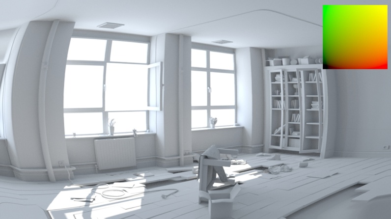

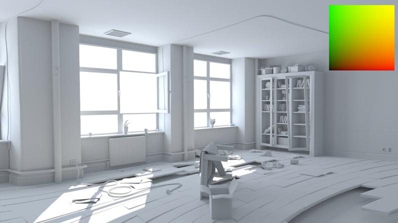

This parameter takes a 2D displacement image and uses it to distort the rendered output of the camera's lens. The left image below has been rendered using a colored ramp connected to the UV Remap attribute. In the right image, the same ramp texture has been distorted in a 2d image post-processing software package.
| uv_remap | remap image has been distorted |
When using uv_remap you should use the image shader's 'image.swrap clamp' and 'image.twrap clamp' attributes to minimize edge effects due to filtering.

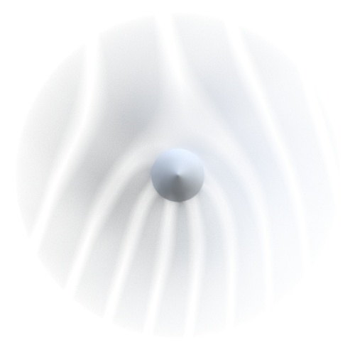

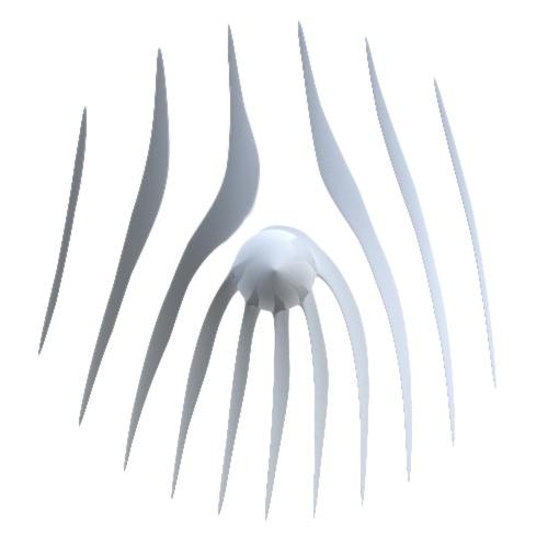

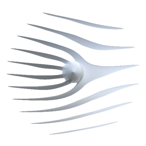

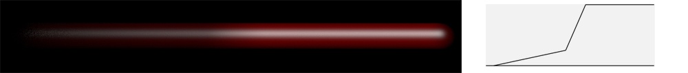

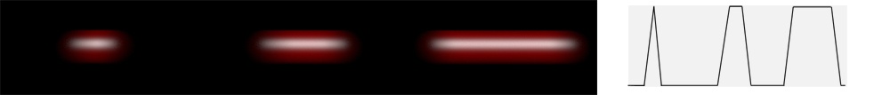

Arnold supports custom shutter shapes with the shutter_curve camera parameter. You can define as many points as required. Coordinates increase from 0 (corresponding to the shutter_start) to 1 (corresponding to the shutter_end). Values in the vertical axis must be non-negative, and it is not recommended to enter values above 1. The values are linearly interpolated between each point. In the examples below, you can see the effect different curve shapes have on the motion blur trail of a sphere that has been key-framed moving from left to right.
Various custom camera shutter curve shapes
