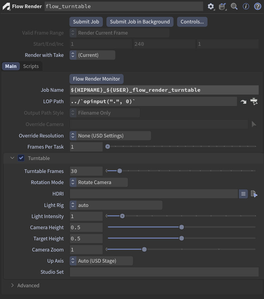

Turntable submits a turntable animation job to the Flow Render cloud service.
Turntable
Turntable Frames
Sets the total number of frames for one full 360-degree rotation of the turntable.
Rotation Mode
Determines what rotates during the animation:
HDRI
Specifies a single HDRI texture to use, instead of the Light Rig.
Light Rig
Specifies the lighting setup to use for the turntable.
Light Intensity
Scales the overall intensity of the light rig.
Camera Height
Sets the height of the turntable camera relative to the object's bounding box.
Target Height
Sets the height of the camera's look-at target relative to the object's bounding box.
Camera Zoom
Controls the zoom level of the turntable camera. Higher values move the camera closer to the subject.
Up Axis
Sets the axis used as the up direction for the turntable rotation.
Studio Set
Applies a preset studio environment to the turntable render.
