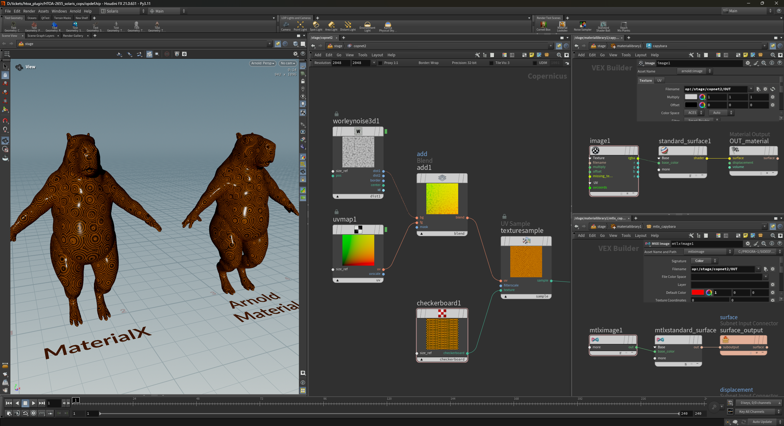

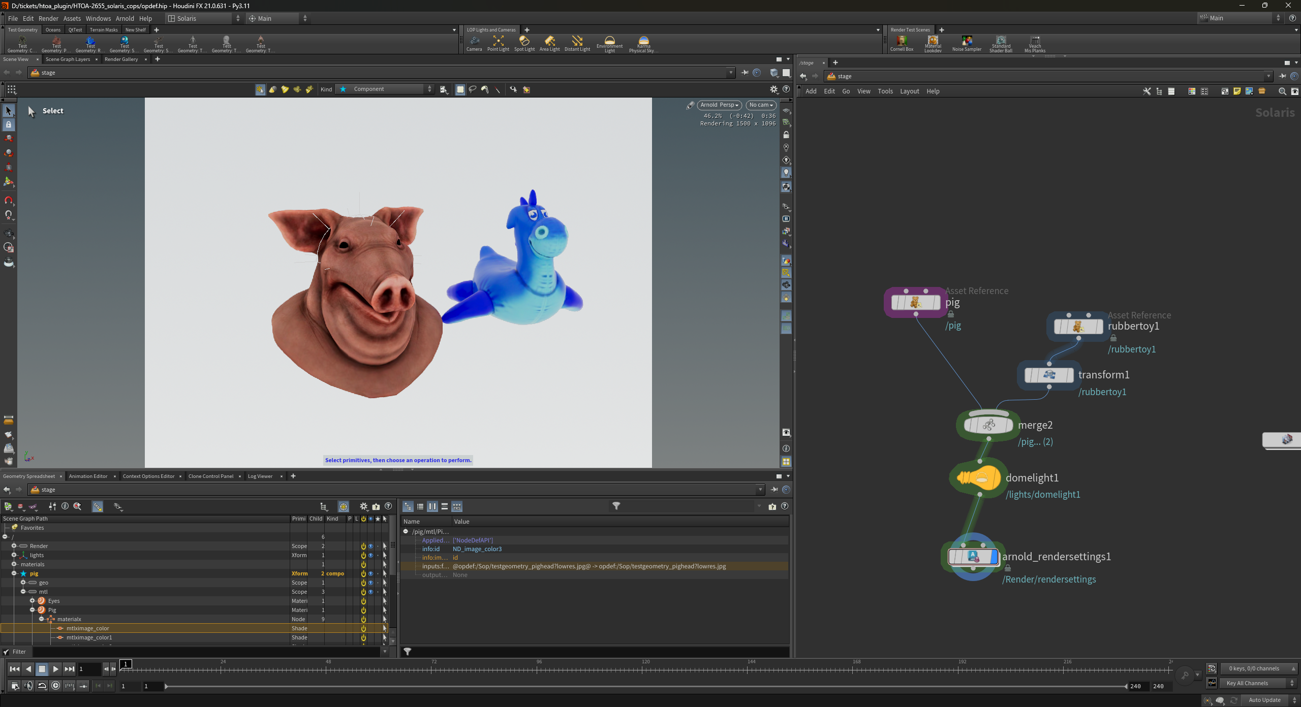

op: and opdef: texture paths from Copernicus networks interactively. (HTOA-2655)![]() |
Live op: Copernicus textures in Solaris |
Live opdef: Copernicus textures in Solaris |

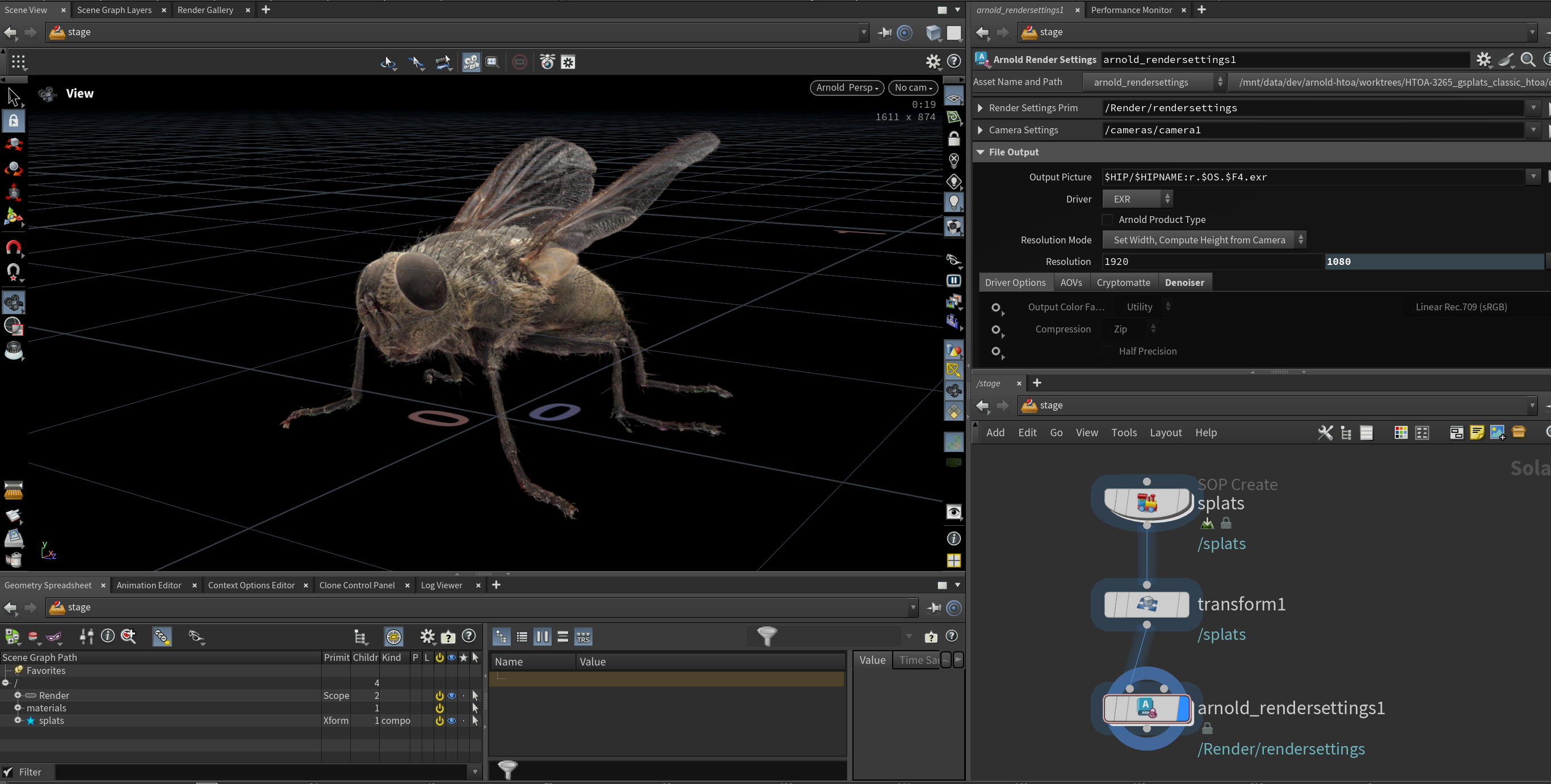

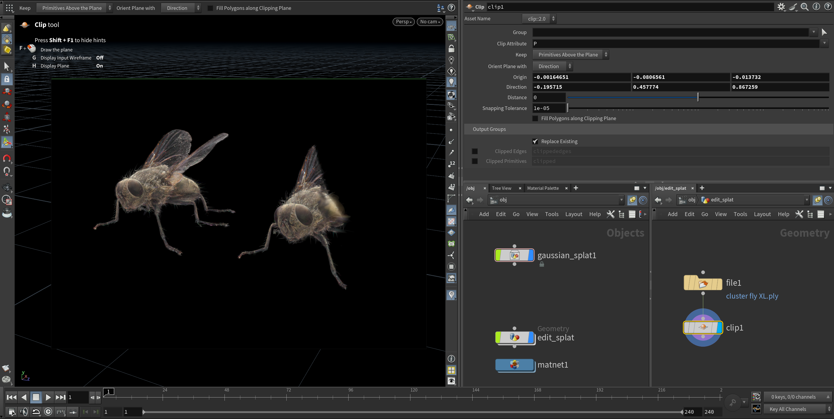

.ply files from standard 3DGS tools or drive splats from point attributes, and shade them with the Gaussian Splat Shader. In Solaris, use the Bake GSplat workflow to bake splat data and bring the points into your USD stage for rendering with Arnold. (HTOA-3265)![]() |
| Gaussian splats in Solaris |
| Gaussian splats in classic HtoA |

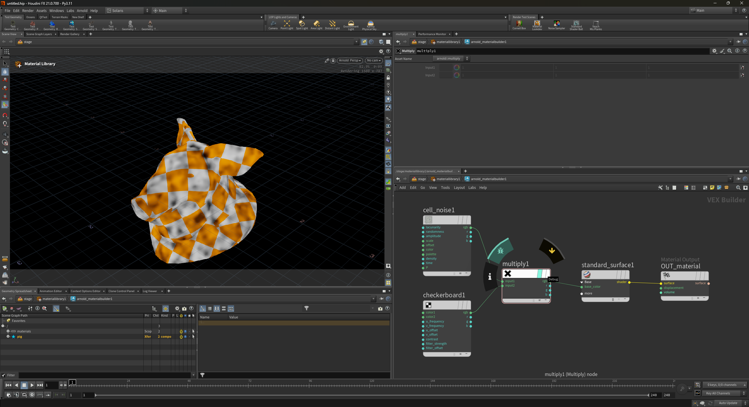

| Pattern soloing in Solaris (Arnold Material Builder) |

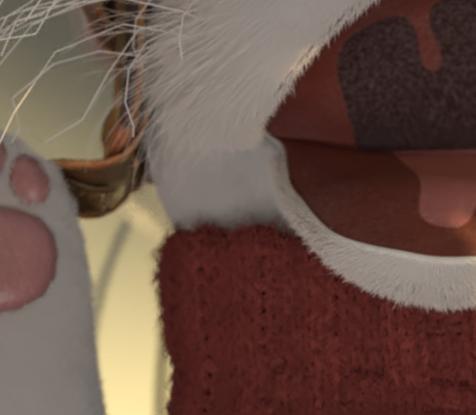

variance parameter on the noice imager has been renamed to filter_strength; the old name is still accepted as a synonym. The standalone tool's --variance/-v flags are kept as aliases for --filter_strength/-k. In the example below, note the improved denoising of the sweater, the fur, and the whiskers. (ARNOLD-14879)Noice variance: HtoA now passes variance-of-the-sample-mean to the Noice imager, matching the Arnold adaptive sampling metric so denoising scales correctly as more samples are added. (HTOA-3256)

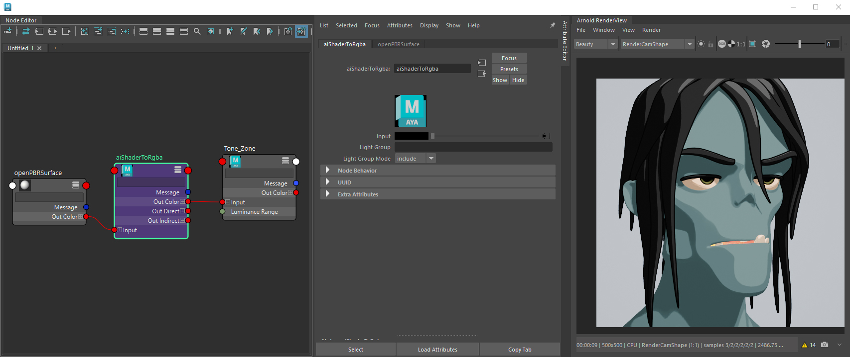

Shader to RGBA: The new shader_to_rgba node evaluates lighting for a surface shader (such as openpbr_surface) and outputs the result as RGBA that you can use in a shading tree. For example, you could feed those RGBA values into a ramp for non-photorealistic rendering. Both direct and indirect illumination are available as separate outputs, and a light group filter allows for per-light stylization. shader_to_rgba works on both CPU and GPU (out_indirect is not yet available on GPU). (ARNOLD-17679)
OpenPBR Surface > Shader to RGBA > Tone Zone shader

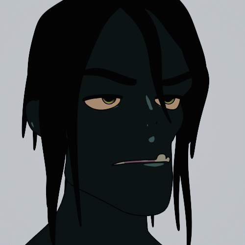

Tone zones: The new tone_zones node splits lighting into up to eight discrete brightness bands for cel-shading and non-photorealistic-rendering workflows. Zone widths are defined as simple ratios and stay stable across exposure changes. Each zone outputs a tint color and a mask that you can use for compositing. You can soften boundaries between zones independently, and chain nodes to further subdivide a zone. (ARNOLD-17680)

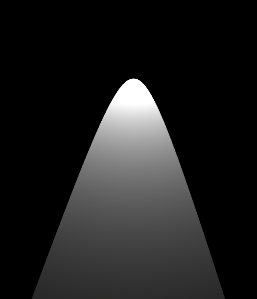

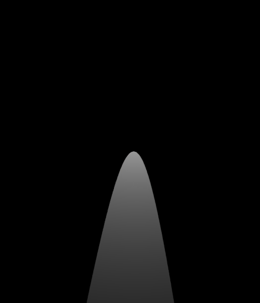

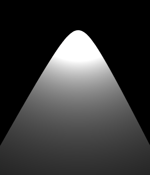

Cone angle: You can restrict area light emission to a cone around its primary axis:
| Cone angle 10 | 20 | 30 |

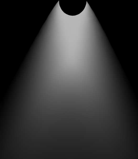

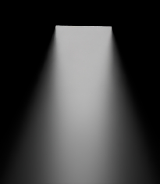

IES profiles: You can now use IES profiles with non-sphere lights.
| Sphere | Cylinder |
