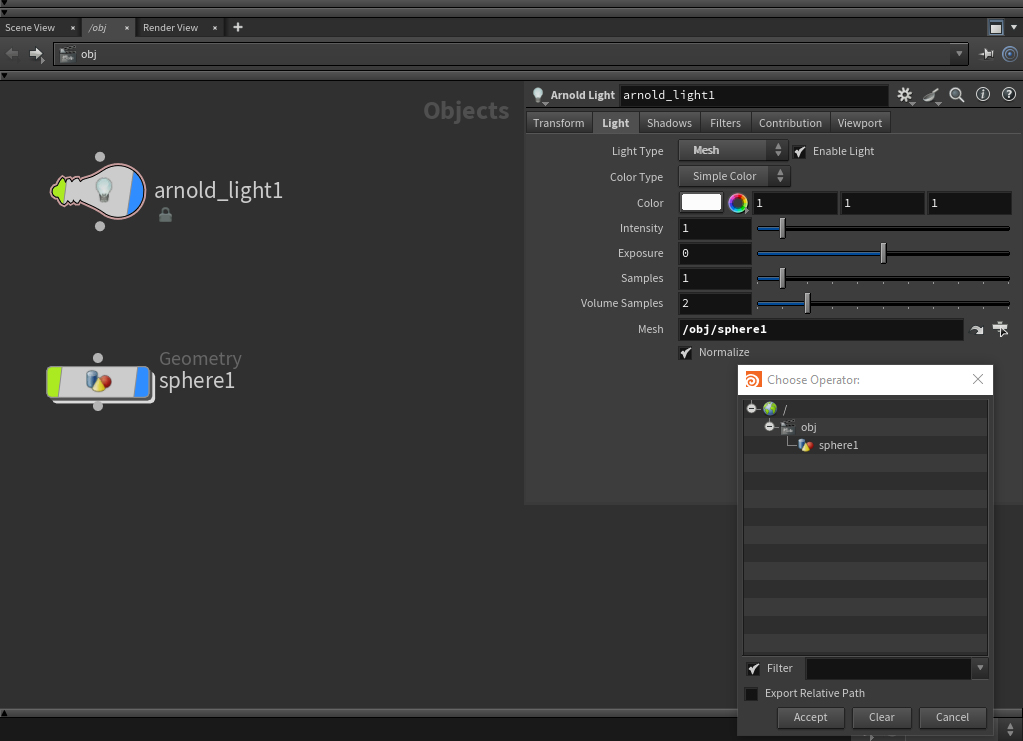

Mesh Light
In situations where conventional light shapes will not suffice, mesh lights are more suitable. Mesh lights can be used to create interesting lighting effects that would not be possible any other way. For example, effects such as neon lighting or a car light motion trail effect can be achieved more easily with mesh lights.
Mesh light workflow
