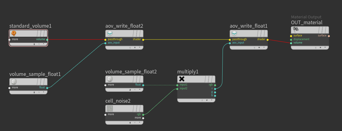

AOV Write Int
The AOV Write Int node can be used to create an ObjectID AOV.
AOV Write RGB
The user data node collects the ObjectID attribute from the geometry and passes it to the ObjectID AOV.
Daisy-chain vs Passthrough
Each AOV Write has a passthrough, allowing multiple nodes to be daisy-chained together. However, it may be simpler to use the Passthrough shader, which allows parallel evaluation in a shader network. This will also make it easier to ensure an AOV has been written before being read by placing it further down the eval list.

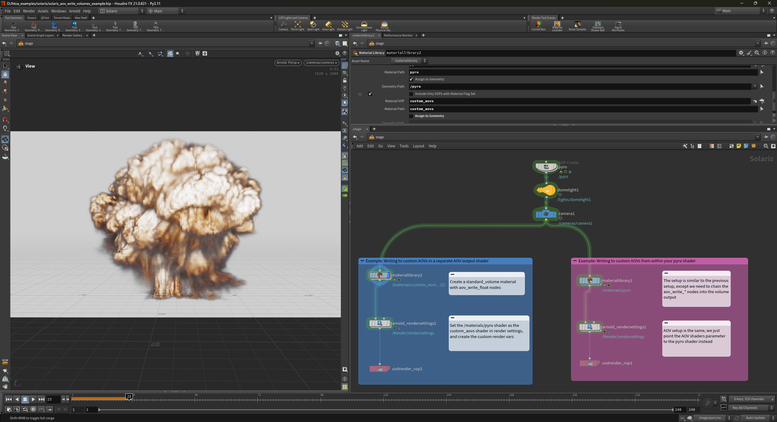

Custom AOVs with Volumes
The examples below show a setup for custom AOVs and volumes in Solaris. The workflows are:
  1. A shared 'custom AOV' shader that is independent from the pyro shader (useful when multiple volumes need the same AOV).
  2. Drive the AOV Write Float directly from the pyro shader (simpler for single volume setups).
A scene file can be downloaded here.
