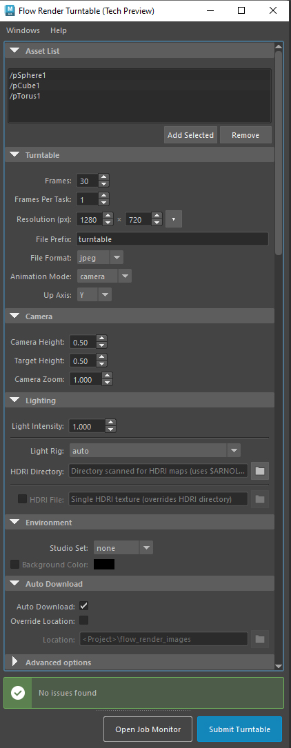

Flow Render Turntable submits a turntable animation job to the Flow Render cloud service. Open the window from Arnold > Flow Render > Submit Turntable Job.
Asset
The Turntable submitter allows a list of selected objects to be submitted, so you can render turntables for multiple assets in a single job.
Object
Specifies the objects to use for the turntable. Click Use Selected to populate the field from the current scene selection.
Turntable
Frames
Sets the total number of frames for one full 360-degree rotation of the turntable.
Resolution
Specifies the output resolution in pixels.
File Prefix
Sets the filename prefix for the rendered turntable frames.
File Format
Sets the output file format for the rendered frames.
Animation Mode
Determines how the turntable animation is driven.
Up Axis
Sets the axis used as the up direction for the turntable rotation.
Camera
Camera Height
Sets the height of the turntable camera relative to the object's bounding box.
Target Height
Sets the height of the camera's look-at target relative to the object's bounding box.
Camera Zoom
Controls the zoom level of the turntable camera. Higher values move the camera closer to the subject.
Lighting
Light Intensity
Scales the overall intensity of the light rig.
Light Rig
Specifies the lighting setup to use for the turntable.
HDRI Directory
Specifies a directory to scan for HDRI maps. Uses the $ARNOLD token by default.
HDRI File
Specifies a single HDRI texture to use, overriding the HDRI directory.
Environment
Studio Set
Applies a preset studio environment to the turntable render.
Background Color
When enabled, overrides the background with a solid color. Use the color swatch to set the color.
Download
Auto Download
When enabled, automatically downloads the completed turntable render from Flow Render.
Override Location
When enabled, overrides the default download location.
Location
Specifies the local folder where the downloaded turntable render is saved. Defaults to <Project>\flow_render_images.
