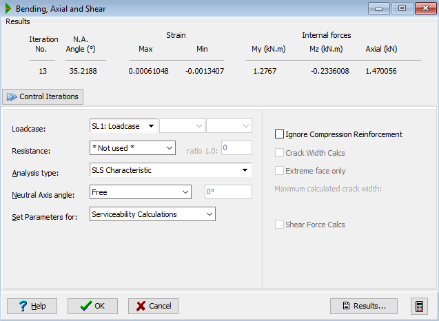

  3. From the Design Section navigation window toolbar use the drop down dropdown to select Bending, Axial and Shear which will open the appropriate analysis form.
  4. Ensure that Analysis type is set to “SLS Characteristic” and select “SL1: Loadcase” in the Loadcase drop down.
  5. Select “Not used” in the Resistance drop down.
  6. Select “Free” in the Neutral Axis angle drop down and ✓ OK the error message that may appear as it is just a warning.

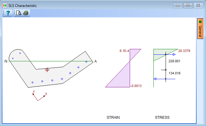

  1. Open the results viewer with the Results button. The tables of Maximum and Minimum Strains show the concrete and steel stresses to be 20.34N/mm² and -219.99N/mm² respectively (we can compare these with the allowable limits of 19.125N/mm² for the concrete and -400N/mm² for the reinforcement showing an overstress in the concrete (as noted in the error message).

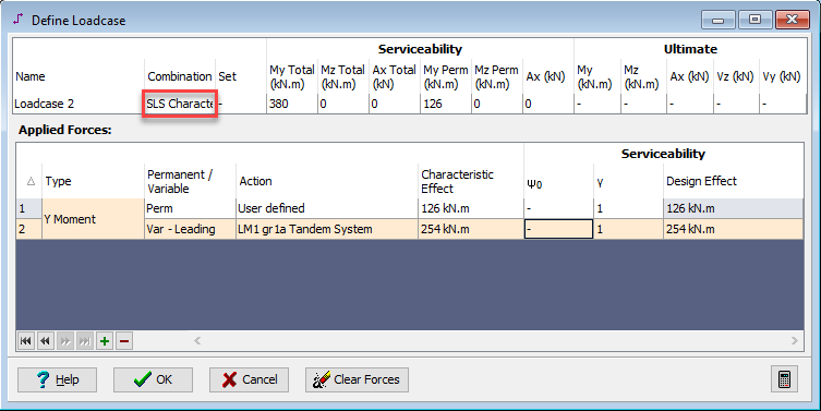

  4. Create a second Loadcase by using the add icon in the Design Section navigation toolbar and selecting “Loadcase”. Change the name to “Loadcase 2”.
  5. Use the “+” button near the bottom of the form to add 2 rows to the table.
  6. On the first row of the table, select “Y Moment” from the drop down options in the Type column.
  7. Enter a value of “126kNm” in the Characteristic Effect column.
  8. Select “Perm” from the Permanent/Variable drop down options.
  9. On the second row of the table, select “Y Moment” from the Type column drop down options.
  10. Enter a value of “254kNm” in the Characteristic Effect column.
  11. Select “Var-Leading” in the Permanent/Variable field.
  12. The values in the Serviceability γ column for both rows should be set to “1”.
  13. In the line of data at the top of the form set the Combination to “SLS Characteristic”.

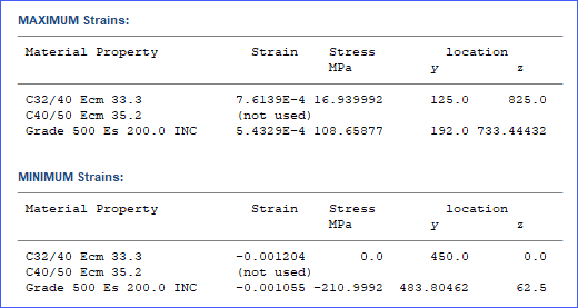

  24. The concrete and reinforcement stresses are shown in the MAXIMUM and MINIMUM Strains table. The concrete stress is 16.94N/mm² and the reinforcement stress is -211N/mm². Close the Results Viewer.

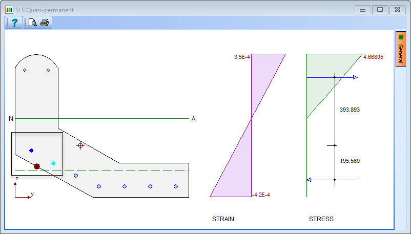

  25. In the Bending, Axial and Shear form select “SLS Quasi-permanent” in the Analysis type field.
    This analysis type can be selected because the edge section is now part of the structure and permanent dead loads are being considered combined with live loads.

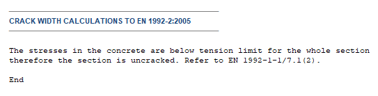

  26. Tick the Crack Width Calcs tick box and open the results viewer, which shows that the section is uncracked.

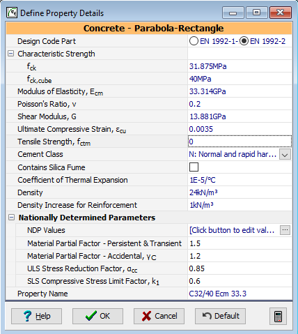

    To force the section to crack we can set the tensile strength of the concrete material to zero, but bear in mind that this value will also be used in calculation of the crack spacing – as will be shown in the results
  28. In the Materials navigation window select the “C32/40” concrete property which will open the Define Property Details form.
  29. Set the value of Tensile Strength, fctm to “0” and use ✓ OK to close the form.

  30. In the Design Section navigation window toolbar use the drop down dropdown to select Bending, Axial and Shear to analyse again. The maximum crack width is now 0.127mm.

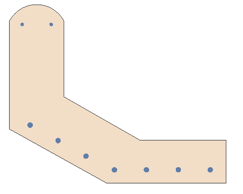

  31. It is also possible to find the crack width between specified bars. We want to find out the crack width between the two outermost bars at the left hand side of the beam.
  32. To do this draw a box around the two bars. Open the Results Viewer to display the crack width calculations considering just those bars. The maximum crack for those bars is 0.0597mm.
