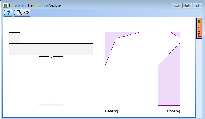

  10. In the Profile part of the form set Type to be “EN 1991-1-5 Fig 6.2 Non Linear” and the Type of Deck: to “composite decks” and the deck is “Surfaced” with a depth of “0.1m”
    This shows a profile as defined in EN1991-1-5 but the program assumes the top of the section is the top of the upstand. We therefore need to lower this profile so the top of it is aligned to the top of the slab. We also need to add a constant temperature portion from the top of the slab to the top of the upstand.

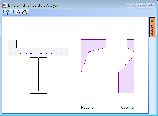

  11. To modify this profile we must now change the Type to “User Defined.”
  12. In the Heating Differences and Cooling Differences columns of the lower table, change the height and temperature values to those shown below by adding a row after the first row and then starting at the bottom of the list and work your way up with the new values.
    Differential Temperature Analysis Differential Temperature Analysis

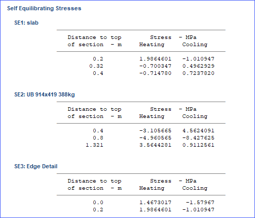

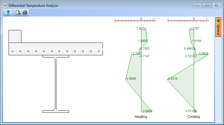

  13. The calculations are done automatically where the fully restrained “Relaxing Moments and Axial Forces” are displayed on the data form. Ensure that the Ignore Reinforcement check box is “unticked." The primary self equilibrating stresses are displayed by changing the Display option to “Stresses”.
  14. Click on the Detailed Results... button to see all the results including the self equilibrating stresses.

If a beam, made up from this section and temperature profile, was fully constrained along its length then the following forces and moments would be induced along the span:
Temp rise
M Sagging F Comp
272kNm 984kN
Temp fall
M Sagging F Tension
298kNm -776kN
The self equilibrating Primary Stresses at the top and bottom of each component can be seen in the results shown above.
