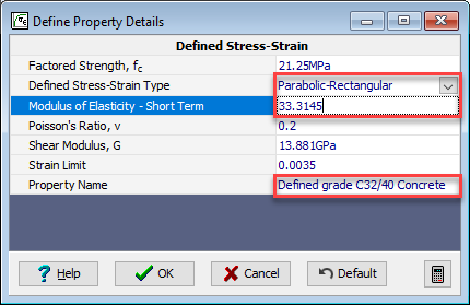

  4. Change the Factored Strength to “21.25” (ie fcd = fck / γc = 31.875/1.5) and choose “Parabolic-Rectangular” from the dropdown in the Defined StressStrain Type field. This opens a secondary form in which the Set Curve Default to: field should be set to “Eurocode 2”. Close this secondary form and set the Modulus of Elasticity to 33.3145GPa and the Property Name to be “Defined grade C32/40 Concrete” before closing the Define Property Details form with the ✓ OK button.

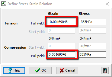

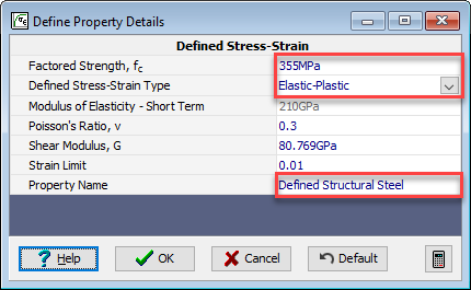

  1. Add another material as a “Defined Stress-Strain” type. Set the Factored strength to “355MPa” (ie. 355/1.0) and the Defined Stress-Strain Type to “Elastic Plastic”. Note that the default strain at yield is +/-0.001775 (giving an elastic modulus of 200kN/mm².) Change both tension and compression values to +/-0.00169048 to give an elastic modulus of 210kN/mm². Close the secondary form and ensure that the Strain Limit is set to 0.01. Set the Property Name to “Defined Structural Steel” before closing the Define Property Details form with the ✓ OK button.
Define Stress-Strain Relation Define Property Details
Stress Strain Stress Strain

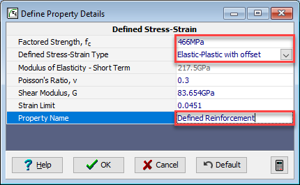

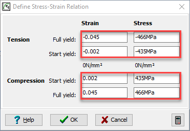

  1. Add a third new material as a “Defined Stress-Strain” type. Set the Factored strength to “466MPa” and the Defined Stress-Strain Type to “Elastic-Plastic with offset.” For reinforcement to Eurocodes the compressive full yield stress is reduced to 466MPa at a strain of 0.045. The compressive start yield stress 435Mpa at a strain of 0.002. Enter this information in the Define Stress-Strain Relation data form and then close this form using the ✓ OK button. Set the Strain Limit to 0.04501 and the Property Name to “Defined Reinforcement” before closing the Define Property Details form. Click ✓ OK on the Define Property Details form.

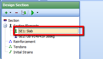

  5. Select the “slab” element in the navigation tree, which will open the Define Section Element form.
  6. Change the property to be the “Defined grade C32/40 Concrete” property and close the form with the ✓ OK button.

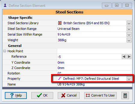

  7. Repeat this for the steel section changing the property to be the “Defined Structural Steel” property. Close this form with the ✓ OK button.
    Stress Strain

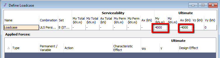

  10. Open the Define Loadcase data form using the button in the navigation window toolbar, and select Loadcase. Then enter “4000” and “-4000” in the My and Ax fields in the Ultimate sections of the top table. Close the Define Loads data form using the ✓ OK button.
    Stress Strain

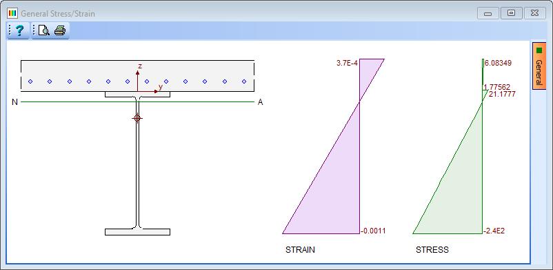

  11. To analyse the section click on the drop down part button in the navigation toolbar and select General Stress Strain.
  12. Set the Loadcase to “SL1: Loadcase” and Resistance to “Not used”. Ensure that the Analysis type field is set to “General Stress/Strain”. The maximum and minimum stresses can be obtained from the results viewer by clicking on the Results button.
    Stress Strain
  13. Produce a print preview of the combined text output and graphics by using the Print Preview menu item which may be found under the “More Buttons” tab located immediately to the right of the “Save as...” button on the Results Viewer form. Both the print Preview and results viewer windows can be closed.
    Stress Strain

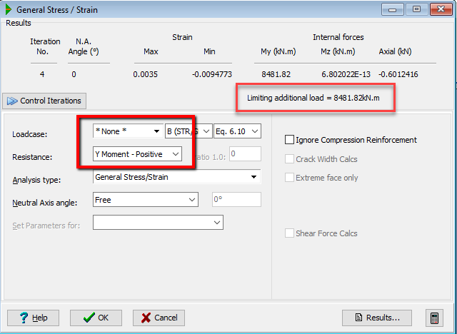

  14. To obtain the sagging bending moment resistance set the Loadcase field to “None” (clicking ✓ OK on the error message) and the Resistance to “Y Moment – Positive”. The resistance will be shown as the Limiting Additional Load on the Bending, Axial and Shear form.
    Stress Strain
