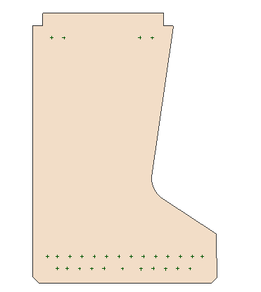

The pre stressed section defined in Chapter 2 is opened and the slab and edge section are removed from the section definition.
The section represents the mid span section of a 25m long beam which has been cast and stressed and is about to be released from its mould. The concrete strength at this stage is based on grade C32/40 concrete and the relaxation loss in the tendon force is assumed to be 1.25%. The self weight moment is calculated based upon a weight density of 24kN/m³ and applied in the load table. (Note however that a density of 25kN/m³ is used for some other examples in the manual to allow for the additional 1kN/m³ due to the tendons). An SLS stress analysis is carried out assuming that the neutral axis remains horizontal, and the elastic modulus is set to the short term modulus.

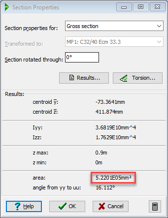

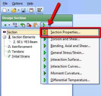

| Analyze | Section Properties |
The cross-sectional area is 0.522m². If we assume that the weight density is 24kN/m³ and the length of the beam is 25m, then an My bending moment of 978.75kNm (i.e 0.522×24×25x25/8) must be applied to the beam.
Click the ✓ OK button to close the Calculate Section Properties form.

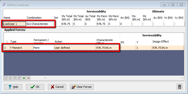

Open the Define Loadcase data form using the button in the navigation window toolbar, and select Loadcase.
Click on the “+” button near the bottom of the form to add a row to the table. In this added row select “Y Moment” from the Type drop down list and enter a value of “978.75kNm” in the Characteristic Effect column. Also, set the Permanent/Variable field to “Perm”.
In the data at the top part of the form set the Combination to “SLS Characteristic” and change the loadcase name to “Loadcase 1”.
Click on the ✓ OK button to close the Define Loadcase form.

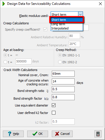

By default the elastic modulus used in the calculations will be interpolated between the long and short term values and as the load is totally “Permanent” the modulus will be equal to the long term value. To force the short term value to be used we use the Set Parameter for: field to “Serviceability Calculations” and in the displayed sub-form set Elastic Modulus used: to “Short Term”. Close the sub-form with the ✓ OK button.

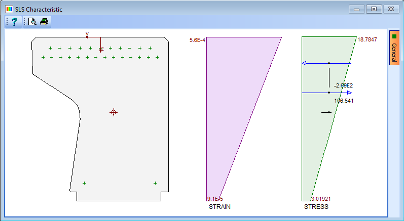

The iterations now converge and the graphic display is shown as:

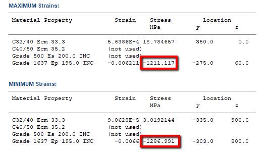

Click on the Results button to display the Results Viewer.
The maximum stress in the tendons is -1211.117N/mm². The minimum stress is -1286.991N/mm².
The full stress in the tendon should be the tendon force divided by the tendon area = 238000/181 = 1314.9N/mm². The difference in these values is due to elastic deformation losses.

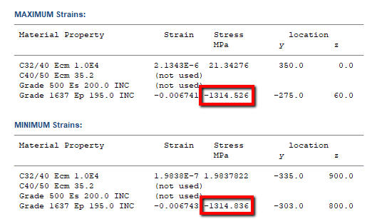

Analyse toolbar button in the navigation widow to open the Bending, Axial and Shear form. Click ✓ OK on the Error message (note that the section is over-stressed – this would obviously require action, but for this example we will ignore it) and then click on the Results button to display the Results Viewer.
The maximum and minimum stresses without elastic deformation losses are now -1314.526N/mm² and -1314.836N/mm² respectively.
