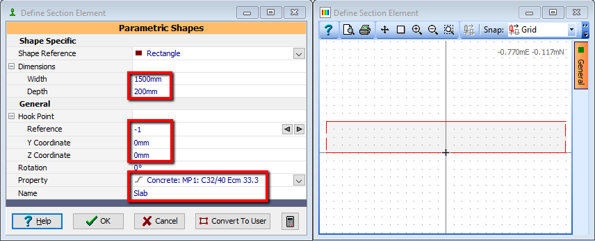

  3. Select Design Section at the bottom of the navigation window and use the + button at the top of the window to create a new section element as a Parametric Shape which will open the Define Section Element form.
  4. Set the width to be “1500mm” and the height to “200mm”. The slab is to be positioned so that the midpoint of the bottom face is at the origin. This is done by changing the Hook Point Reference to be “-1” and then setting the coordinates to (0, 0).
  5. The two short edges of the slab are identified as continuous faces by clicking once on each (they turn to dashed lines) and the material for the slab is set to grade C32/40 concrete by using the drop down list in the Property field. Change the element Name to “Slab” before closing the form with the ✓ OK button.

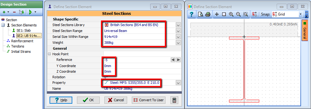

  6. Create a second element to represent the steel girder by using the + button at the top of the navigation window and selecting “Steel Sections”. Use the dropdown list to ensure that the Steel Sections Library is set to “British Sections” and the Steel section range to “Universal Beam”. Then select the Serial size as “914x419” and the weight to “388kg”. Select the “Steel” material from the Property dropdown list.
  7. To locate the top of the flange at the centre of the underside of the slab, change the Hook Point of the steel section to “-5” and set the coordinates to (0, 0).
  8. Close the Define Section Element form by clicking on the ✓ OK button.

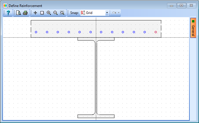

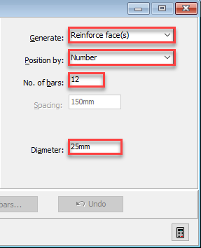

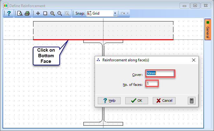

  9. In the Navigation window click on Reinforcement. Set the Generate field to “Reinforce face(s)”, set the No. of bars to “12”, set the bar Diameter to be “25mm” and then click on the bottom edge of the slab, which will open a secondary data form.
    Dialog Define Reinforcement
  10. In this form set the cover to be “50mm” and the number of faces to be “1” and then click on ✓ OK to draw the bars.
  11. Close the Reinforcement data form using the ✓ OK button.
