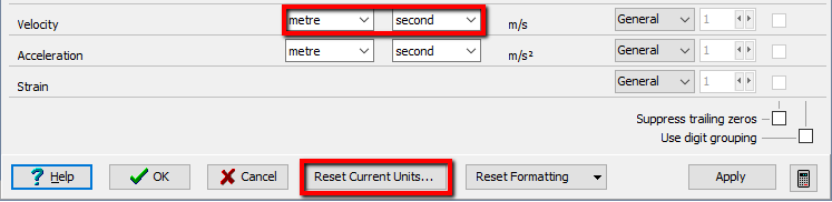

  11. Open the Edit Units form using the menu item Options | Edit Units. Use the Reset Current Units... button and then change the units for velocity to “m/s”.
    change units
By default the unit formatting is set to "General". Format style for individual unit types can be set here, or use the Reset Formatting drop down and select "Default" for alternative format style for all unit types that is applicable for engineering use.

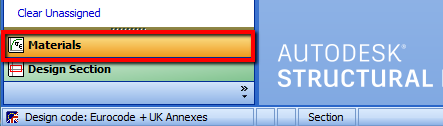

    f. At the bottom of the left hand side navigation pane, ensure that the Materials group is selected.
    Materials

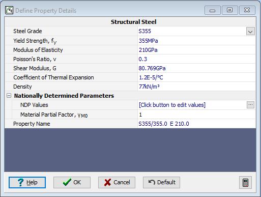

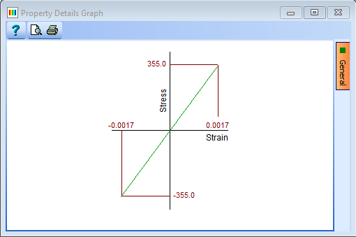

    k. Create a Structural Steel material using the default values. Click on ✓ OK to accept.
    Property Details Graph Define Property Details
