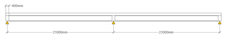

The definition of a two span prestressed beam bridge deck is given in example 10.1 and will be used for the basis of this example.
Prestressed Beam Bridge Deck Prestressed Beam Bridge Deck Prestressed Beam Bridge Deck
The objective of the exercise is to compare the permanent action stresses at the time the bridge is open to traffic (60 days) with those at the end of the bridges life. The top and bottom precast beam and insitu stresses will be compared at the end of the beam nearest the pier and at mid-span. The aging coefficient will be determined by the program.
All other parameters can be found in the outline of example 10.1

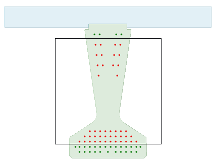

  7. Click anywhere on the beam side elevation in the graphics window to open the Pre-tensioned Beam Tendon Definition form which will allow editing of the tendon data.
  8. Use the mouse on the section graphics display to window round all the tendons except those in the top and two bottom rows.
  9. Click on the small “-“ button at the bottom of the tendon table to make these tendons inactive.
  10. Click on the ✓ OK button to close the form and return to the analysis.
    Beam Definition
  11. The analysis graphical display should now show that the stresses are more acceptable and that with some debonding at the ends of the tendons the section will work.

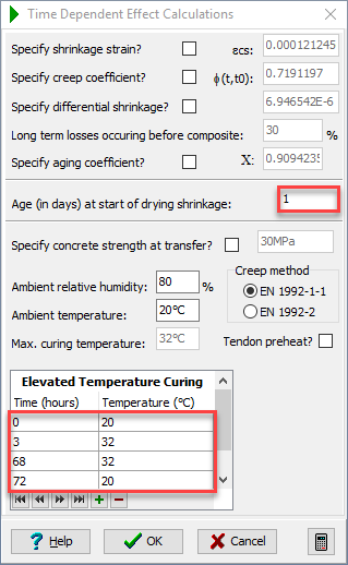

  12. For this example we are going to reduce the curing time from 4 to 3 days but elevate the curing temperature from 20 to 32 degrees. This temperature will be ramped up over three hours and ramped down at the end over 4 hours.
  13. On the Analysis form, select “Time dependent effect calculations” in the Set parameters for field. This opens the “Time Dependent Effect Calculations” form.
  14. Set the Age (in days) at start of drying shrinkage field to a value of “1”.
  15. In the “Elevated Temperature Curing” table near the bottom of the form, click on the “+” button four times to add four rows to the table.
  16. Set the time in ascending order to be “0,3,68,72” hours and the corresponding temperatures to “20,32,32,20”.
  17. Close the form with the ✓ OK button.

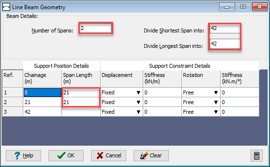

  28. Click on the “Structure Geometry” icon in the navigation panel to open the Line Beam Geometry form and set the number of spans to “2”.
  29. Set Span Length in both rows to “21” and both Divide *** Span into fields to a value of “42”.
  30. Close the Line Beam Geometry form using the ✓ OK button.

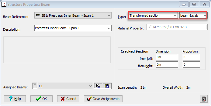

  33. Click on the Prestress Inner Beam - Span 1 object in the navigation pane to open the Structure Properties: Beam form.
  34. Set the Properties / Type: fields to “Transformed section” and “beam & slab”.
  35. Click on the left hand span in the graphics window to assign it where the span will be highlighted in red.
  36. Click on ✓ OK to close the form.

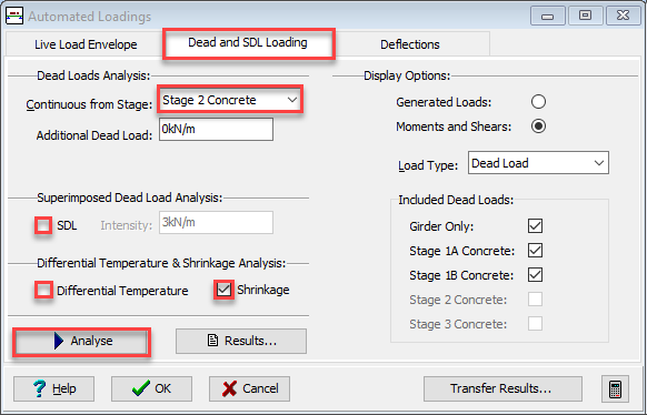

  38. In the main menu select Data | Automated Loading... to open the Automated Loadings form.
  39. Select the Dead and SDL Loading tab at the top of the form and set the Continuous from stage field to “Stage 2 Concrete”.
  40. Tick the tickbox for Analyse for Shrinkage and ensure that no other boxes are ticked.
  41. Click on the Analyse button. The bending moment for each construction stage should be that for a simply supported beam. This is because the beam only becomes continuous after the stage 1b concrete has hardened.

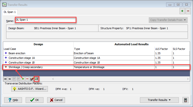

  43. Change the Name of the transfer set to “DL Span 1” and then click on the “Set Default Mapping” toolbar button Mapping at the bottom of the form to map the default construction loads cases to the appropriate load effects tables in the Design Beam.
  44. Add (+) one more row to include the differential shrinkage load case (note the load factors).
    Beam Definition
    A second transfer set can now be created for the same load cases but for the second span.
  45. Click on the “+” button in the top right corner of the form to add an additional set.
  46. Set the Name to “DL Span 2” and then replicate the transfer table by clicking on the Copy Transfer Details From button and selecting “DL Span 1”.
  47. To complete this second transfer set, ensure that the second span beam is selected in the graphics window so that the correct Design Beam: is shown in the data form.
  48. Click on the Transfer Results button and select “Transfer All Sets”. A Transfer Report form is displayed which can be closed if all is successful.

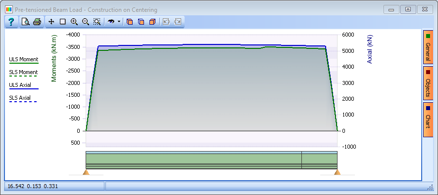

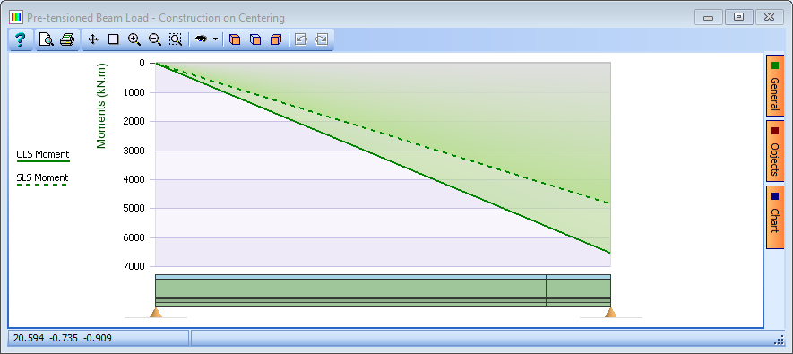

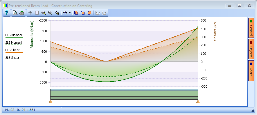

    1. the external loading
    2. the primary prestress effects
    3. the prestress secondary effects
    The results below are displayed by selecting the relevant Prestress Effects radio buttons on the form.
    I.
    Prestress Effects
    II.
    Prestress Effects
    III.
    Prestress Effects
  60. After inspecting this data click ✓ OK on the Define Pre-tensioned Beam Load form.

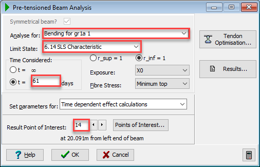

  66. Click on the Analysis toolbar button at the top of the navigation window to open the Pre-tensioned Beam Analysis form.
  67. Set the Analyse for field to “Bending for gr1a 1” and dismiss any confirm and warning forms that may be displayed by clicking “Yes” and ✓ OK as necessary.
  68. Ensure that the Limit State field is set to “SLS Characteristic”.
  69. Set the Time considered to be “61” days and set the point of interest to be at point 14 (20.091m from left end of beam).
  70. Click on the Results button to display the results.

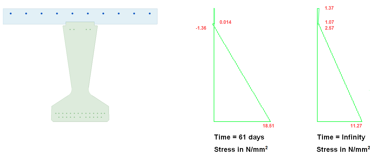

  74. At the bottom of the stress summary for SLS Characteristic loading, the values of stress at the top and bottom of both prestressed and insitu concrete are displayed and should be the same as those displayed on the graphics. These are:
Stress Slab PC Beam
Top Stress 0.014 N/mm² -1.36 N/mm²
Bottom Stress 0.014 N/mm² 18.51 N/mm²
  1. Just above the Stress Summary Table are the calculations for the “Structural Effects of Time Dependant Behaviour”. The calculated value for the ageing coefficient is 0.90942.
  2. Change the Time Considered: to be infinity and the stresses are recalculated to be:
Stress Slab PC Beam
Top Stress 1.37 N/mm² 2.57 N/mm²
Bottom Stress 1.07 N/mm² 11.27 N/mm²
  1. The calculated value of the ageing coefficient is 0.82948. Below is a summary of the stresses at the section.
