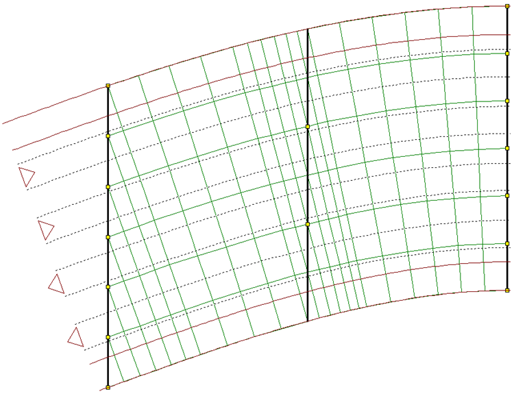

A pre-prepared two span grillage model of a 500mm thick, curved slab, as shown below is supplied with dead and superimposed loads already applied. A convoy load which will represent two Assessment Load Wagons will also be applied.
Curved Slab

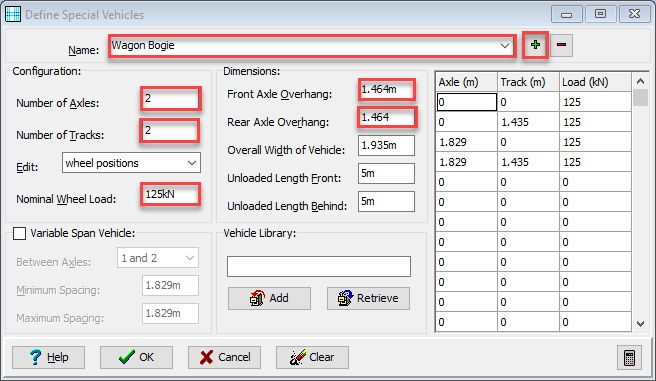

  4. Select the menu item Data | Define Special Vehicles... to open the Define Special Vehicles form.
  5. Click on the “+” button to add a new special vehicle and change the Name to “Wagon Bogie”.
  6. Set the Number of Axles and Number of Tracks to “2” and enter a value of “125kN” in the Nominal Wheel Load field. This will ensure that each of the 4 wheel loads has the same value, although different wheel loads can be entered directly in the Load column if required.
  7. In the Edit field select “axle spacing” from the drop down list.
  8. On the sub form that has opened enter a value of “1.829” on the second row of the table. This will ensure that the axle spacing in the bogie is 1.829 metres as per the vehicle load diagram.

  10. In the Edit field select “track spacing” from the drop down list.
  11. On the sub form that has opened enter a value of “1.435” on the second row of the table. This will ensure that the track spacing in the bogie is 1.435 metres as per the standard track spacing.

  13. In this example the default value of “1.935m” for the Overall Width of Vehicle will be used. Note that the program automatically alters this default value when the value of the track spacing is set.

  14. Select “wheel positions” in the Edit field and click “Yes” on the confirm form.
    Wheels
    The 4 wheels in the bogie have been defined and are represented by green circles on the graphics window. Note that as an alternative the wheels could be defined by clicking in the graphics window at the locations where the blue construction lines intersect.
  15. Set the Front Axle Overhang and Rear Axle Overhang fields to “1.464m”. This would ensure that the appropriate swept path allowance would be set correctly if the convoy were to be considered in the Load Optimisation process.

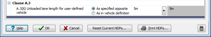

    In this example we will use the default value of “5m” for the Unloaded Length Front and Unloaded Length Back fields. This will ensure that no load is applied to the structure over that length immediately in front of, or behind, each bogie/vehicle. It is worth noting that, as an alternative, the unloaded length can be set in the EN1991-2 tab of the Nationally Determined Parameters form. Toggling between the 2 radio buttons at the bottom of the form determines whether the unloaded length value is set by the value on the NDP form or the Define Special Vehicles form. However, the unloaded lane length only effects road vehicles and hence it is not directly relevant to the rail loads specified in this example.
  16. The Define Special Vehicles form will now be as shown below.
  17. Click ✓ OK to close the Define Special Vehicles form.

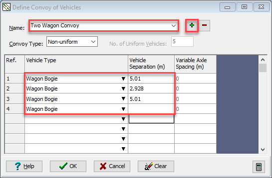

  18. In the main menu select Data | Define Convoy... to open the Define Convoy of Vehicles form.
  19. Click on the “+” button to add a new convoy and change the Name to “Two Wagon Convoy”.
  20. Set the Convoy Type to “Non-uniform”. This will enable bogies to be positioned at varying distances within the convoy.
  21. Set the Vehicle Type to “Wagon Bogie” in the top 4 rows of the table and enter the values shown below in the Vehicle Separation fields. These dimensions position the bogies along the length of the convoy as per the diagram in the introduction to this example.
  22. Click ✓ OK to close the form.
