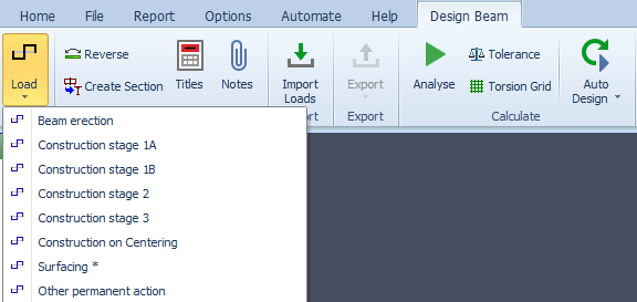

Next we will define erection of beam loads using the “Generate” facility to include two extra components; one for the temp 1kN/m and the other for the support loads (upwards).
  1. To add erection load effects, open the Define Pre-Tensioned Beam Loads form by selecting Load | Beam Erection in the menu bar.
    Load
  2. Click the Generate button and then click on “Yes” on the confirmation form that appears. The Generate Beam Loads form will now open.
