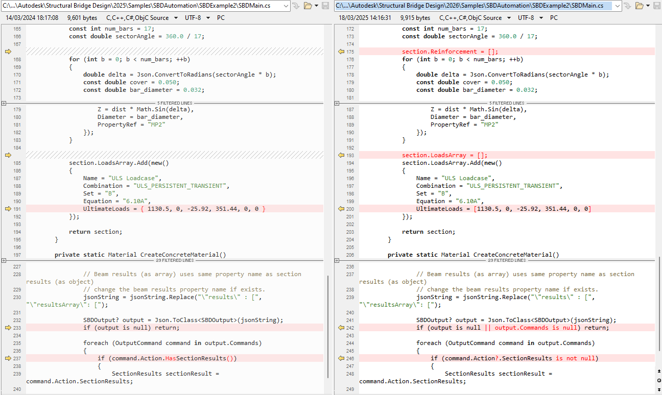

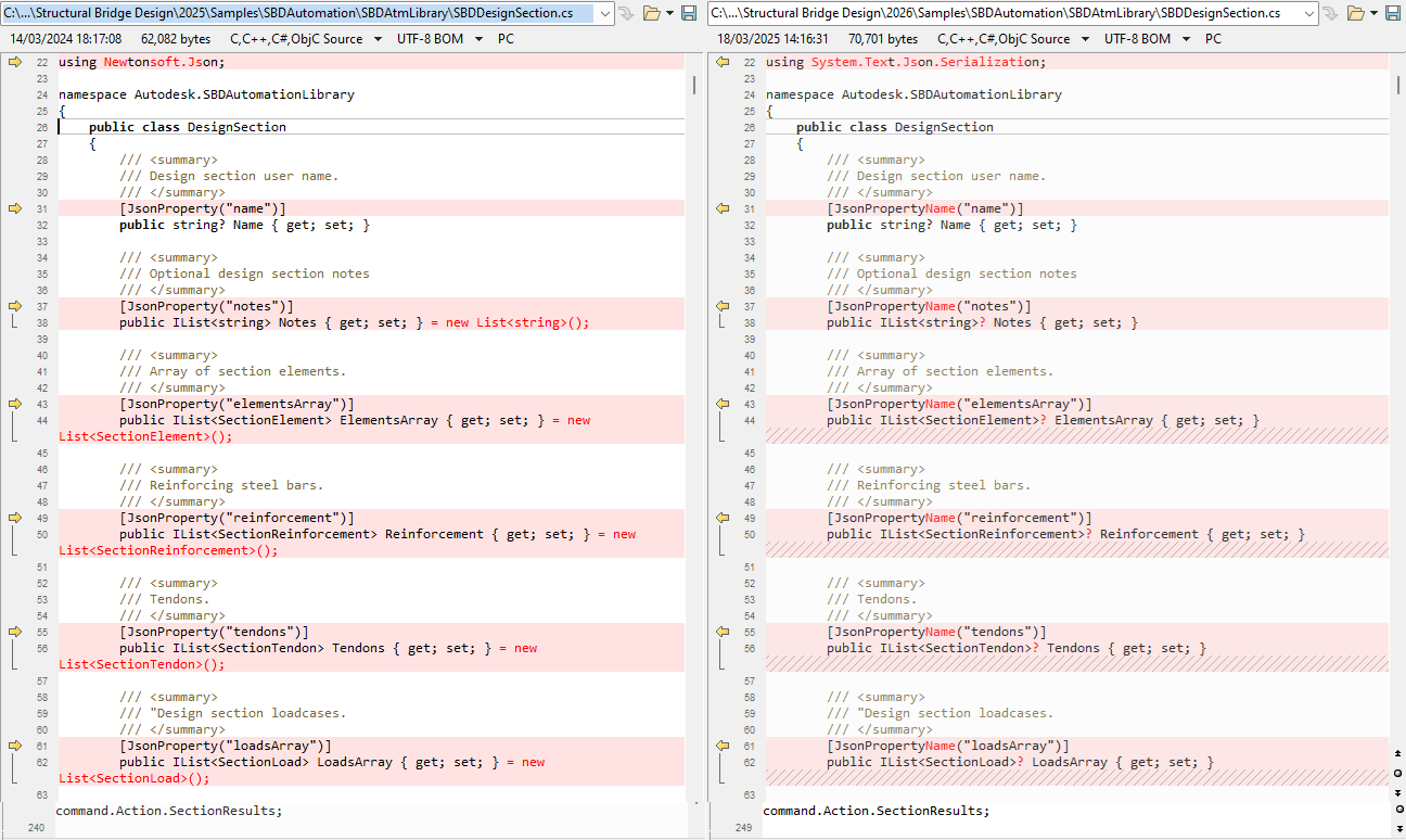

The Structural Bridge Design Automation solution SBDAutomationLibrary, a sample solution installed with the software that provides access to the design section and beam parameters, has been revised to migrate from using the Newtonsoft.Json package to System.Text.Json. Newtonsoft.Json was a popular choice before the introduction of System.Text.Json, but it's no longer the recommended approach for new development. Any user solutions utilizing these automation library classes may require code changes. The two example projects in the solution have been updated accordingly.
Many properties are no longer initialized in the base classes.

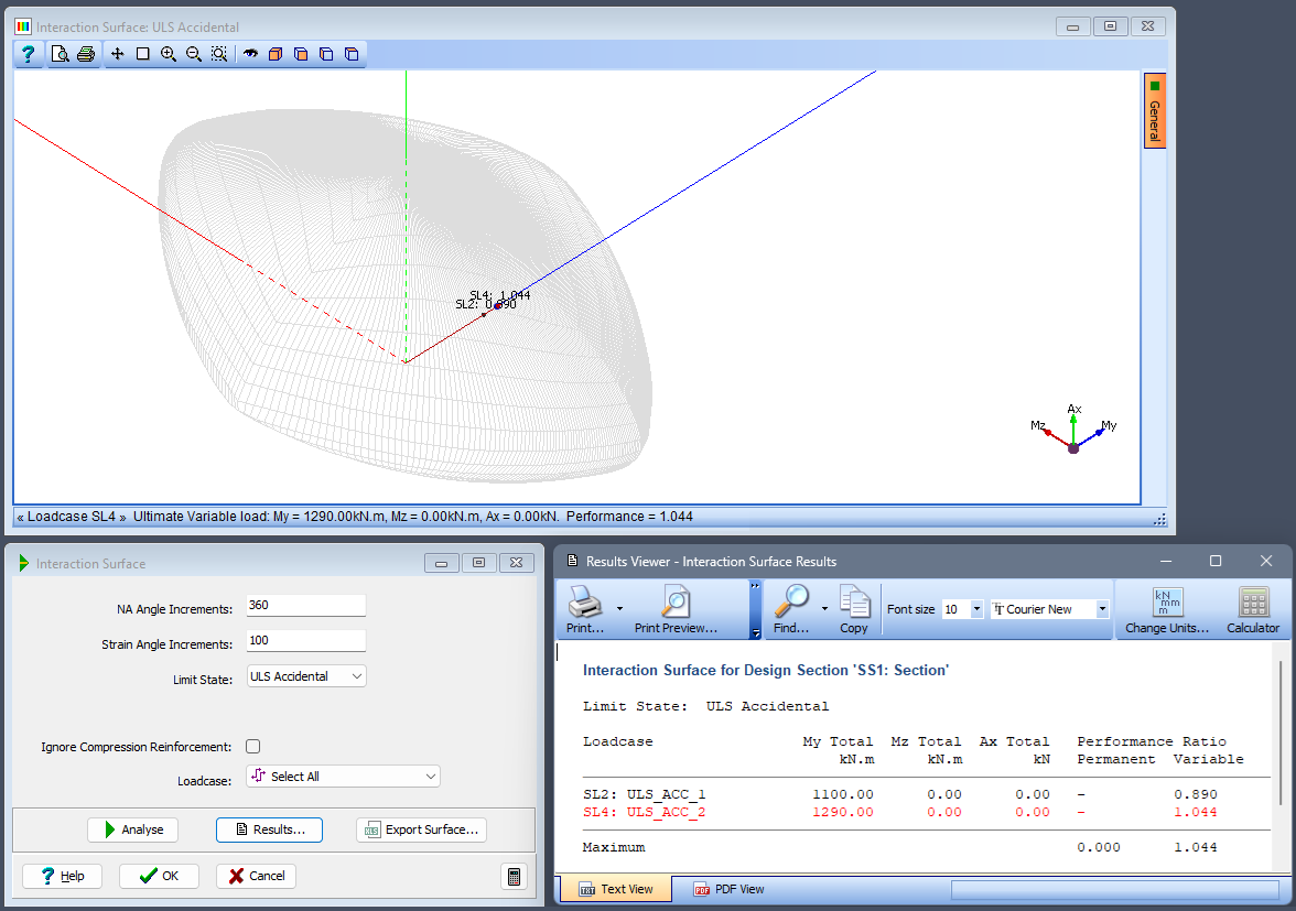

The Eurocodes ULS Accidental situation option has been added to interaction surfaces.
For automation, to Eurocodes for commandType of SECTION_ANA_SURFACE, there is now a need to add the boolean property isAccidental to
#/properties/control/properties/process/properties/commands/properties/commandArray/items/properties/analysisDetails.
If omitted, the ULS persistent/transient design situation will be assumed.
