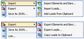

The ability to copy and paste a series of Design Section loads from a spreadsheet (via the clipboard) is restored.
