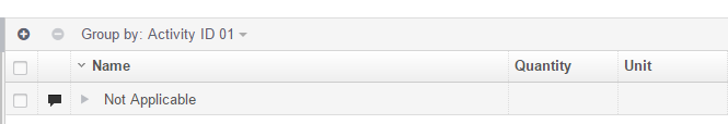

How do I Group Revit Categories?
Not all Revit categories share the same parameters. For example, "structural material" is a parameter of structural categories and is not a parameter for mechanical equipment.
This results in the need for additional grouping labels that Assemble designates as Not Assigned and Not Applicable.
