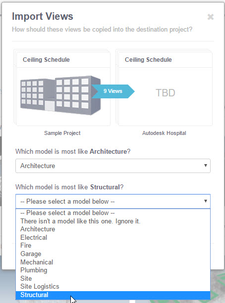

  1. From the Project Inventory page, select the Import View button.
  2. Scroll through or search for the project containing the view(s) to be copied over to the current project, and click Next.
  3. Click the check box next to each view from each model that should be imported, and then click Next.
  4. Finally, decide where the views should be categorized. From each drop-down option under the model name, select a suitable location to store the view within your current project's model discipline and/or type.
  5. After matching model destinations, click Import.
