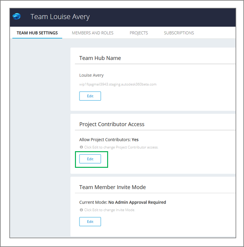

To change Project Contributor access
- On the Administrator Console, select Team Hub Settings > Edit in the Project Contributor Access section.
- Click the Toggle switch for Allow Project Contributors > Save.
