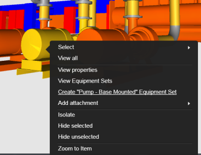

- With the BIM 360 add-ins, models from applications such as Revit, AutoCAD, and Navisworks are shared with BIM 360 Glue. In BIM 360 Glue, a Glue administrator creates equipment sets for the BIM model.

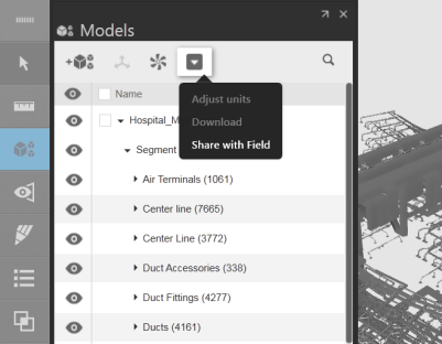

- In BIM 360 Glue, a Glue administrator shares the model with BIM 360 Field.

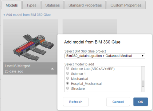

- In BIM 360 Field, a Field administrator adds the shared model to a Field project.

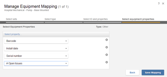

- In BIM 360 Field, the Field administrator starts the Manage Equipment Mapping wizard. This wizard associates equipment sets (created from model objects) with Field equipment object properties.
- As the last step of equipment mapping, add Field equipment properties to the model. After the equipment mapping is complete, you can view these properties in Glue, in the model's object properties.
