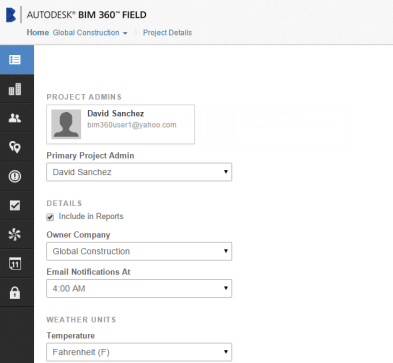

You can update BIM 360 Field project details, and set weather units for daily updates.
- To select a primary project administrator, select a name in the drop-down.
- To include details in all project reports, select the Include In Reports checkbox.
- To specify an owner company for the project, select a company in the drop-down.
Set the Time of the Daily Project Summary Email
By default, project members receive daily summary emails at 4:00 AM of the time zone set for the project.
- Click
- Under Details, for Email Notifications At, select a time and click Save.
Set Weather Units for Daily Updates
By default, weather units are set to imperial.
- Click
- Under Weather Units, select the units for Temperature, Distance, Wind Speed, and Precipitation, and then click Save.
