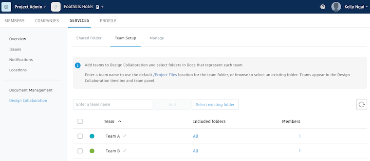

Before adding teams and managing team members, it's important to understand what happens between Design Collaboration and Document Management when a team is added. To do this, consider the following example in which two teams were added; Team A and Team B.
We see the two teams on the project timeline in Design Collaboration:

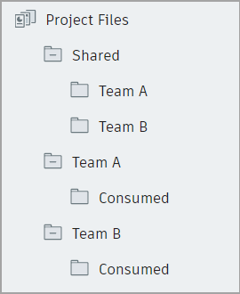

We also see new Shared and Consumed folders for the two teams in Document Management:
All of these folders are created when you add teams using Project Admin for Design Collaboration. The Shared folder and its sub-folders for each team represent the shared space for all teams. The Consumed folder and its parent team folder represent the Team Space for each individual team.
