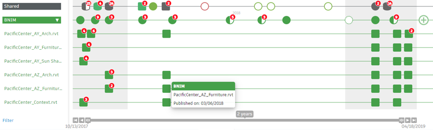

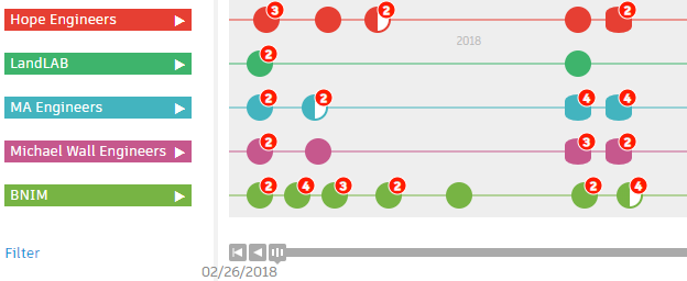

Your team’s packages are displayed on the bottom line. The Shared line is a collection of all the other teams’ packages.
Click the down arrow on the handle to expand the Shared line to view all teams in the project

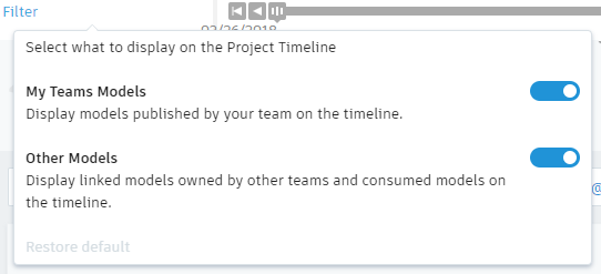

.By default, the timeline shows a combination of packages and models from your team as well as those shared by other teams. You can filter the timeline to hide linked models from your team or other teams. To do so:
