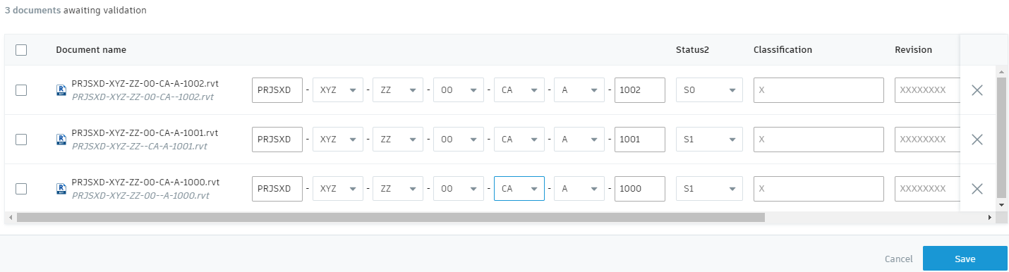

  3. Click the checkbox to the left of a document and click to delete the document if it is no longer needed.
  4. Click the checkbox to the left of a document and click Rename to begin editing the attributes that contain errors.
    Tip: Hover your cursor over the fields of the document name to see the attribute name.
  5. Click the icon to remove individual documents from the naming validator. These documents will still remain in the holding area.
  6. After editing the documents with errors, click Save to add the documents to your folder.
