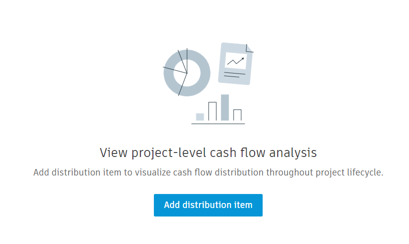

  1. Go to the Cash Flow subtab within the Forecast tab.
  2. If there are no distribution items created yet, you'll see Add distribution item there:
    Add distribution item button
    However, if there are existing items, the Add distribution item button shows at the top:
    Add distribution item button at top

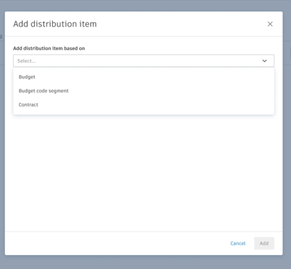

  3. Now you can choose what will be the base for a distribution item: Budget, Budget code segment, or Contract.
    Distribution window options
  4. Select distribution items and click Add.

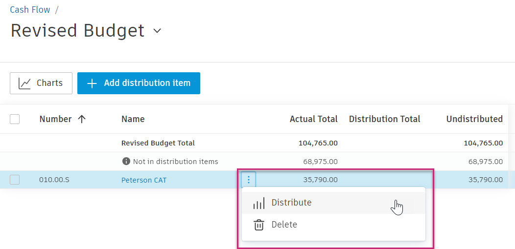

  2. Open the distribution item list view of Revised Budget or Forecast Final Cost. In our scenario, we clicked Revised Budget. The detailed view of Revised Budget opens. If project administrator allows budget forecasting, here you'll see Forecast Final Budget.
    Open distribution item list view
  3. You'll see the list of distribution items. Click the More menu More menu icon next to the one you want to create a distribution.
    Distribute option

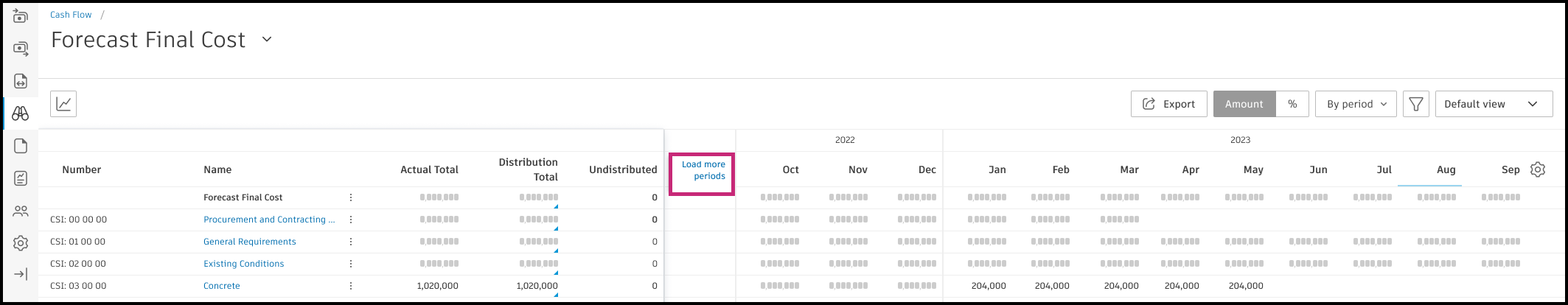

The distribution is created. You'll see the table with created distribution, divided into months and years, and you can load more periods when available.
Load more periods option

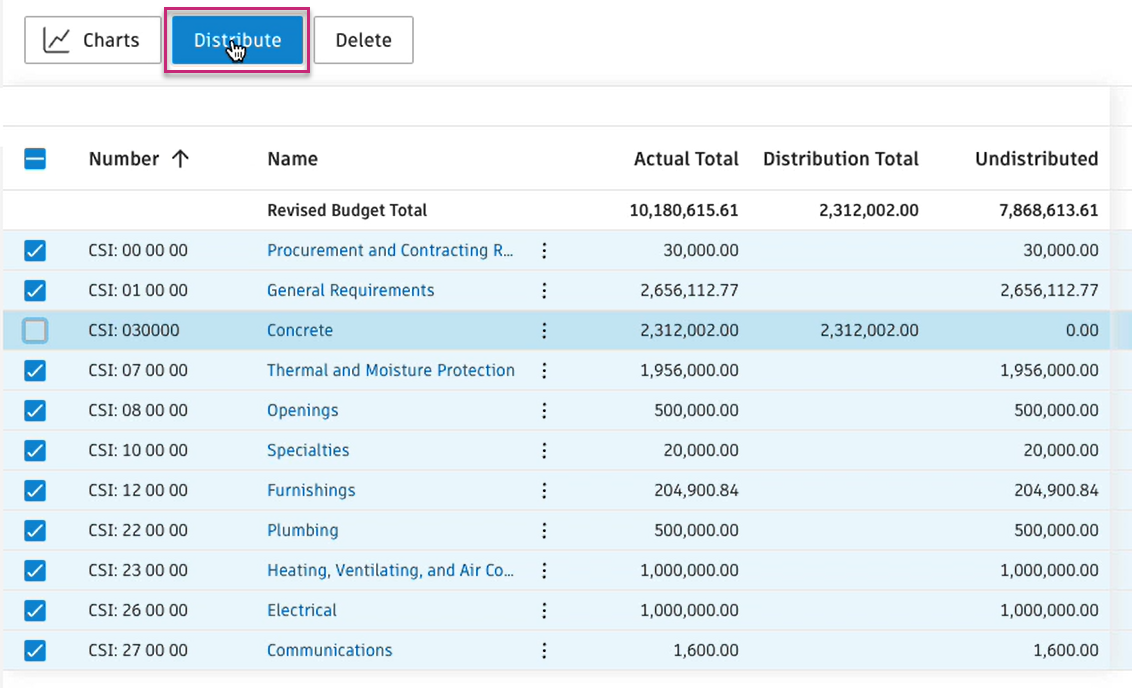

Create distribution from multiple distribution items
To create a distribution based on multiple distribution items, select the distribution items and click Distribute at the top of the page.
Multiple items distribution

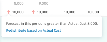

When you have actual costs: If the value of a specific period on the Forecast Final Cost (or Forecast Final Budget) curve doesn't match the corresponding period on the Actual Cost curve, an indicator will appear in the distribution item list view.
Forecast adjustments indicator

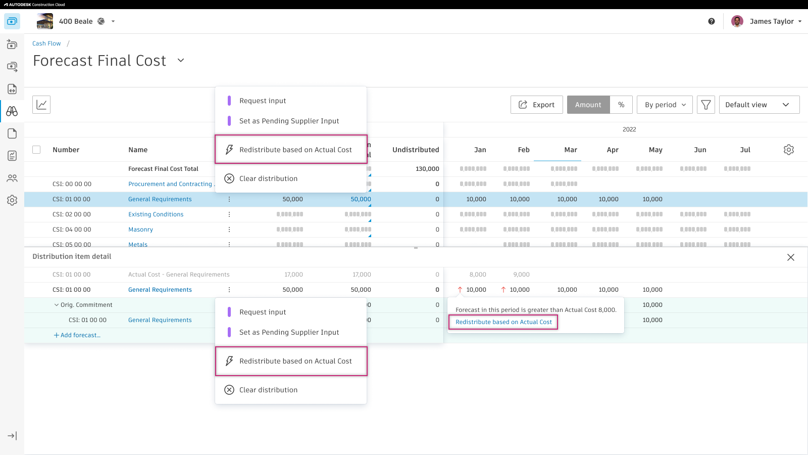

Starting redistribution: Select Redistribute from the context menu to open the redistribution dialog.
Redistribute based on actual cost

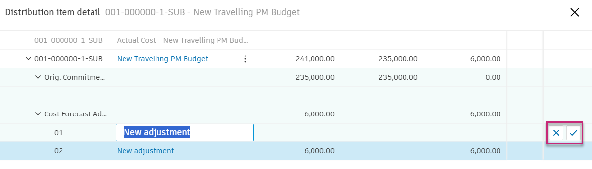

Create Forecast Adjustments
Apart from automated forecast adjustments you can also create adjustments manually.

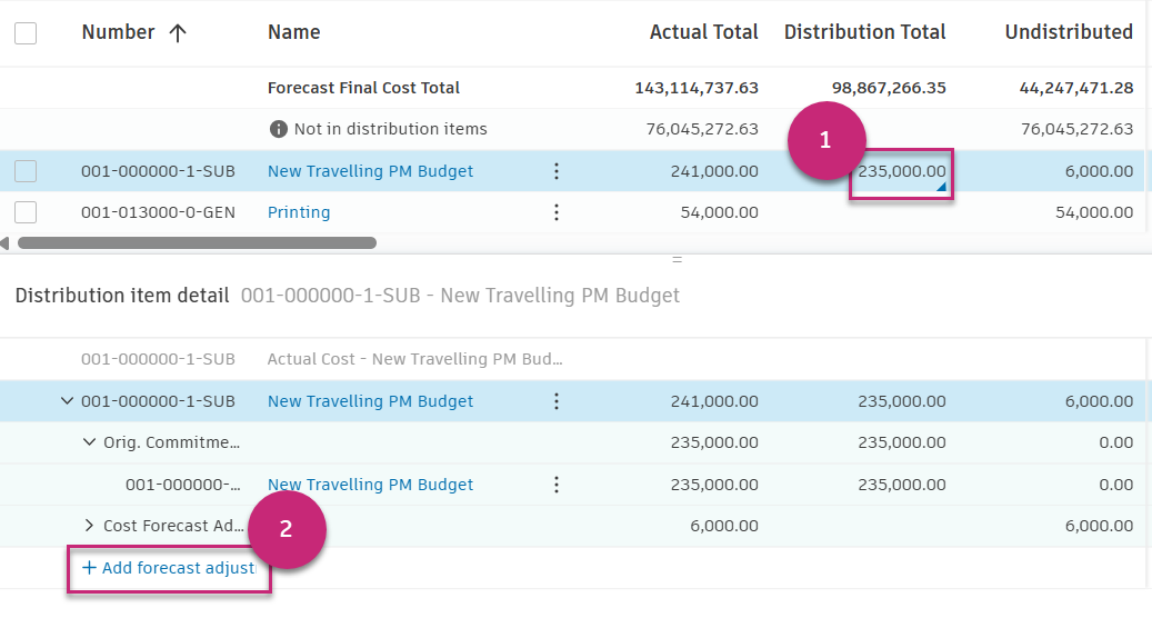

In our scenario, we're adjusting Forecast Final Cost to New Traveling PM Budget. To do so:
  1. Click the blue triangle in the Distribution Total.
  2. Choose Add forecast adjustment in the flyout panel.
    Add forecast adjustments workflow
  3. In the new window, choose a budget to add forecast adjustment to.
  4. Click Add.
  5. Name the new adjustment and approve it.
    Approve forecast adjustment
Now, open the distribution item detail view of New Traveling PM Budget and edit values in relevant periods.
You can add forecast adjustments in the same way in Revised Budget (or Forecast Final Budget, when budget forecasting is on) and Forecast Final Cost.

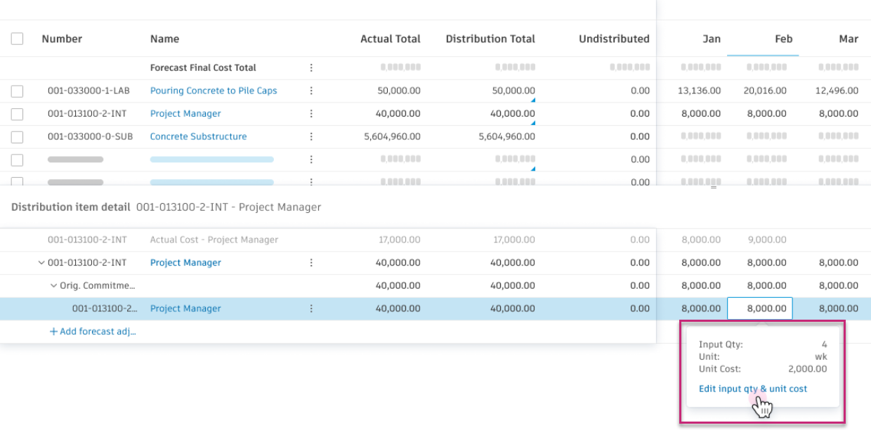

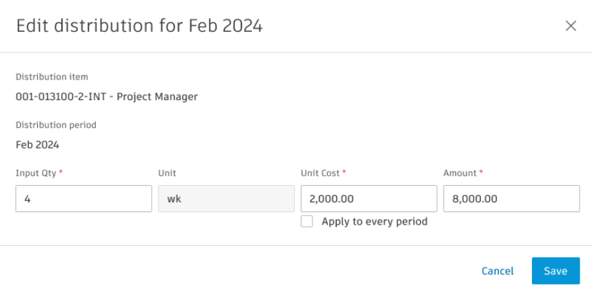

Quantity Distribution
Use Quantity Distribution to track your cash flow with quantities and units (hours, days, weeks) alongside dollar amounts. This helps you manage labor budgets and time-based work by showing both the amount of work and when it will happen.
Example Scenario: When you create budgets using quantities and unit costs (for example, 100 hours × $50/hour = $5,000), the system only tracks the total dollar amount ($5,000) and loses the original quantity information (100 hours).
The Solution: Quantity distribution preserves both the dollar amounts and the original quantities, allowing you to:
Viewing quantity distribution
To work with quantity distribution, open distribution item list view:
Distribution item list view
Then you can:

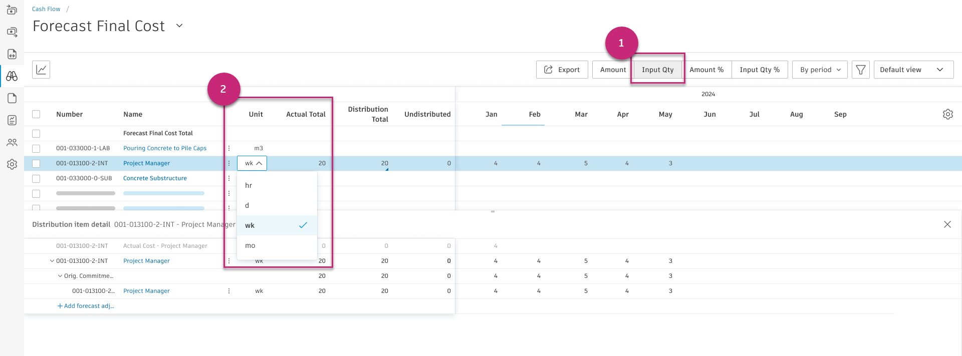

  1. Toggle views: Switch between "Amount" and "Input Qty" views using the toggle button.
    • Amount view: Shows dollar values and percentages.
    • Input Qty view: Shows quantities and percentages.
  2. Work with the Unit column: When in quantity view, you'll see a "Unit" column showing:
    • Budget items: The budget's original unit (hours, days, and more).
    • Segment/Contract items: Shows hours.
Input quantity distribution view
How quantity distribution works
This feature is most valuable for labor and other time-based work. Try to use consistent time units within similar types of work. Update both quantities and amounts as your project progresses. Pay attention to unit costs when adjusting to ensure they remain realistic.
Key features:
Note: If a budget doesn't have original quantity information and isn't time-based, the quantity distribution will show empty values. This is normal for lump-sum contracts or material budgets without unit breakdowns.
Default units and how to change them
The system automatically selects appropriate units:
For time-based distributions, you can switch between different time units: hr (hours), d (days), wk (weeks), mo (months).
The system automatically converts quantities when you change units (for example, 40 hours becomes 1 week).

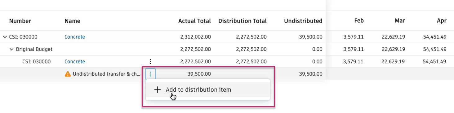

Update a Distribution
An Undistributed column advises of any differences between the amount in the budget view and the currently distributed. Selecting the More menu More menu icon next to the item with an orange triangle allows you to add in undistributed items for change orders or transfers, so they can be distributed separately from the original work.
Add to distribution item
After adding to the distribution item, you'll see the detailed view:
Undistributed items view

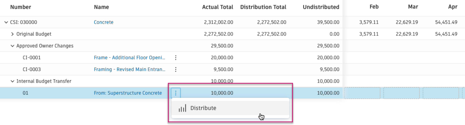

You can distribute those items using the predefined curves or manually.
Manual distribution

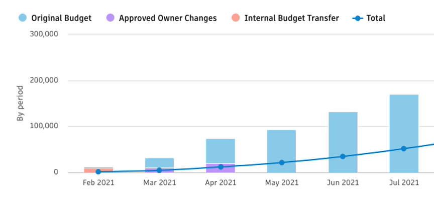

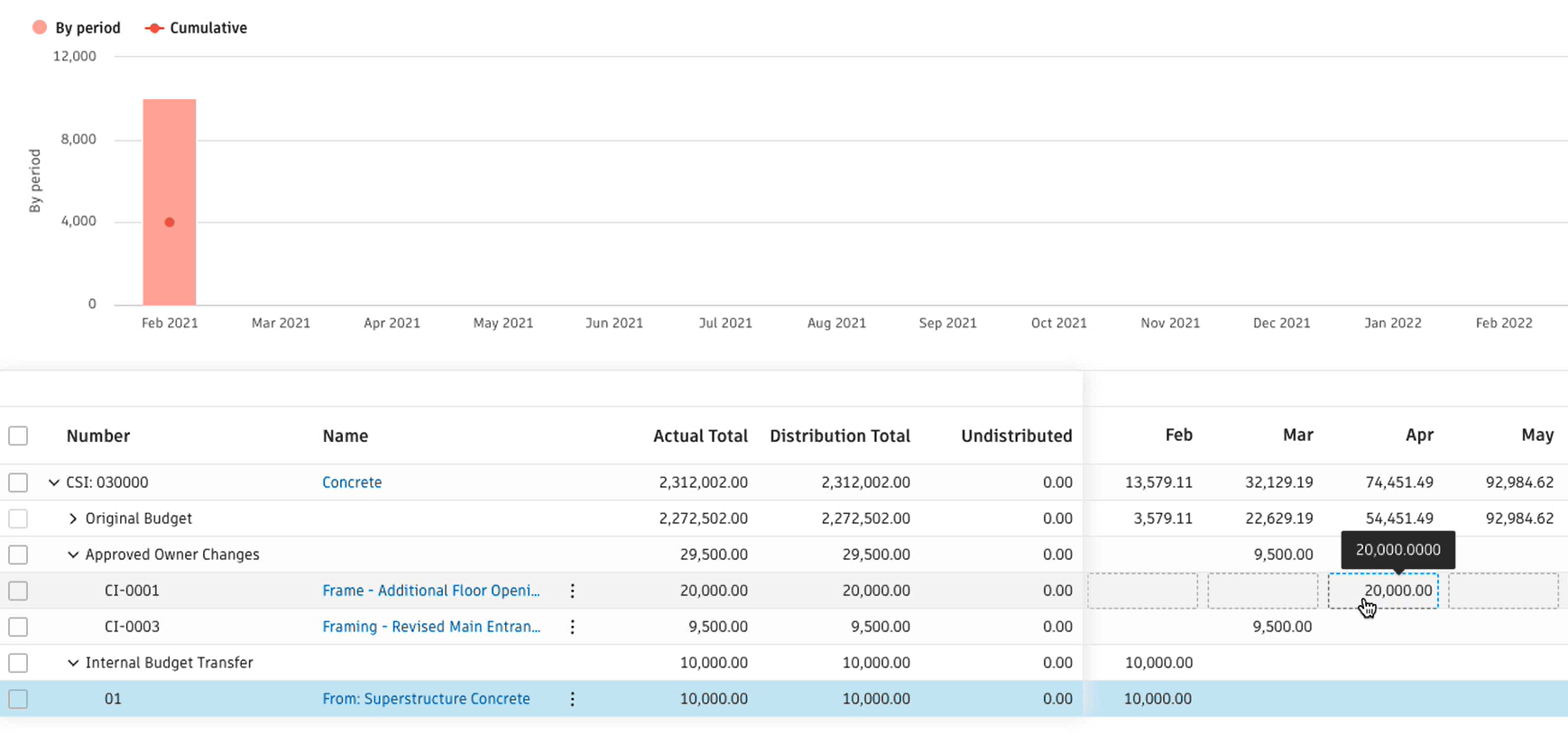

Approved Owner Changes and Internal Budget Transfer amounts are shown in a different color in the chart.
Different colors chart

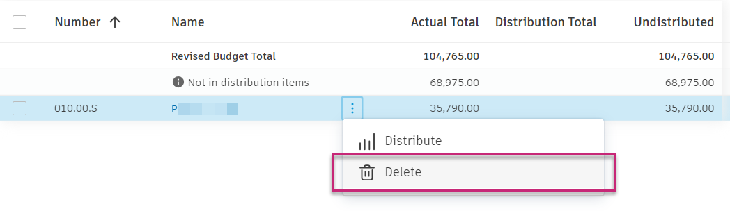

Delete a Distribution Item
To delete a distribution item, click the More menu More menu icon and then select Delete. To delete more than one distribution item, select boxes next to items you want to delete, and then click Delete.
Delete distribution item
In both cases, you'll be prompted to confirm the action.

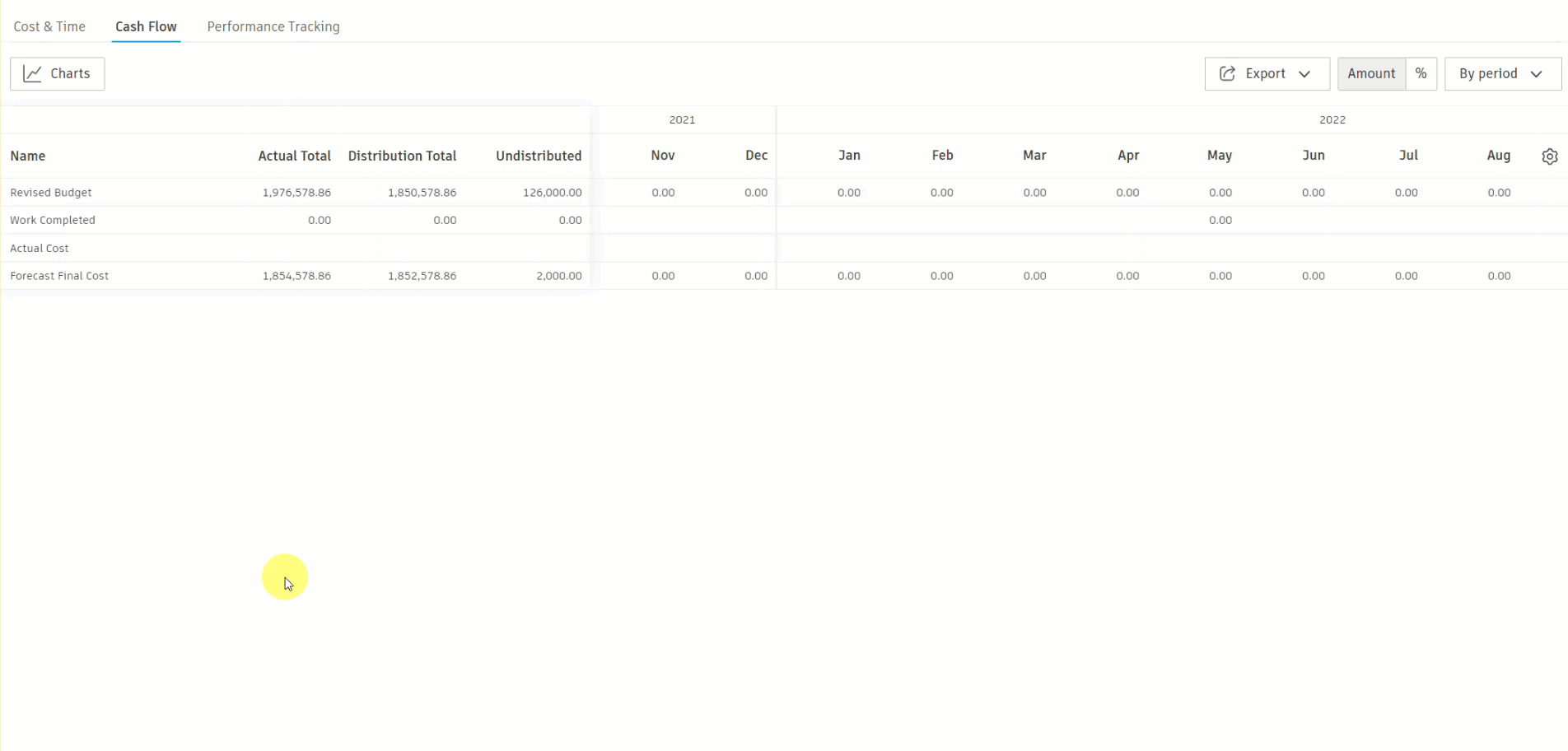

Teams can access a project-level cash flow analysis to easily visualize the cash flow distribution throughout the project lifecycle. This real-time summary enables teams to see planned actual and forecast quickly with all the details, when necessary. To access the Cash Flow table, open the Forecast tab.
To display the built-in dynamic time-versus-money chart, select the Chart icon icon. Then, you can:
Cash flow chart details
You can manipulate the Cash Flow table by using the Settings icon icon:
You can also see more details by selecting the Popout icon icon that appears in the table when hovering over a line:

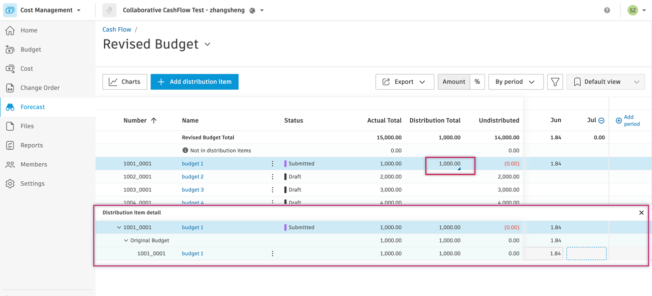

You can view and edit the details of a distribution item on the list, and also see the cash flow context of other distribution items, by displaying these details in a subtable.
To display distribution item details in a subtable in the list view:
  1. Select any Distribution Total that has a blue triangle indicator to expand the subtable.
    Cash flow consolidated view
  2. You can now edit the details of an item and see other items.
