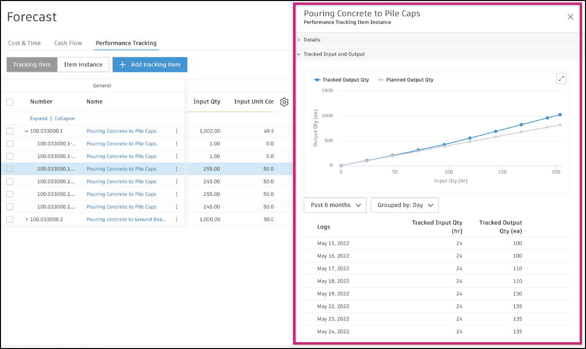

For more insights, open the flyout panel to view detailed logs and charts:
Performance tracking flyout panel with detailed logs and charts

Tip: You can see the details panel by clicking the instance item in the Performance Tracking table. In the Tracked Input and Output section, you can see the relationship between those values and decide to make forecast adjustments if necessary.
