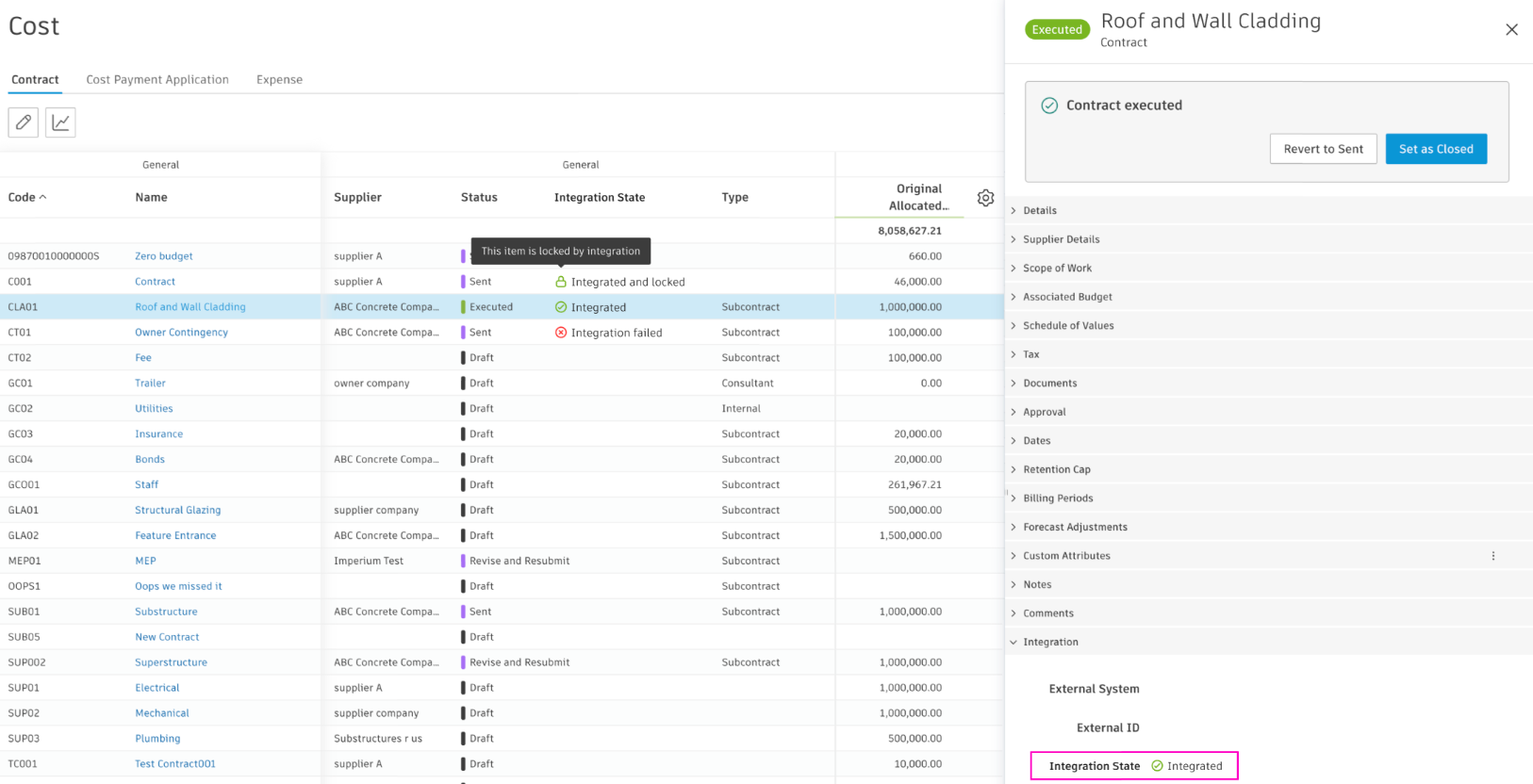

After the ERP system is integrated with Cost Management, account administrators can lock fields and actions to avoid inconsistency, unplanned changes in projects, and errors.
Since the ERP system is integrated with Cost Management, the
status will be visible in the:
You can change fields and actions to read-only mode for integrated and locked items. Review the table to see what can be locked. Use the search at the top of the table to narrow down the results.

You want to lock one of your contracts to prevent unscheduled changes. You can do this with ERP integration. Request an ERP system vendor to enable the lock.
Review the table to see which fields and actions are locked. In detail:
By adding the Integration State column to the Budget, Cost, and Change Order tabs’ table views, you can see which of the items, sections, and actions are locked and integrated.

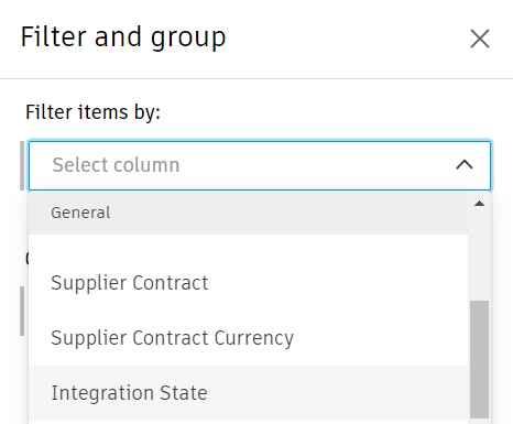

You can also filter the table view by the status of the integration:
