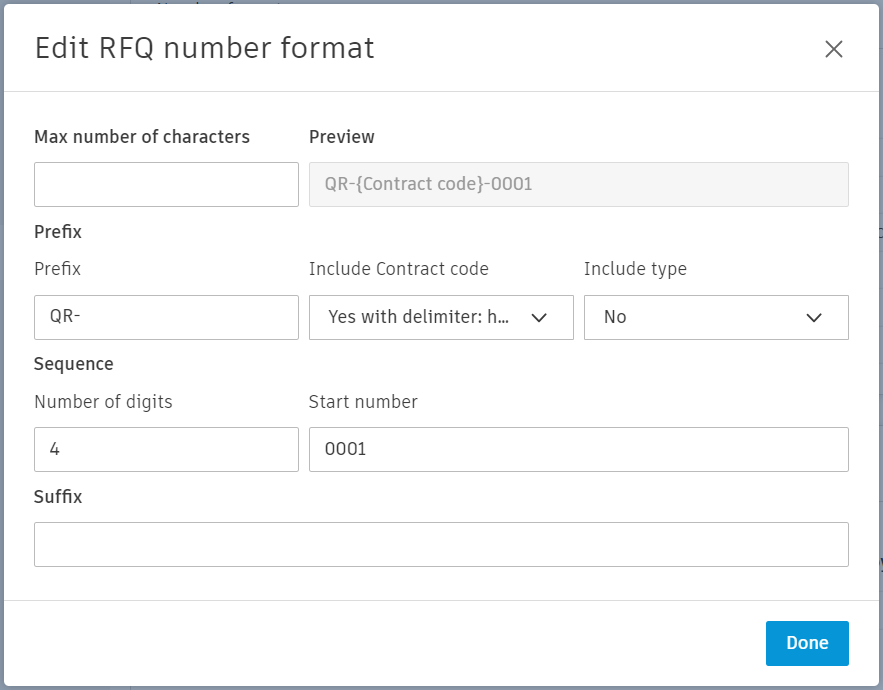

Number Format
Change the number format that is generated when you create change orders and cost items.
  1. Click Module Selector Module selector icon Menu arrow icon Project Admin module icon.
  2. Select the Services tab.
  3. Select Cost Management in the left panel.
  4. Switch to the Change Order tab.
  5. Expand the Number Format section.
  6. Select the More menu More menu icon for the number format that you would like to define.
You can define:
Edit RFQ number format dialog showing fields for max characters, prefix, digits, starting number, and suffix

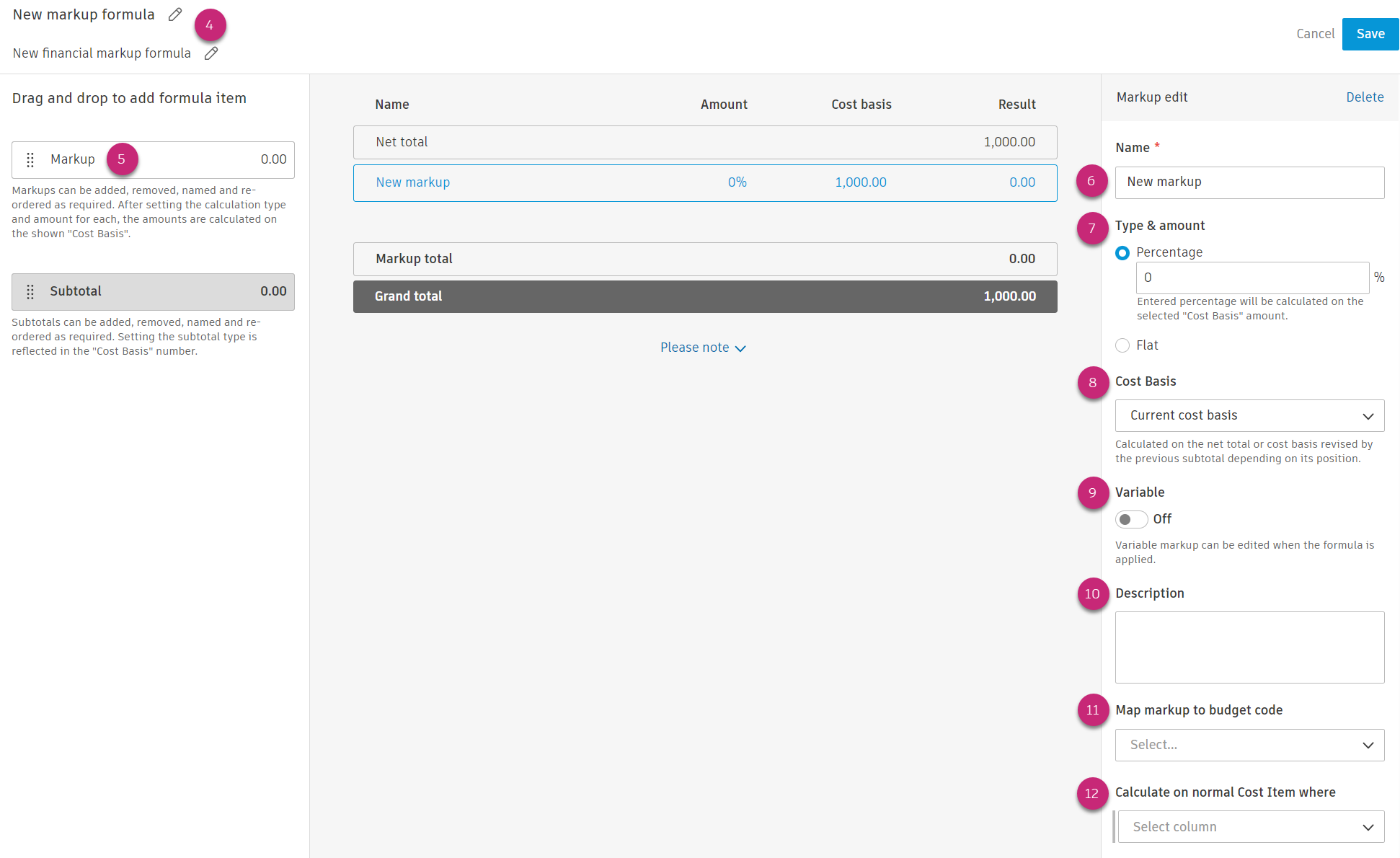

Financial Markup Formulas
Financial markups can be added to change orders. An example of a financial markup is an add-on such as a bond, contingency, or fee. These financial markups can be added to the change order for submission to the owner. See the Potential Change Order article to see an example of how to apply a financial markup.
Before you can apply a financial markup, a project administrator must create the financial markup formula in the Change Order settings tab.
Create a Financial Markup for a Change Order
As a project administrator, you need to create a financial markup formula:
  5. Click Add in the Financial Markup Formulas section.
  6. Name the new financial markup formula. You can also add an optional description by clicking the pencil icon.
  7. Click Markup from the left panel to add it to the formula.
  8. In the editor on the right, enter the name of the new markup.
  9. Select the markup type and amount. Available options include:
    • Percentage: Calculates the markup as a percentage of the cost basis.
    • Flat: A fixed amount applied as a total for the markup at the PCO level.
  10. Select the cost basis for the markup. Only available on percentage-based markups.
    • Current Cost Basis: Multiplies the percentage and the cost.
    • Net Total: Multiplies the net total amount.
    • Revised Cost Basis: Multiplies the following subtotal and percentage.
    • Preceding Markup Subtotal: Equals the total of all preceding markup above the selected markup, excluding the net total.
    • Grand Total: Multiplies the calculated grand total and the percentage.
    • Preceding Total: Calculated on the total of net total and all preceding markups.
  11. Toggle whether the variable can be edited when the formula is applied.
  12. Provide an optional description of the markup.
  13. By default, markups are calculated on all budget items. Click the Map Markup to Budget Code drop-down list to make a markup only apply to a specific budget code.
  14. Click Calculate on normal Cost Item where to select a column, operator, and value combination to apply the markup to. By default, markups are calculated on all budget items.
Financial markup formula configuration interface showing markup settings, cost basis options, and formula builder

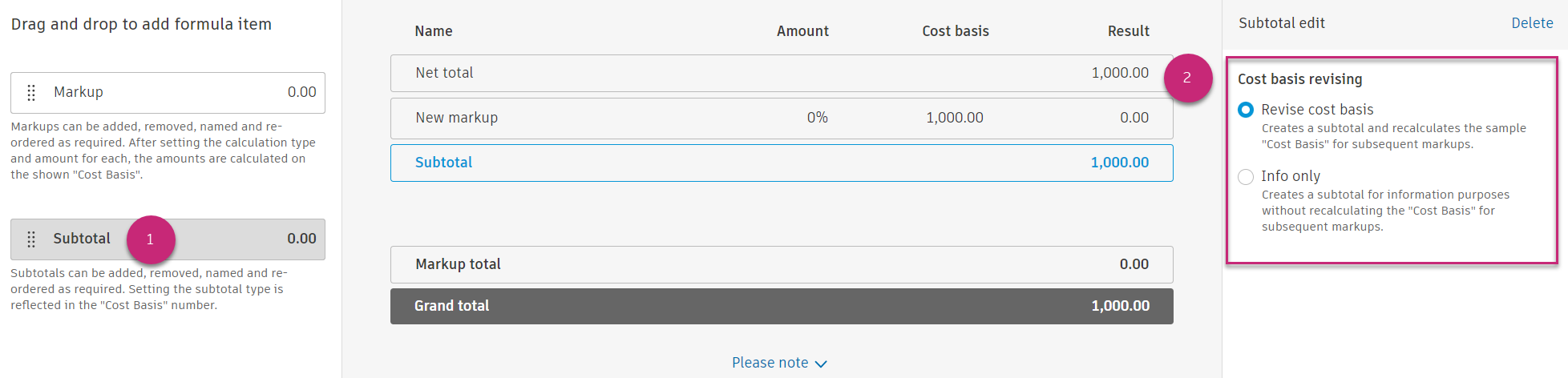

To add a subtotal to your financial markup formula:
  1. Click Subtotal from the left panel.
  2. Select the appropriate cost basis revision. Available options include Revise Cost Basis or Info Only:
    • Revise Cost Basis creates a subtotal and recalculates the sample cost basis for subsequent markups.
    • Info Only creates a subtotal for informational purposes but does not recalculate the cost basis for subsequent markups.
Subtotal setting options showing Revise Cost Basis and Info Only radio button choices
You can add more markups or subtotals as required. After everything is ready, click Save.
Note: Calculation rules might restrict markups to cost items with specific budget codes. As a result, sample cost basis data may not reflect the actual calculation results and is provided solely for verifying the formula.
After you created financial markup formula, you can decide where to use it in Cost Management. Choose between two options:

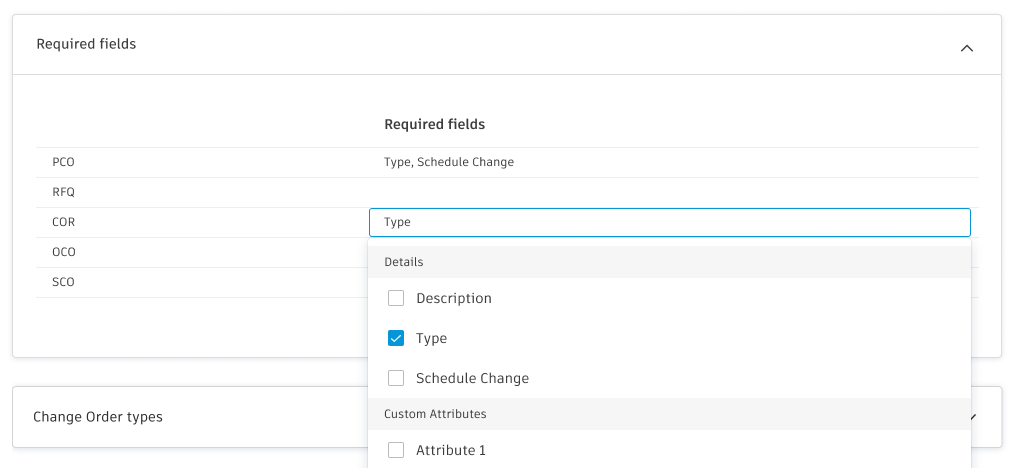

Required Fields for Change Orders
Project administrators can define a set of fields as required. This setting may be helpful when working with the change order workflow to prevent missing important information. To do so:
  1. Open Services, and then Cost Management from the left navigation.
  2. Switch to the Change Order tab.
  3. Scroll down to Required Fields.
  4. Select the drop-down list next to the change order.
  5. Choose the required fields for change orders. Custom attributes are also shown on the list.
Required fields for change orders configuration showing dropdown selection of mandatory fields

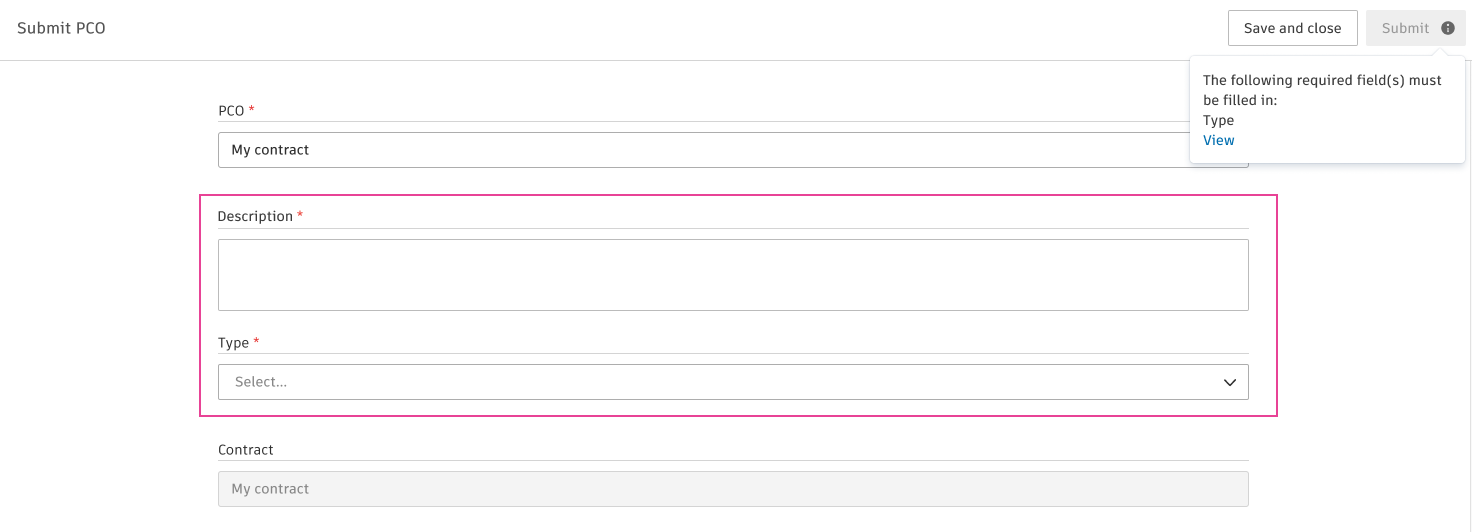

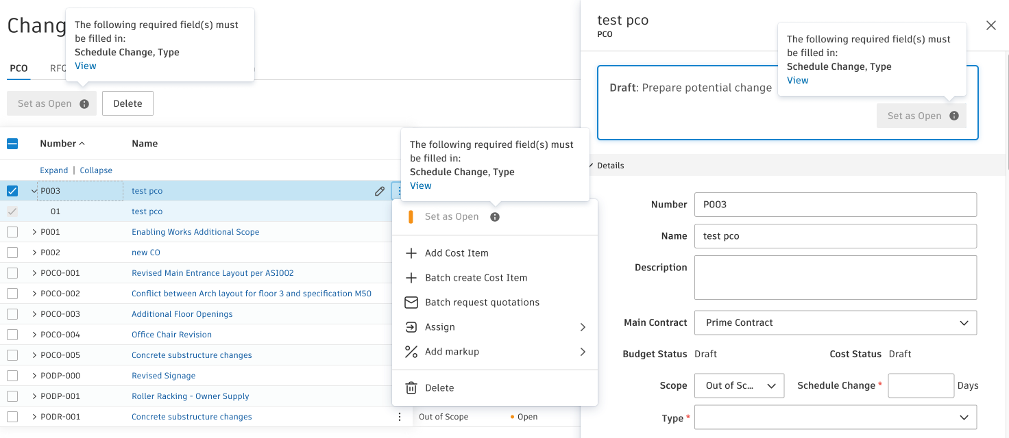

Required fields apply to all existing instances and to the ones that will be created in the future.
After setting it up, when changing the status of a change order, those fields are marked as obligatory and must be filled in to proceed with the change order workflow. By clicking View, you'll be redirected to the missing data.
Required fields validation message showing missing mandatory fields with View button to redirect to missing data
Members with collaborative access also see the required fields when submitting an RFQ (Request for Quotation). See the Collaborative Potential Change Order Workflow article to learn how to collaborate with suppliers in Cost Management.
Required fields in collaborative workflow showing mandatory field validation for supplier RFQ submission

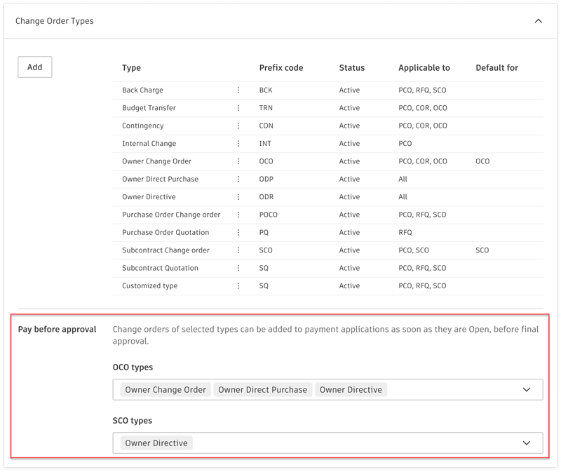

Change Order Types
Change order types can be used to filter your budget and contract tables and be part of your change order codes. You can deactivate the default types or add your own.
To add change order types:
  1. Select the Change Order tab from Services.
  2. Expand the Change Order Types section.
  3. Click Add.
  4. Enter the type name.
  5. Enter a description.
  6. Choose which change order module a type applies to. When you open the change order's flyout panel, you'll see this information displayed in the Type field as an option to choose for a particular change order.
    Change order type filtered list showing type options in dropdown menu
  7. Select whether a specific change order type should be set as the default option for a given change order. If a type is designated as the default for a change order, it will remain selected in the Applicable to section.
    Default change order type configuration showing checkbox options for setting default types
Select the More menu More menu icon to deactivate undesired default types.
Change Order Pay Before Approval
Administrators can select any OCO/SCO change order types to be manually added to Budget and Cost Payment Applications before these orders are approved. This allows the value of the change order to be edited between payment applications.
To add change order types that can be included in payment applications when they have at least Open status, before final approval:
  3. Go to Pay before approval.
  4. Select the desired OCO and SCO types from the drop-down menu.
    Pay before approval settings showing OCO and SCO type selection dropdowns
Tip: Learn how to add change orders in Budget Payment Application or Cost Payment Application.
