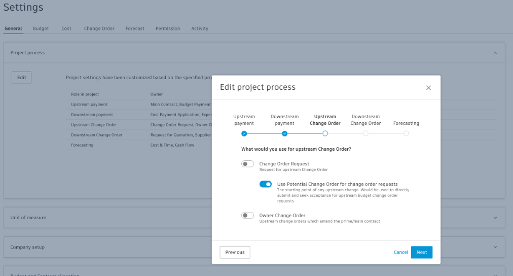

Project Process
This optional project process setting supports a straightforward setup process for different members. Based on the selected role and project preferences, you can configure which components display in Cost Management and apply appropriate permissions.
Project Process Setting
By using project process settings, the option to enable a collaborative Potential Change Order workflow is available. For more details on collaborative workflows and their impact on PCOs, see the Collaborative Potential Change Order Workflow article.
Owner Role Behavior with Cost Change Workflow
When the primary user is assigned the Owner role in the project process setting, the system automatically applies specific behavior changes to optimize the cost change workflow:
This automatic configuration maintains proper cost control and workflow alignment when projects are managed from an owner's perspective. For more information about owner workflows, see the Collaborate with Others in Cost Management article.
Caution: Keep only one contract per a potential change order. More contracts in a PCO will generate an error.
Collaborative Potential Change Order (PCO) Workflow
The optional collaborative workflow for PCOs allows you to:
See the Collaborative Potential Change Order Workflow article to learn more.
Note: When "PCO as RFQ" is enabled, one PCO can only be associated with one contract for collaborative access to work.
Important: The collaborative PCO workflow can't be turned on for projects with existing change orders. A subscription to Autodesk Build is required to participate in the workflow. See Autodesk Build Pricing to learn more.
Simplified Change Order Process
The simplified change order process lets you generate OCOs and SCOs directly in their final status (Approved for OCOs, Sent for SCOs), bypassing intermediate statuses and approval workflows. This streamlines workflows for teams that don't need multi-step review processes.
The available options and defaults depend on your company's role in the project:
See the Simplified Change Order Process article to learn more.

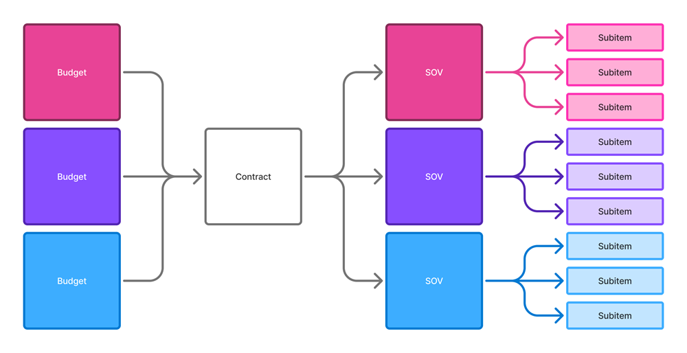

Budget and Contract Allocation
Members can add multiple budgets to a single contract by default. Here is the diagram that demonstrates the relationship between budget and contract allocations when this option is chosen:
Multiple Budgets to One Contract
Note:
For all diagrams presented in this section of the article:
  • Darker colors indicate items that are directly linked to the budget.
  • Lighter colors represent subitems of those directly linked items.
  • No background color means that there is no direct relationship with the budget.
Clicking Assign the same budget to multiple SOV items when the option of Multiple budgets to one contract is on helps organizing your budget and contract items differently but still connected. It allows multiple contract items to link to the same budget item:

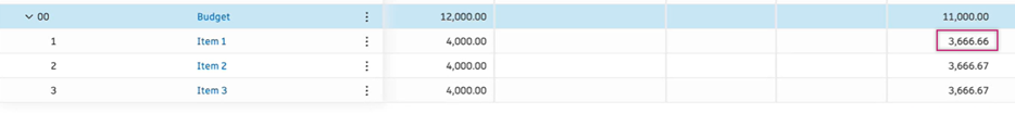

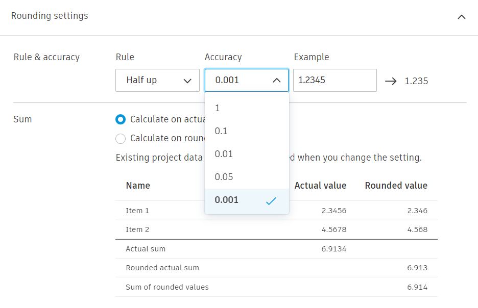

Rounding Settings
Use the rounding settings to control how numbers display in Cost Management. You can customize rounding separately for Currency, Number, and Percentage formats to match your project needs.
What each format controls?
Format Applies To
Currency
  • Custom columns formatted as Currency
  • All Unit Cost and Amount system columns
Number
  • Custom columns formatted as Number
  • All Qty (Quantity), Rate, and Ratio system columns
  • Number-type custom attributes
Percentage
  • Custom columns formatted as Percentage
  • All percentage values in the system
Rounding settings include three controls:
Rule: How numbers are rounded.
Accuracy: How many decimal places to show (examples: 0.01 shows two decimals, 0.001 shows three decimals).
Sum (for Currency and Number only): How totals are calculated.
Note: Percentage format does not have a sum rule—percentages are always calculated on actual values then rounded.
When choosing Calculate on rounded values for Currency or Number:
Automated rounding example
Important:
Existing project data won't be recalculated when you change the setting.
Default settings apply the same rounding rules to Currency, Number, and Percentage formats. You can customize each format separately as needed.

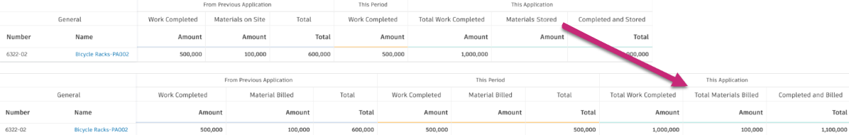

Materials in Payment Applications
Cost Management currently follows the AIA G703 standard, providing a binary material tracking approach. According to this standard, materials are either considered as work completed or presently stored. If a material has been fixed in place, it is classified as work completed and placed in the column: This Period – Work Completed. On the other hand, if the material has been delivered to the site and stored, it remains in the column: This Application – Total Work Completed. This Period category accumulates materials delivered over multiple months and should only be moved to Work Completed when it is completed and put in place.
However, we also recognize that some owners prefer to view the previous period's materials as previously billed rather than previously completed. They expect to see that the full payment amount is reflected in the From Previous Application section. To address this requirement, we have introduced an option that allows the combination of work completed and materials, treating them as a unified work completed value for the next period.
With the Materials in Payment Applications setting, you can choose a method to calculate materials in This Application in budget and cost payment applications.
Important: This setting cannot be changed once any payment application is created.
To do so:
  1. Click Module Selector Module Selector Icon Arrow Icon Project Admin Option Button.
  2. Go to Services, then click Cost Management.
  3. In the General tab, scroll down to the Materials in payment applications.
  4. Choose a method to calculate materials:
    • Materials Stored – Includes materials newly stored in the current period and previously stored materials not yet incorporated into the project.
    • Materials Billed – Includes both materials to be billed in the current period and materials previously billed. If Materials Billed is selected, a whole new set of columns will be added to both budget and cost payment applications, replacing the original Materials Stored columns.
Switch between options to see the difference in the payment applications' columns.
Materials billed

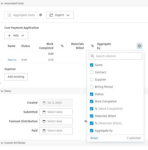

The change in setting will also be visible in the flyout panel of the budget payment application, in the Associated Costs section. The Materials Stored column changes to Materials Billed, and the new % column is added. You can also see the change in the Expense category in Associated Costs. If not visible, to see the new columns there, click the Gear icon icon and choose the necessary columns.
Associated costs
Tip: You can choose if Work Completed and Materials Billed should be aggregated by the amount or %. When aggregating costs by %, Work Completed and Materials Billed will be aggregated by their %. Materials Stored column will always be aggregated by amount.

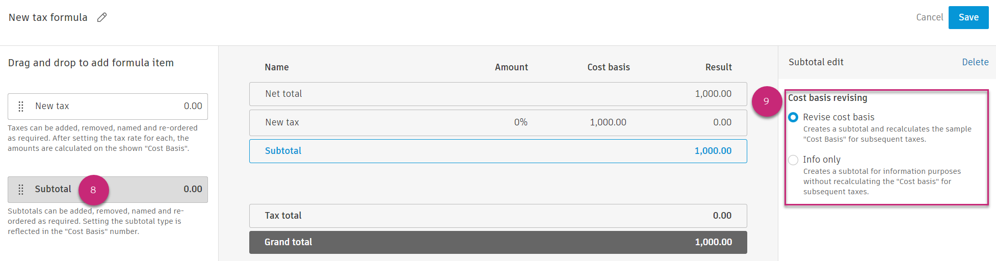

  5. To update the net total default (1,000.00) in the center preview panel, click Net Total.
  6. Drag a new tax into the center column to add to the formula.
    Add new tax
  7. Click newly added New Tax to specify the Tax Rate as a percentage. The tax rate can be positive or negative. Negative tax rates are useful for figuring out CIS deductions.
    Edit new tax
    Important: If taxes in different tax formulas have the same name, they'll be combined into a single tax in the tax summary regardless of the tax rate.
  8. Continue adding more taxes as needed to build out your formula. As you add taxes, the tax total is calculated based on the tax rate and the net total. Combined, these values produce the grand total. Taxes can be added, removed, named, and reordered as required. After setting the tax rate for each, the amounts are calculated on the Cost Basis column.
    Note: You can add a taxable base limit. This limit determines the maximum amount of income that can be subject to taxation within a specific period.
  9. Drag a new subtotal into the center column to add to the formula. The subtotal is used to support a tax-on-tax use case.
  10. On the right panel, you can choose between two options:
    • Revise Cost Basis to recalculate the cost basis for subsequent taxes.
    • Info Only to have the subtotal visible for informational purposes without recalculating the cost basis for subsequent taxes.
    New subtotal
    Note: If there are multiple taxes above the subtotal, the subtotal will display both the tax subtotal and the subtotal.
  11. Click Save to save the tax formula.

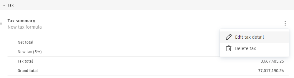

Apply a Tax
As a project administrator, you can add tax formulas, a tax summary, or apply a tax to the document for easy calculation in all costing processes. Showing the tax in the generated cost documentation helps to comply with government requirements too.
To apply a tax:
  1. Click the relevant Budget, Cost, or Change Order tab from the left navigation, depending on where you are applying the tax.
    Note: Make sure you added your tax formulas in advance. See the Create a Tax Formula section to learn more about adding tax formulas.
  2. Click the relevant tab. Available options are:
    • Contract
    • Cost Payment Application
    • Main Contract
    • Budget Payment Application
    • OCO
    • SCO

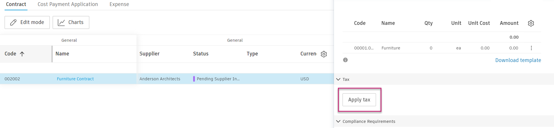

  3. Click a line item's name to open the details panel.
  4. In the details panel on the right, scroll to the Tax section and click Apply Tax. If you only have one tax formula available, that formula is applied to the expense. If you have multiple tax formulas, select the formula to apply.
    Apply a tax details panel
    The applied tax is visible in the tax summary for the line item.
    Tax summary details

    If you levy a tax on a sent or executed SCO, it will be displayed under the contract tax. You'll be able to see the net total and tax total for all change order taxes that are related to the contract. You can expand to see more detailed information, including specific change orders that affect contract tax.
  5. If necessary, use the More menu Vertical more menu icon and choose Edit Tax Detail or Delete Tax.
    Cost tax more menu
    Editing the tax details allows you to turn on or off specific taxes as needed. The change is automatically updated in the Tax summary table.

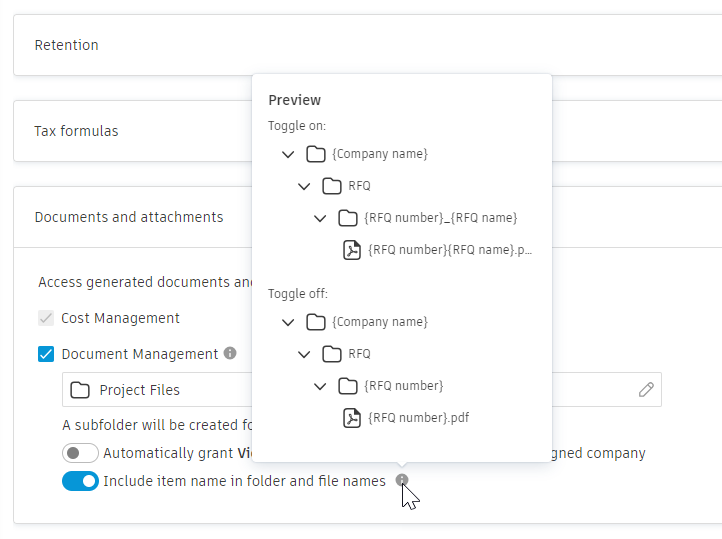

Documents and Attachments in Cost Management
You can choose to store documents and attachments in both Cost Management and a specified location in Document Management.
By choosing the Document Management option, documents and attachments will be stored in a subfolder created for each company. Members must have the appropriate permission for the related folder to generate documents or upload attachments in Cost Management.
As a project administrator, you can automatically grant the Create permission to the assigned company.
In the Documents section, you can manage folder permissions for your company by accessing the flyout panel of the contract, main contract, payment applications, and change orders. Simply click Manage Folder Permissions to open the relevant permissions for this company's folder.
You can also include or exclude an item name in the folder and file names.
Shorten Document Name

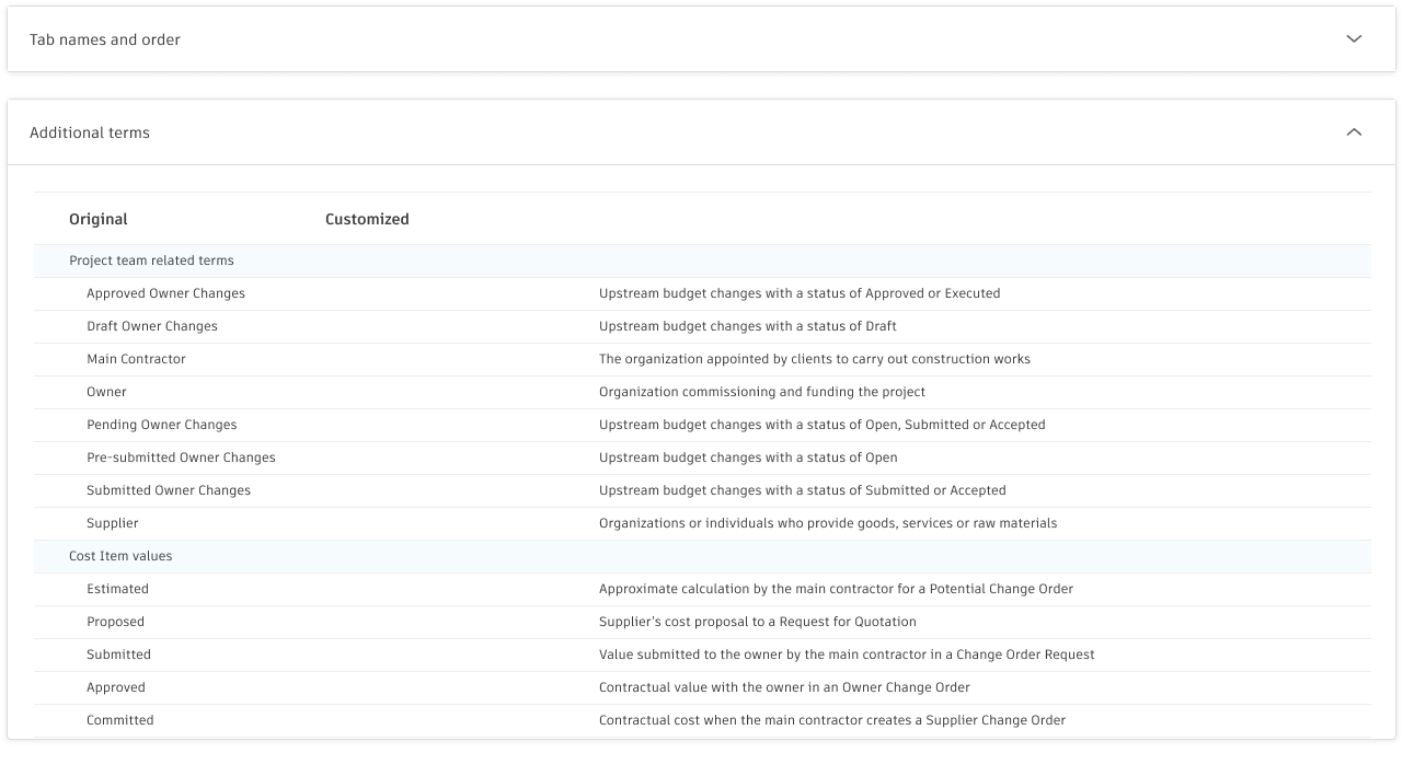

Additional Terms
As Owner or General Contractor, you can customize:
Additional terms customization animation
Input your preferred terms into the Customized column. These terms will be automatically integrated and will appear in relevant areas across the entire Cost Management.
Additional terms screenshot
