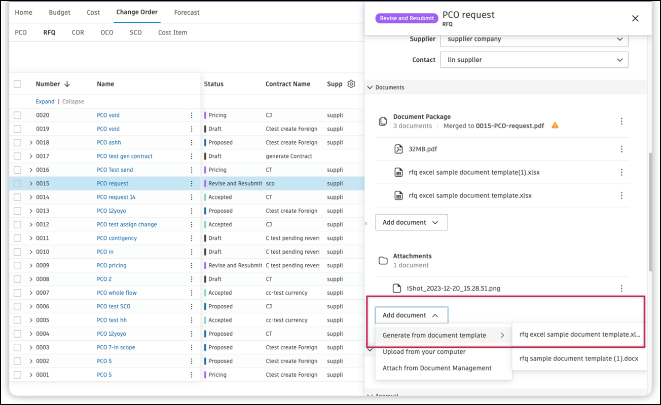

  4. Click Add Document in the Documents section.
    Add Document button in the Documents section
  5. Import files to be attached with a contract, change order, or payment. You can choose from:
    From existing work:
    • Recently Generated: The newest documents generated, if any.
    • Add From Cost Payment Application: For budget payment applications. Transfer documents from the linked cost payment application.
    • Add From Expense: For budget payment applications. Add documents from the linked expenses.
    From other project processes:
    • Add From PCO: For any change order. Add documents from a potential change order, which is the starting point of the change order workflow.
    • Add From RFQ: For change order requests (COR) and supplier change orders (SCO). Use when you want to include request for quote documentation.
    • Add From COR: For owner change orders (OCO). Use when creating owner-initiated change orders.
    • Add From Cost Item: For any change order. Use when you want to create change orders from cost items.
    • Add From Linked References: For any change order. Include detailed reports from linked references such as RFIs, issues, submittals, assets, forms, and files.
    Create new documents:
    • Generate From Document Template: Create a document from existing templates. The default template shows as the first on the list. Project administrators can create document templates in the Settings tool.
    From external sources:
    • Upload From Your Computer: Attach documents from your computer.
    • Attach From Autodesk Document Management: Select a document from the Files tool. You can make this option available in the Documents and Attachments in Cost Management section in the Settings tool.
    Note: If the template includes a cost item subtable, the OCO name is attached to the cost item name.
  6. Click Generate.

Add Documents as Attachments
Administrators have the ability to add documents as attachments. These documents can be generated from templates.
Document attachments generated from templates
Attached documents can be downloaded and sent by email.
Download and send by email options for attached documents
Learn more about how to create document templates.

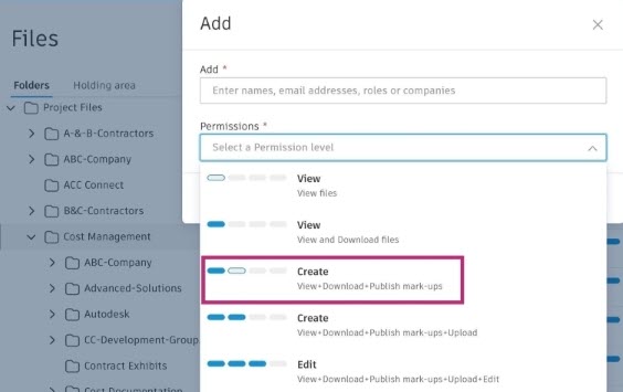

To enable adding markups to a PDF document, the project administrator has to:
  1. Select the Autodesk Document Management option in the General settings.
  2. Grant reviewers the Create permission for the folder that stores the generated PDF document.
    Create permission setting for the folder that stores generated PDFs
Then, when reviewers open a PDF document from the Cost Management document section, the BIM Viewer will automatically enable the Markup panel.
