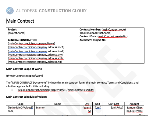

Customize Your Template
When customizing your template, do not edit the content within the brackets - these are variables that the system uses to auto-populate data when generating documents. Learn more about variables.
Look Up Document Variables
To find available variables while creating or editing a template:
  1. Click Look up document variables in the document template dialog.
  2. Browse or search for variables by category. For more details, see Variable Finder.
  3. Copy the variable syntax and paste it into your Word or Excel template.
Sample document showing variable placeholders
This feature helps you discover all available variables without leaving the template creation workflow.

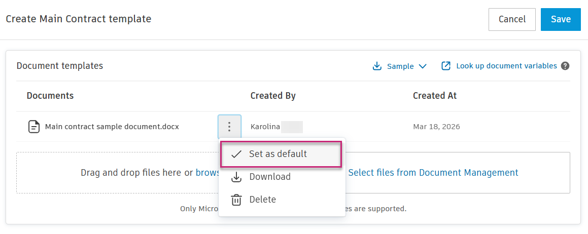

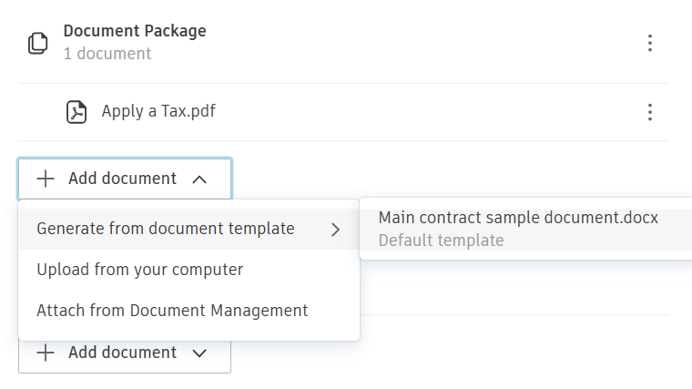

Set a Template as Default
Set a document template as default to display it first in the list of available templates when generating documents.
Default template shown first in list
To set a template as default:
  1. Select the Settings tool from the left navigation.
  2. Switch to the Budget, Cost, or Change Order tab.
  3. Scroll down to the Document Templates section.
  4. Click Edit in the upper left corner of the section.
  5. Click the More More menu icon menu next to the template.
  6. Click Set as Default.
    Set as default option in menu
Note: The first template created for a given category is automatically marked as default.

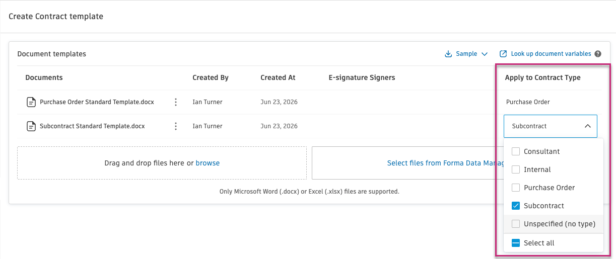

Restrict Contract Templates by Contract Type
By default, each contract document template is available for all contract types. Use the Apply to Contract Type setting to limit a template to specific contract types — for example, to prevent a Subcontract template from appearing on a Consultant contract.
When a member generates a document, only templates that include the contract's current type appear in the list.
To assign contract types to a template:
  1. Click Module Selector Module Selector icon Arrow menu icon Project Admin option button.
  2. Select the Services tab.
  3. Switch to the Cost tab.
  4. Scroll down to the Document templates section and click Edit.
  5. In the Apply to Contract Type column, click the cell for the template you want to restrict.
  6. Select one or more contract types. To make the template available for all types, select Select all.
    Apply to Contract Type dropdown in the document templates table showing contract type options
  7. Click outside the dropdown to apply.
Note: If no contract type is selected, the template is unavailable for document generation on any contract.

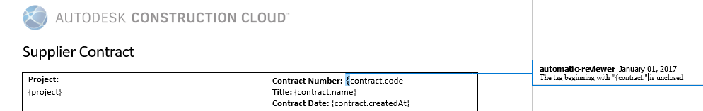

Review Invalid Variables
When variables in a template become invalid (due to system updates or errors), you'll see a Warning icon icon next to the affected template. To resolve:
  1. Click the More More menu icon menu next to the invalid document template.
  2. Choose Review Issues.
    Review issues option in menu
  3. The template downloads automatically. Open it to see comments next to invalid variables.
    Word document showing variable review comments
  4. Resolve the issues within the document.
  5. Upload the corrected template.
