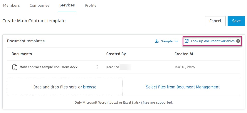

  6. The template creation tool will open. Here, select Look up document variables in the upper right corner.
    Look up document variables button in the template creation tool
  7. After clicking, the Autodesk Construction Cloud Cost Management Variable Finder will open in a popup window.
