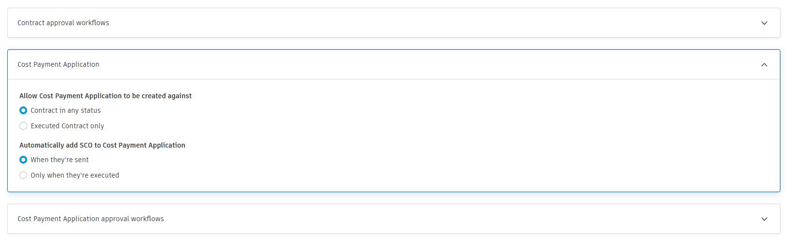

Payment application creation
Project administrators can choose which contract statuses members can use when they create a cost payment application.
To configure payment application creation:
  1. Click Module Selector Module Selector Icon Arrow Icon Project Admin Option Button.
  2. Go to Services, then click Cost Management.
  3. Switch to the Cost tab.
  4. Expand Cost Payment Application.
  5. Under Allow Cost Payment Applications to be created against, select an option:
    • Contract in any status (default) — Members can create cost payment applications against contracts in any status. This matches existing behavior.
    • Executed Contract only — Members can create cost payment applications only against executed contracts. Cost Management blocks creation against other statuses.
Note: Only project administrators can change this setting. Cost Management enforces the limit when members create or batch-create cost payment applications. The limit is not retroactive — existing cost payment applications are not affected when you change the setting.
Configure rules for cost payment applications, including when subcontractor change orders (SCOs) are added automatically.
Automatically add SCO to Cost Payment Application
By default, Cost Management automatically adds SCOs to cost payment applications when they reach Sent status. You can change this so SCOs auto-add only after Executed status. This helps teams that don't want subcontractors to bill for change orders that haven't been finalized.
To configure when SCOs auto-add:
  5. Set Automatically add SCO to Cost Payment Application:
    • When they're sent — SCOs auto-add when they reach Sent status. This is the default.
    • Only when they're executed — SCOs auto-add only after Executed status. Sent SCOs aren't added automatically. They can't be selected in Add Change Order until they're executed.
      Cost settings showing Automatically add SCO to Cost Payment Application with When they're sent and Only when they're executed options
Note: This setting controls automatic addition only. You can still add change orders manually when a change order type is configured for pay before approval.
Tip: If an unexecuted SCO is already in a billing and must be changed, you may need to revert the billing and detach the SCO first.
See SCO statuses to learn how Sent and Executed fit in the change order workflow.
