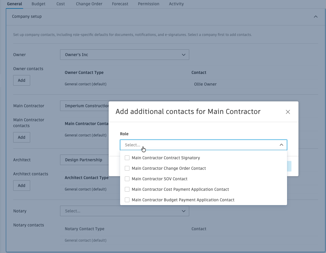

Company Setup
Company Setup defines default companies and contacts for key project roles. These contacts are used in document templates, as default recipients when sending change orders or payment applications, and in e-signature workflows.
For Owner, Main Contractor, and Architect, you can assign a General Contact plus additional contact types for specific workflows—for example, a contract signatory who signs main contracts but not every change order, or a separate reviewer for budget payment applications.
Note: If you rename Owner or Main Contractor in Additional Terms, the contact type labels in Company Setup update to match.
To configure company roles:
  1. Go to the Company Setup drop-down in General Settings.
  2. For each role, select the company, then assign contacts to the contact types that apply to your project:
    Owner
    • General Contact — Default owner contact for the project
    • Contract Signatory — Signs original main contract documents
    • Change Order Contact — Default for CORs, OCOs, and related change order workflows
    • Budget Pay App Contact — Default reviewer for budget payment applications
    Main Contractor
    • General Contact — Default main contractor contact for the project
    • Contract Signatory — Signs original contract documents
    • Change Order Contact — Default for SCOs, CORs, OCOs, and related change order workflows
    • SOV Contact — Reviews schedule-of-values hierarchy submissions after a subcontract is executed
    • Cost Pay App Contact — Default reviewer for cost payment applications
    Architect
    • General Contact — Default architect contact for the project
    • Change Order Contact — Default for CORs, OCOs, PCOs, and related change order workflows
    Notary — Used for document templates that require notary information. Assign one company and contact.
Company Setup showing multiple contact types for Owner, Main Contractor, and Architect roles
Tip:
  • If your project process role is Contractor, the Main Contractor field auto-populates with your company. If your role is Owner, the Owner field auto-populates. You can override these values if needed.
  • The company dropdown initially displays approximately 50 companies. To find a specific company, start typing in the search field to filter the list. When you select "Search in account company directory," your filter criteria will carry over.
  • If a workflow-specific contact type is empty at a given level, Cost Management falls back to the General Contact for that role at the same level.

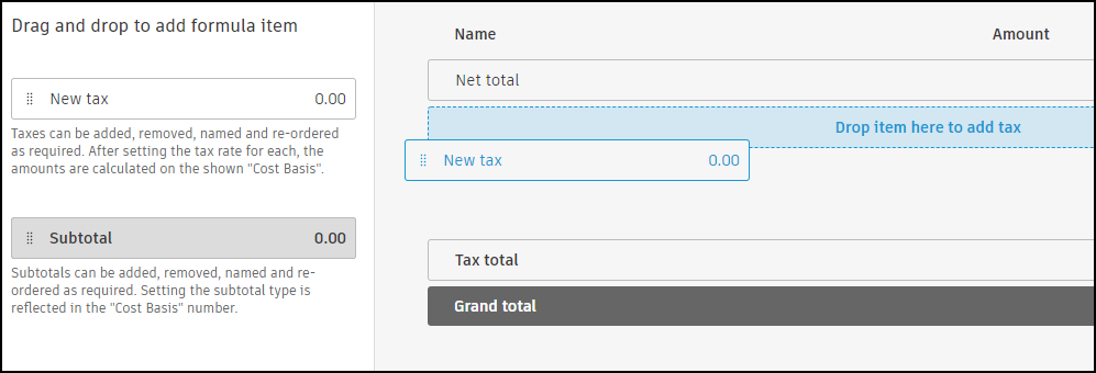

  3. Select the pencil icon to edit the formula's name.
  4. To update the net total default (1,000.00) in the center preview panel, click Net Total.
  5. Drag a new tax into the center column to add to the formula.
    Add new tax
  6. Click newly added New Tax to specify the Tax Rate as a percentage. The tax rate can be positive or negative. Negative tax rates are useful for figuring out CIS deductions.
    Edit new tax
    Important: If taxes in different tax formulas have the same name, they'll be combined into a single tax in the tax summary regardless of the tax rate.
  7. Continue adding more taxes as needed to build out your formula. As you add taxes, the tax total is calculated based on the tax rate and the net total. Combined, these values produce the grand total. Taxes can be added, removed, named, and reordered as required. After setting the tax rate for each, the amounts are calculated on the Cost Basis column.

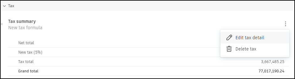

    Note: You can add a taxable base limit. This limit determines the maximum amount of income that can be subject to taxation within a specific period.
  8. Drag a new subtotal into the center column to add to the formula. The subtotal is used to support a tax-on-tax use case.
  9. On the right panel, you can choose between two options:
    • Revise Cost Basis to recalculate the cost basis for subsequent taxes.
    • Info Only to have the subtotal visible for informational purposes without recalculating the cost basis for subsequent taxes.
    New subtotal
    Note: If there are multiple taxes above the subtotal, the subtotal will display both the tax subtotal and the subtotal.

    The applied tax is visible in the tax summary for the line item.
    Tax summary details
    Note: You may see a message indicating the base data was modified. In that case, you'll be prompted to recalculate the applied tax. Several things can lead to the prompt to recalculate, depending on where the tax is being added:
    Contract Cost Payment Application Main Contract Budget Payment Application OCO SCO
    Budget added Period work complete value changed Subitem added in table Period work complete value changed Approved value changed in cost item Committed value changed in cost item
    Budget deleted Materials stored value changed Subitem imported in table Materials stored value changed Cost item attached/detached Cost item attached/detached
    SOV amount changed in table Retention setting changed SOV amount changed in table Retention setting changed Cost item hierarchy changed Cost item hierarchy changed
    Subitem added in SOV table Retention value changed Linked budget changed Retention value changed Cost item hierarchy changed Cost item hierarchy changed
    Subitem imported in SOV table Value changed from previous period Subitem deleted Value changed from previous period OCO markup changed
    SCO added/deleted for Cost Payment Application OCO added/deleted for Budget Payment Application
    If you levy a tax on a sent or executed SCO, it will be displayed under the contract tax. You'll be able to see the net total and tax total for all change order taxes that are related to the contract. You can expand to see more detailed information, including specific change orders that affect contract tax.
  5. If necessary, use the More menu Vertical more menu icon and choose Edit Tax Detail or Delete Tax.
    Cost tax more menu
    Editing the tax details allows you to turn on or off specific taxes as needed. The change is automatically updated in the Tax summary table.

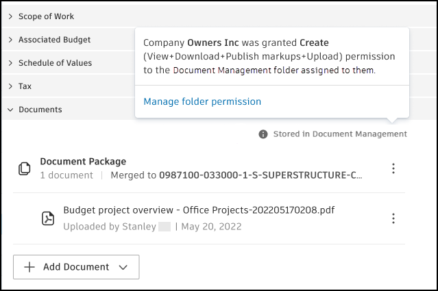

Documents and Attachments in Cost Management

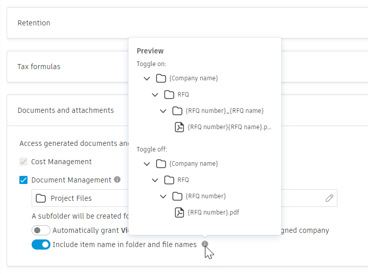

You can choose to store documents and attachments in both Cost Management and a specified location in Autodesk Document Management.
Documents and attachments will be stored in a subfolder created for each company when choosing the Autodesk Document Management option. Choosing to store the files in Autodesk Document Management creates a single repository of all generated documents specific to each company for future audit purposes. If desired, the folder can be shared with other project members to access the information. To do that, members must have upload permission to the related folder to generate documents or upload attachments in Cost Management.
As a project administrator, you can automatically grant the Create permission to the assigned company. See the Folder Permissions article to learn how to manage folder permissions for each company.
In the Documents section, you can manage folder permissions for your company by accessing the flyout panel of the contract, main contract, payment applications, and change orders. Simply click Manage Folder Permissions to open the relevant permissions for this company's folder.
Stored in Autodesk Document Management
You can also include or exclude an item name in the folder and file names.
Shorten document name
Learn more about:
