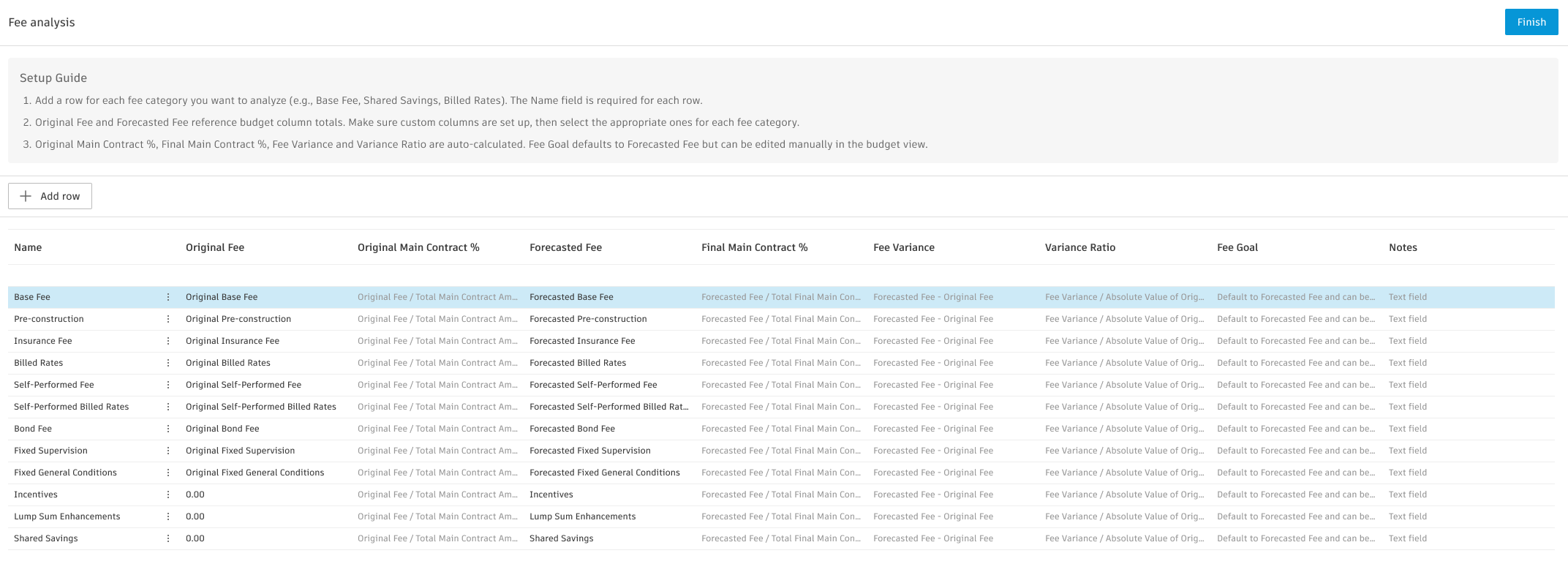

Fee Analysis
Set up fee categories and their data sources for analysis in the Budget view. Each fee category points to budget columns that supply the original and forecasted fee values, and the Fee Analysis table calculates variance, ratios, and percentage of the main contract from those values.
Fee analysis settings page with the Setup Guide and a configured table of fee categories mapping Original Fee and Forecasted Fee to budget columns
To set up Fee Analysis:
  1. Open project Services, then the Budget tab.
  2. Expand the Fee analysis section and click Manage.
  3. Add a row for each fee category you want to analyze (for example, Base Fee, Shared Savings, Billed Rates). For each row, set:
    • Name — Required. Display name used in the Fee Analysis table.
    • Original Fee — The budget column that supplies the original fee value, or a fixed number.
    • Forecasted Fee — The budget column that supplies the forecasted fee value, or a fixed number.
  4. Save your changes.
The remaining columns — Original Main Contract %, Final Main Contract %, Fee Variance, and Variance Ratio — are calculated automatically from the Original Fee and Forecasted Fee values. Fee Goal defaults to the Forecasted Fee value but can be edited manually in the Budget view, and Notes is a free-text field also editable in the Budget view.
To deactivate or delete a fee category, use the 3-dot menu next to each row.
Note:
  • Original Fee and Forecasted Fee can reference any budget column whose total is calculated by summing all rows. Custom columns must already exist in the project before you can pick them here. See Create Custom Columns for setup.
  • Fee analysis values are project-level totals and ignore filters applied to the Budget view.
See Fee Analysis and Fee Analysis Snapshot for how project members consume these settings in the Budget view.

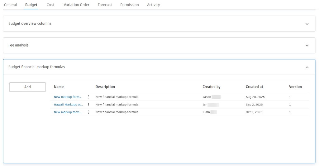

Budget Financial Markup Formulas
Define markup formulas that calculate values on the Final Main Contract Amount column in the Budget view. When a formula is applied, the affected budgets become markup budgets, and their Final Main Contract Amount values come from the formula calculation instead of the column's defined formula.
Budget financial markup formulas section expanded with an Add button and a list of saved formulas
Note: Budget financial markup formulas apply to budget columns and are configured here. They are a separate concept from the Financial Markup Formulas configured on the Change Order tab and applied to change orders. Both can coexist on the same project.

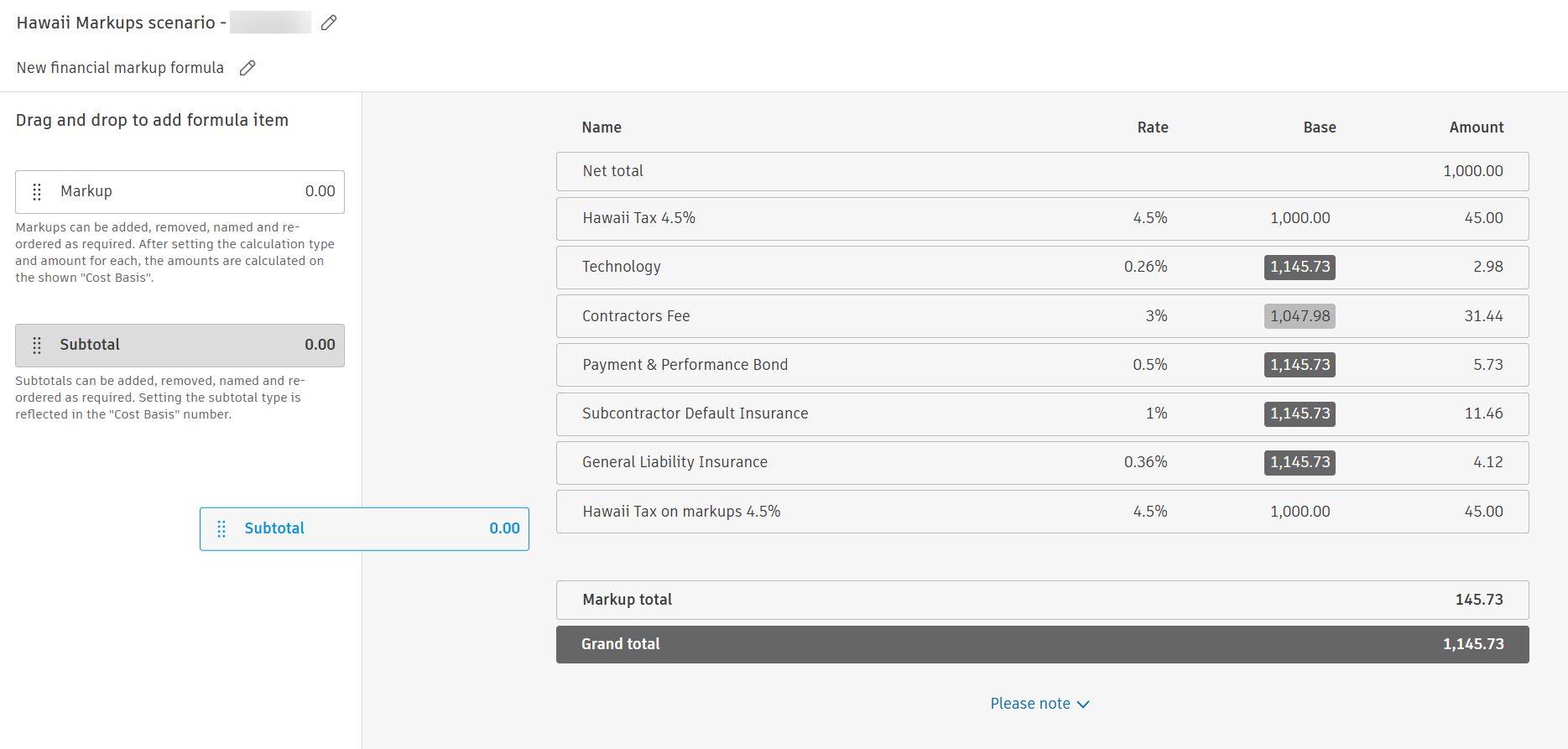

To create a budget financial markup formula:
  2. Expand the Budget financial markup formulas section and click Add. The formula editor opens.
  3. Set the formula's name and an optional description (the pencil icons next to the title and subtitle).
  4. Build the formula by dragging items from the Drag and drop to add formula item panel on the left into the formula table. Two item types are available:
    • Markup — A markup row. After dropping it, click the row to open the Markup edit panel on the right and configure:
      • Name (required).
      • Type & ratePercentage (calculated against the selected Cost Basis) or Lump sum.
      • Cost Basis — The basis used to calculate this markup, such as Current cost basis or a previous subtotal.
      • Variable — Toggle on to allow the markup amount to be edited at the time the formula is applied.
      • Description (optional).
      • Map markup to budget code (required) — The budget code in the project that this markup writes to. Each markup must map to a unique budget code. If the code doesn't exist when the formula is applied, a new budget is created using the markup name, with Original Budget set to Qty 1, Unit Cost 0, Amount 0.
      • Calculated on non-markup budgets where — Optional filter that scopes which budgets this markup calculates against, based on the value of the column where the formula is applied or on budget code segments. For string-type conditions, operators include Does not start with and Does not end with, in addition to operators such as Contains, Starts with, and Ends with. See Filter and Group for table filters in Cost Management.
    • Subtotal — A subtotal row. After dropping it, click the row to open the Subtotal edit panel on the right and configure:
      • Markup subtotal name (required).
      • Cost basis revisingRevise cost basis recalculates the Cost Basis used by markups that follow this subtotal. Info only displays the subtotal without changing the cost basis for subsequent markups.
  5. Reorder, rename, or remove markup and subtotal rows as needed. The system fills in the Amount column for each markup, and Markup total and Grand total are calculated at the bottom of the formula.
  6. Click Save.
Budget financial markup formula detail with a drag-and-drop palette and a table of markup items showing Rate, Base, and Amount
Manage saved formulas:
To manage saved formulas, open the 3-dot menu on the formula row in the list:
Note: If the master list is locked and a mapped budget code can't be created when the formula is applied, members can't apply the formula.

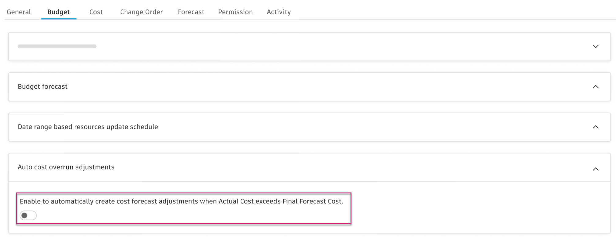

Auto Cost Overrun Adjustments
Project administrators can turn on automatic cost forecast adjustments when Actual Cost exceeds Forecast Final Cost. The setting is off by default. Existing projects keep the legacy Projected Cost behavior until you enable it.
When the setting is on, Cost Management creates a Cost overrun adjustment (system-generated) instead of promoting actual cost into Projected Cost. This keeps Budget and Cash Flow aligned and avoids double-counting manual forecast adjustments. See System-Generated Cost Overrun Adjustments to learn how adjustments are created.
To turn on auto cost overrun adjustments:
  2. Expand Auto cost overrun adjustments.
  3. Turn on Enable to automatically create cost forecast adjustments when Actual Cost exceeds Final Forecast Cost.
Auto cost overrun adjustments toggle in Budget settings

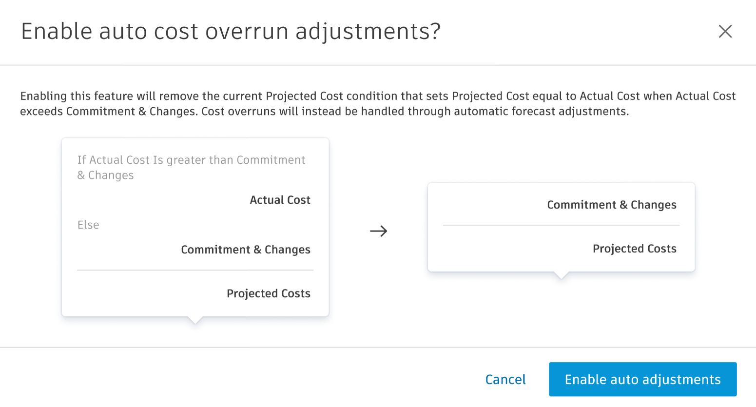

Important: If Projected Cost still uses the legacy condition that sets Projected Cost to Actual Cost when Actual Cost exceeds Commitment & Changes, a confirmation dialog appears when you turn the setting on. The dialog shows the current and updated formula. Select Enable auto adjustments to confirm. Turning the setting off can restore that condition using the same confirmation flow.
Enable auto cost overrun adjustments confirmation dialog showing Projected Cost formula change
Tip: If the setting is on but Projected Cost still contains the legacy condition, an inline message explains that automatic adjustments won't trigger until that condition is removed. Select View column formula in the message to open Projected Cost in Manage columns.

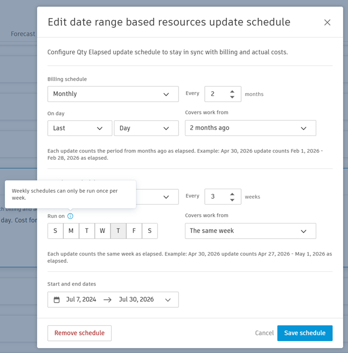

Date Range Based Resources Update Schedule
Configure the Qty Elapsed update schedule for date range based resources so they stay in sync with your project's billing and actual cost cycles.
Note: This setting can't be changed once any date range based resource has been distributed in cash flow.
The collapsed section shows a summary of the current configuration — for example, how often the budget forecast and cost forecast update and the schedule's start and end dates. Click Edit schedule to open the configuration modal.
To configure the schedule:
  2. Expand the Date range based resources update schedule section and click Edit schedule. The Edit date range based resources update schedule modal opens.
  3. Configure the Billing schedule (available when budget forecast is on):
    • FrequencyMonthly or Weekly. The frequency you pick determines which fields appear below.
    • Every {N} — The repeat interval for the selected frequency (for example, every 2 months or every 3 weeks).
    • For Monthly frequency, set On day — two dropdowns that pinpoint the exact day each update falls on, such as the Last Day of the month.
    • For Weekly frequency, set Run on — click a day-of-the-week button (S, M, T, W, T, F, S) to choose the day each weekly update runs. Weekly schedules can only run once per week.
    • Covers work from — The reporting period each update represents. Options vary by frequency, for example The same month, 2 months ago, or The same week. The helper text below the field shows a worked example for the selected option (for example, with 2 months ago selected for a monthly schedule, an Apr 30, 2026 update counts Feb 1, 2026 – Feb 28, 2026 as elapsed).
  4. Configure the Actual cost schedule using the same fields. When budget forecast is off, only the Actual cost schedule is configurable.
  5. Set the Start and end dates for when the schedule is in effect.
  6. Click Save schedule. To clear an existing schedule, click Remove schedule.
Edit date range based resources update schedule modal with Monthly Billing schedule, Weekly Actual cost schedule, Covers work from controls, and Start and end dates picker
In the budget bottom flyout, the Billing Frequency and Actual Cost Frequency columns reflect the configured schedule. All date range based resources share the same schedule configuration.
Tip: In the budget overview, the Update button (available to members with Full Control permission) manually refreshes date-range-based calculated values such as Calculated Final Budget, Calculated Final Cost, and related base values. These values are also exposed in the Project value picker when you create or edit a custom column, so calculated columns built on top of them stay in sync with the schedule configured here. A tooltip next to the Update button shows when values were last refreshed.

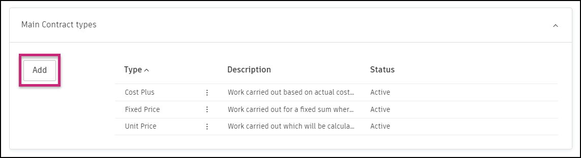

Main Contract Types
A main contract is the primary contractual agreement entered into directly, for example, between an owner and a main contractor. When creating a new main contract, you can choose your main contract type from the predefined options or add one in the settings to fit your company's needs.
Choose from the presented options:
Tip: System defaults cannot be deleted. You can deactivate them, so they do not show up in the user interface.
To add a main contract type, click Add in the upper left corner of the Main Contract Types.
Main Contract Types settings with Add button to create custom contract types
To assign a contract type to a line item by a drop-down list:
  1. Go to the Budget tab.
  2. Switch to the Main Contract tab.
  3. Enter edit mode by clicking Edit pencil icon.
  1. Choose the contract type in the Type column.
To learn how to create a contract, see the Work with Contracts article.
