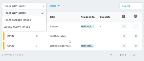

Use the team group drop-down menu or filters to manipulate the issues list.
Select the team group drop-down list.
Select one of the following:
Team WIP issues - to see all the issues created on both your team's work-in-progress models (Team Space) and models shared by your team (Shared folder).
Team package issues - to see only those issues created on your team's work-in-progress models.
All my team's issues - to see only those issues created on your team's shared models.
Click Filters
Filter using the following fields:
Status
Created by
Assigned to
Created at
Due Date

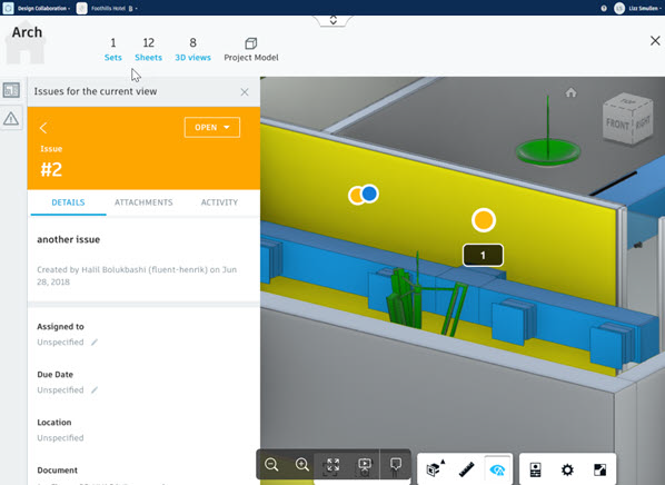

If an issue is created in a document, you can select the document link inside the issue and view the document the issue was created from. This view remains inside the Design Collaboration module.
Edit project-level and document-level issues according to your needs.
Click a project-level or document-level issue to open it for editing.
To change the issue status, from the Status drop-down list select the desired status.
On the Details tab, edit the assignee and due date.
On the Attachments tab, add the desired files to an issue.
On the Activity tab, enter a comment you want to add to an issue, and click Send. Mention someone with @ to have a message sent to them.
