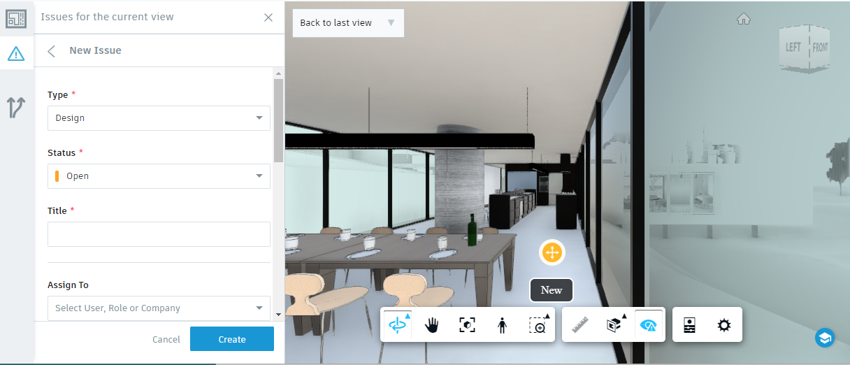

To create an issue:
  1. Open a 2D sheet or 3D view.
  2. From the toolbar on the left, click the Issues icon .
  3. Click Create Issue at the bottom of the Issues panel in the Content Browser.
  4. Click a location on the sheet or view to place the issue pushpin. If necessary, click and drag the pushpin to adjust its location.
    Note: The location field automatically populates if the pushpin is placed in an area defined by a project administrator. Moving the pushpin to an undefined location will clear the location field.
  5. Specify the issue Status and enter a Title. By default, the issue Type is set to Design and the issue Status is set to OPEN. You may modify these required fields as necessary.
    Tip: When creating an issue, you can set the issue status to Draft before saving it. When ready to assign, set to Open.
  6. Optionally, add a description and specify the assignee, location, location details, root cause, and due date.
    Tip: You can assign by users, roles, or companies. Assignees will receive an email notification with a link to the issue.
  7. Click Create.
Note: Only issue creators or project administrators can see an issue in Draft mode or close an issue.
