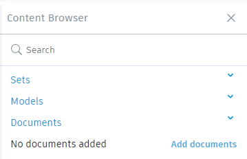

Select the relevant sets and models from the content browser.
To add supporting documents to your package, select Documents from the content browser and click Add documents.
Select all relevant supporting documents from your team's folder. Refer to the Supporting Documents to learn more about the file types that can't be included as supporting documents.
