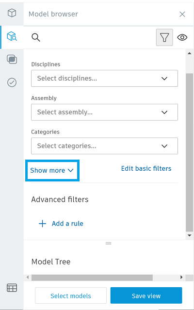

In the viewer, click the Model browser tab to view the filters and model tree.
Apply Basic Filters
A few basic filters are displayed by default. Click Show more to view all basic filters.

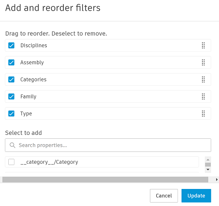

Edit Basic Filters
If the default basic filters don't meet your needs, click Edit basic filters to reorder filters and create custom basic filters based on model properties.
  1. Use the search field to search for the required model property.
  2. Select the property to add it to the list of filters at the top of the dialog box.
  3. Drag the selected filters to control the order in which they appear on the Model browser panel. You can also deselect the default filters so they no longer appear.
  4. Click Update to save your selection to the Model browser panel.

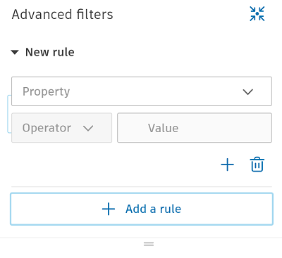

Create and Apply Advanced Filters
You can create custom rule-based filters where each consists of a property, operator, and a value. Click the drop-downs below to see more details:

  1. Click Add a rule under Advanced filters.
  2. Create your first rule part defining a property, operator, and value.
  3. You can extend the first rule part by clicking + and adding another rule part as required. Two or more rule parts added together create a filter rule.
  4. Add more rule parts as required to the filter rule by clicking +.
    Multiple filter rules can be built and joined by a logical operator (and/or). The logical operator will determine whether a model object must pass all rule part conditions or one set of filter conditions to be displayed.
  5. Click Add a rule to join your filter rule to another.
  6. Choose between and/or. This selection will be applied to all filter rules in this view.
    Once a logical operator is selected between the first and second filter rule, the same operator will be applied by default to subsequent filter rules. Keep this in mind as you build out your filter rules.
    Note: You can only create a maximum of 100 rule parts and filter rules for a single view.#

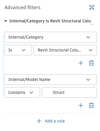

Suppose you want to create a view focused on the structural columns in a structural model.
  1. In the property field, search for Category and choose Internal/Category.
    Note: This property comes from the categories in Revit. IFor an IFC or other file format, see the table above for useful properties to filter by.
  2. Keep the operator Is and choose the value Revit Structural columns.
    Note: To avoid the Revit prefix on values, use the property Internal/Category Name instead.
    Suppose you also have structural columns in your architectural model, and you want to ensure we are filtering only to columns in the structural model.
  3. Extend the first rule part by clicking + directly under the rule.
  4. Use the property Internal/Model name, the operator Contains, and the value Struct.
    Note: Ensure that you use the correct capitalization entering the Contains value.
    You have now filtered the view to only the structural columns in the structural model.

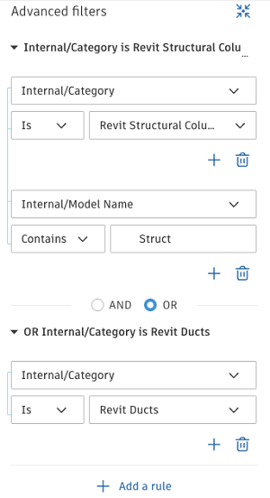

    Suppose you want a view that contains structural columns and ducts, so that you can check for clashes between these two specific sets of objects.
  5. Click Select models and add the HVAC model into the viewer.

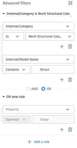

  6. Add a new rule to the advanced filters.
  7. Set the joining operator to Or so that the filter can find both structural columns and ducts.
  8. Use property Internal/Category again, with the operator Is and the value Revit Ducts.

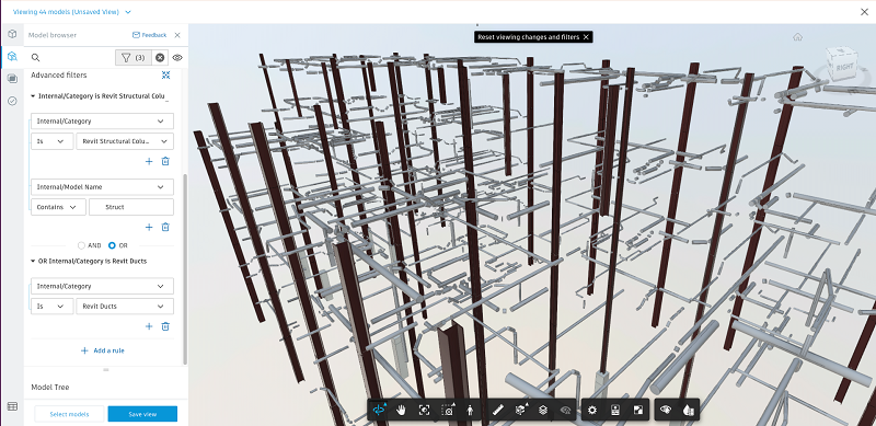

    You now have a view of the structural columns and ducts in your models.
  9. Navigate to the Clashes tab and set the Primary model to one of the models of interest (for example, the structural model) to view clashes between the structural columns and the ducts.

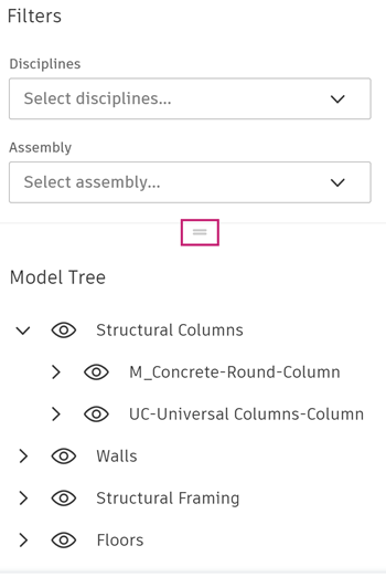

Model Tree
While filters exclude objects from your model, you can choose to control the visibility of objects by using Show and Hide in the Model tree.
Note: Changes you make to the visibility of objects in the Model tree are not saved when you create a view.
  1. Click the handle under the filters and drag up to view the Model tree.
  2. Click the icon next to an object grouping to show or hide all objects in the grouping.
  3. Click > next to an object grouping to show all the subgrouping objects which you can also show and hide.
    Tip: You can all show all objects by right clicking in the viewer and selecting Show all objects.
