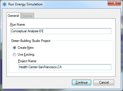

Name the analysis and specify the Green Building Studio project.
In the Run Energy Simulation dialog, specify a name for the analysis, and select whether to create a new or use an existing Green Building Studio project. Then click Continue. (Choose a name that is descriptive of the model and energy settings, and ensure that the Project you’re assigning the run to have the proper location and building type settings.) |

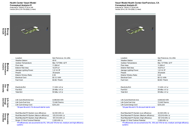

Access the results by clicking the pop-up alert or Results and Compare
When the simulation is complete, an alert displays. Click the analysis name in the alert to view the simulation results. Or click Analyze tab |

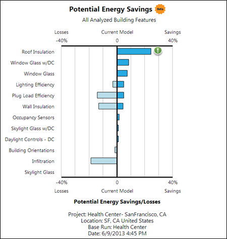

Review the simulation results.
In the Results and Compare dialog, view the analysis results. Tip: Use the Settings tab to select the charts to include in the results and to configure the display of energy analysis data on the Results tab. |
