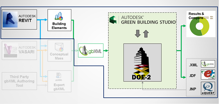

You can use a detailed building information model from Revit (2014 or later) as the basis for your energy analysis. Revit will automatically create an Energy Analytical Model (EAM) from the building elements in the model (walls, windows, ceilings, roof, etc.), and pass that information to Green Building Studio for energy simulation.

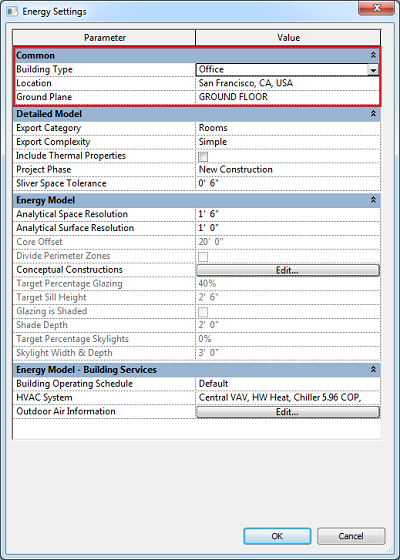

Specify the building energy settings as needed.
Click Analyze tab
For more information about these settings see Energy Settings. |

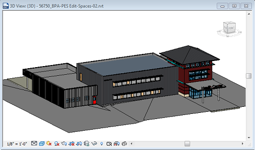

Display a 3D view of the model, and click Analyze tab |

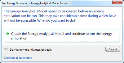

Check the Energy Analytical Model and proceed with the Simulation.
You are informed when the energy analytical model has been generated. Click OK. To learn about energy model validation and limitations, see Energy Analysis using Building Elements Model Validation. You can review the geometry in Autodesk Design Review. |

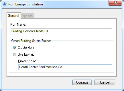

Name the simulation run and specify the Green Building Studio project.
In the Run Energy Simulation dialog specify the run name and the Green Building Studio Project to assign the run to. (Choose a name that is descriptive of the model and energy settings, and ensure that the Project you’re assigning the run to have the proper location and building type settings.) Then click Continue. |

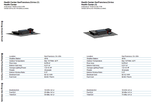

Review the simulation results.
In the Results and Compare dialog, view the analysis results. Tip: Use the Settings tab to select the charts to include in the results and to configure the display of energy analysis data on the Results tab. |
Make changes, simulate, and compare.
Modify the building model and energy settings as needed. Then repeat steps 5-7 to run a simulation on the modified model. For a side-by-side comparison of simulation results, select multiple analyses and click Compare on the toolbar. |
