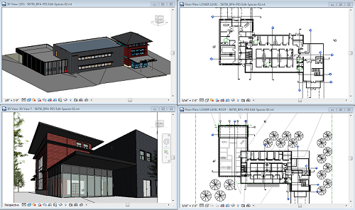

Create your building model
You can use any modeling tool that supports gbXML as an exportable file format. |
Export Your Design to gbXML |
A gbXML file contains the geometry and other properties necessary for building performance analysis. Depending on your model, additional data might include construction performance data, internal gains, schedules of operation, and basic HVAC information.

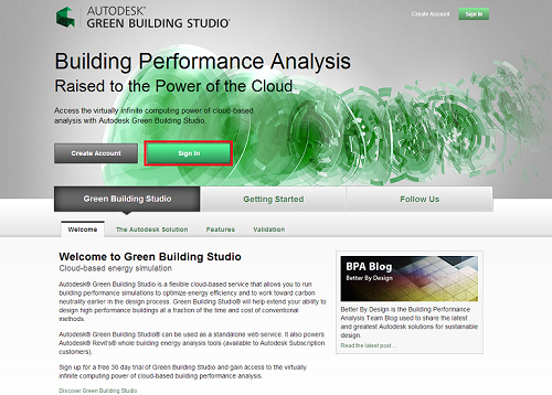

Go to the Green Building Studio Website and sign in to Autodesk 360.
Autodesk Green Building Studio is integrated with Autodesk Single Sign In the authentication system for Autodesk Subscription Center, Discussion Groups and many Autodesk customer sites. |

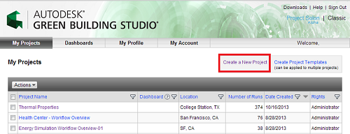

Create a new project or use an existing project.
After signing in to Autodesk 360 the Project List page displays. Create a new project and enter the location of the project.
Note: There are several other project level parameters you can add for utility costs, currency, time zone, building schedule, building-level defaults for internal gains, constructions, HVAC systems, and DHW.
Note: Once you have created a project, but have not yet submitted any runs to the project, you can edit the project name, building type, schedule, location, currency type, utility rate, and weather file. However, once runs have been submitted to your project, you can only edit the project name.

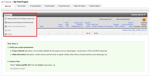

Upload the gbXML file to Green Building Studio.
Once your project has been created on GBS, you can import the gbXML file you’ve created.
Note: Green Building Studio will automatically fill in any missing data necessary for energy analysis using its extensive database of intelligent defaults (taken from ASHRAE Standards and many other industry-recognized sources).
