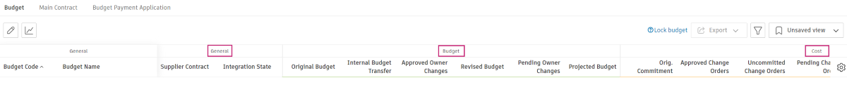

Each table is organized into main sections:
The values in these columns update as the budget status changes:
Original Budget: Populates as the budget is entered or imported.
Internal Budget Transfers: Populates by internal budget transfers and transfers from forecast adjustments.
Approved Owner Changes: The sum of the approved value of cost items with a budget status of Approved or Executed.
Revised Budget: Populates with the sum of the Original Budget, Internal Adjustments, and Approved Owner Changes.
Pending Owner Changes: The sum of the value of cost items with a budget status of Open, Submitted, Accepted, or Revise and Resubmit.
Projected Budget: The sum of the Revised Budget and Pending Owner Changes.
Billed To Date: Shows the Approved Budget Payment Application. Visible when project administator turn on budget revenue forecast. See Budget Forecast to learn more.
The colors in the following image represent the column where values appear based on their budget status. The value entered comes from the budget stage of the cost item.
