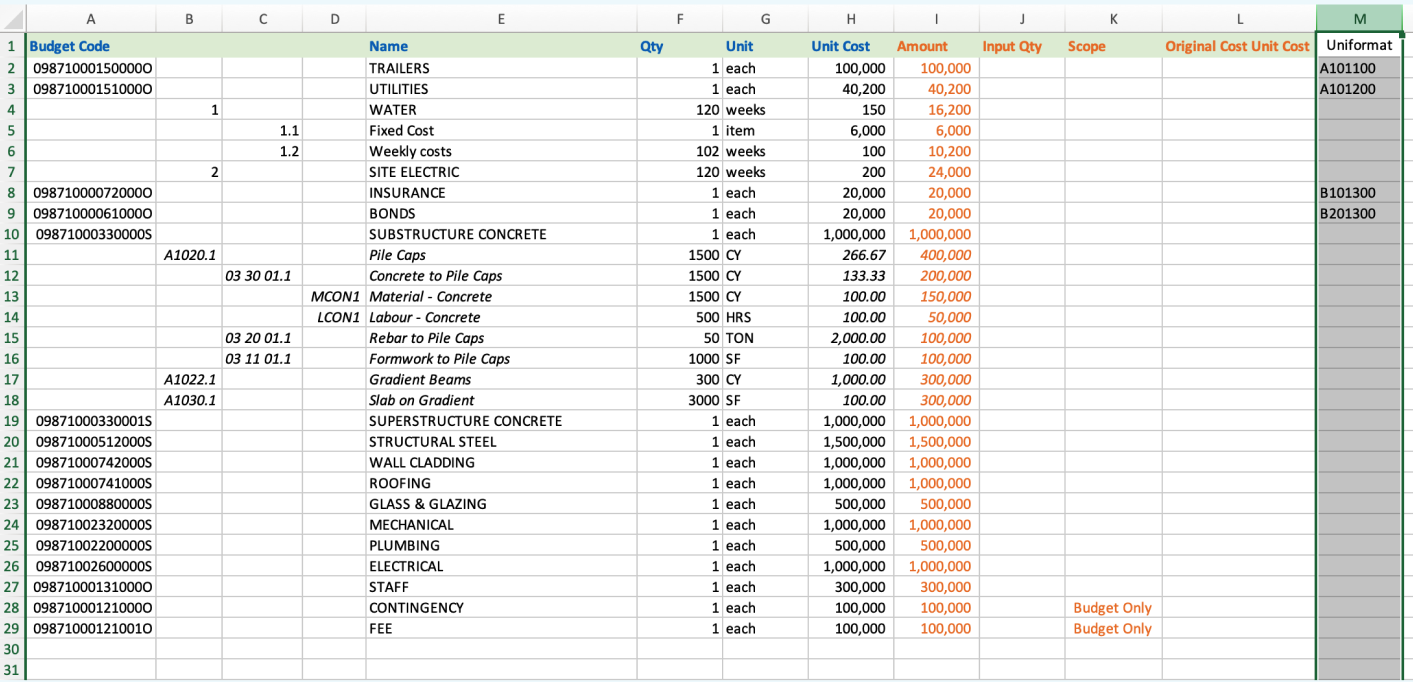

Import classification codes with a budget
When classification structures are assigned to the Cost Management project, the budget import template includes optional columns for each structure. Enter a classification code in the column to tag that budget line on import. Classification columns are optional.
Budget import template with optional classification code columns
Best Practices on Formatting a Budget Excel File
The following example shows an exported budget on the left and the proper format for import on the right. The summary groups are removed which allows sorting by segment - the same functionality, but more flexibility.
Budget import example showing exported budget on left and proper import format on right
Tip: Follow guidelines within budget template to see more tips and tricks.

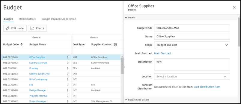

You can add a budget manually. To add a budget item:
  1. Click the Budget tool from the left navigation.
  2. Select the Pencil icon icon to edit.
  3. Click Add to add individual budget items.
  4. On the new budget item row, enter the budget code. The budget code field restricts your data entry to the form defined in the budget code template. If delimiters are used between segments, they are automatically populated.
    Tip: The name of the new budget item is added automatically, based on the previously prepared budget code segments in the Settings tool.
  5. If desired, you can click the budget name to open the details panel and add a description for the budget code or change the budget name.
  6. Enter the Quantity.
  7. Select the Unit Type.
  8. Enter the Unit Cost. The amount is populated automatically from the quantity and unit cost.
  9. Select a Location for the budget item from the location breakdown structure.
  10. Click Pencil icon again to return to the default view-only state.
Tip: You can quickly edit budget items by clicking each one and using the panel on the right.
Budget details panel on the right side of the screen showing budget item information
