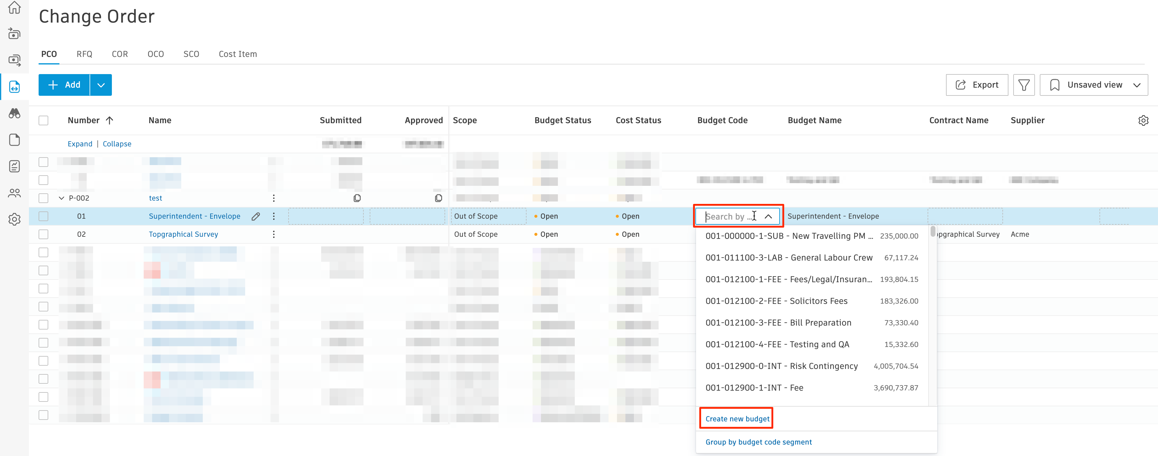

Add a Budget from a Cost Item
When working with cost items, you can create a new budget directly from the cost item's budget dropdown. This method is convenient when you're in the process of creating or editing a cost item and realize you need a budget that doesn't exist yet.
To add a budget from a cost item:
  1. Navigate to the Change Order tool from the left navigation.
  2. Switch to the Cost Item tab.
  3. When adding or editing a cost item, click the Budget Code dropdown.
  4. Select the option to Create new budget from the dropdown.
  5. Follow the prompts to define the new budget with the appropriate budget code, name, and other details.
Cost item budget dropdown showing option to create a new budget
Once created, the new budget will be automatically selected for your cost item and will be available for use in other cost items and throughout Cost Management.
Tip: This method provides a streamlined workflow when you need to create budgets on-the-fly while working with cost items. For more detailed budget creation and management, use the manual budget creation method in the Budget tool.
