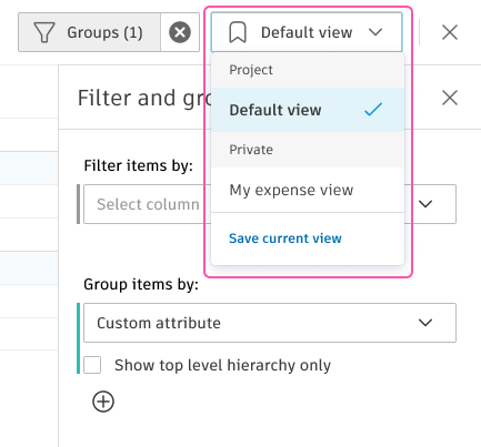

  11. The Filter and Group tool helps to arrange efficient views of your data and create clear and legible reports.
  12. See your saved views or create ones for quick access to budget data.

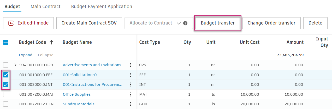

Transfer a Budget Item
If you need to transfer a budget item to a different budget, follow these steps:
  1. Click the Edit icon Edit Budget to open the budget in Edit mode.
  2. Locate the parent budget item and click the More menu Vertical More Menu.
    Tip: You can also right-click the budget item to access the More menu. Or, if you want to transfer more budget items, check box next to each one and then click Budget Transfer.
    More Items in Budget Transfer
  3. Select the Budget Transfer option.

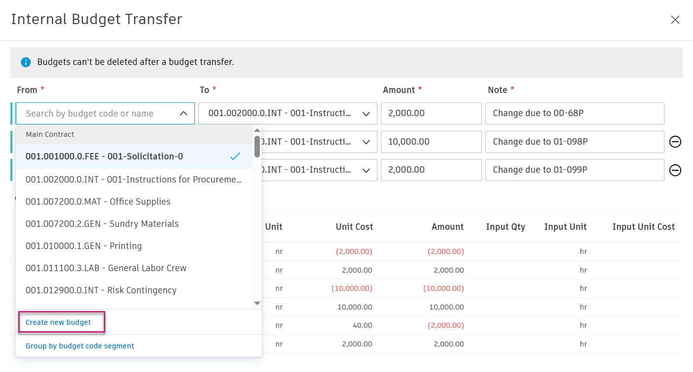

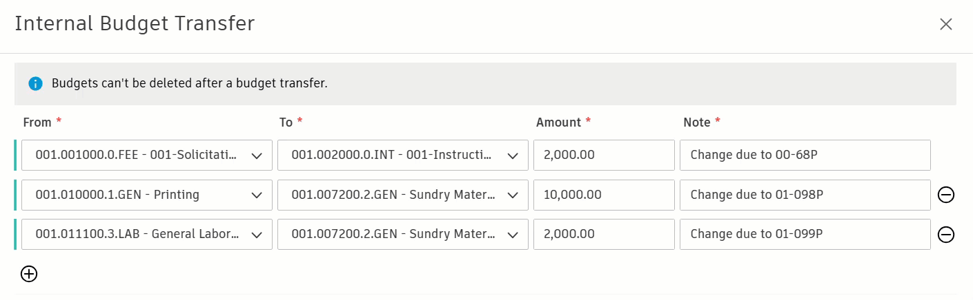

    Budget Transfer
  4. In the From drop-down list, select the budget you want to transfer from.
  5. In the To drop-down list, select the budget you want to transfer to.
  6. Enter the amount to transfer.
  7. Add a note.
  8. To add extra rows, click the Add icon Add Icon.
  9. To delete a row, click the Delete icon Minus Icon.
  10. Click Save to complete the transfer.

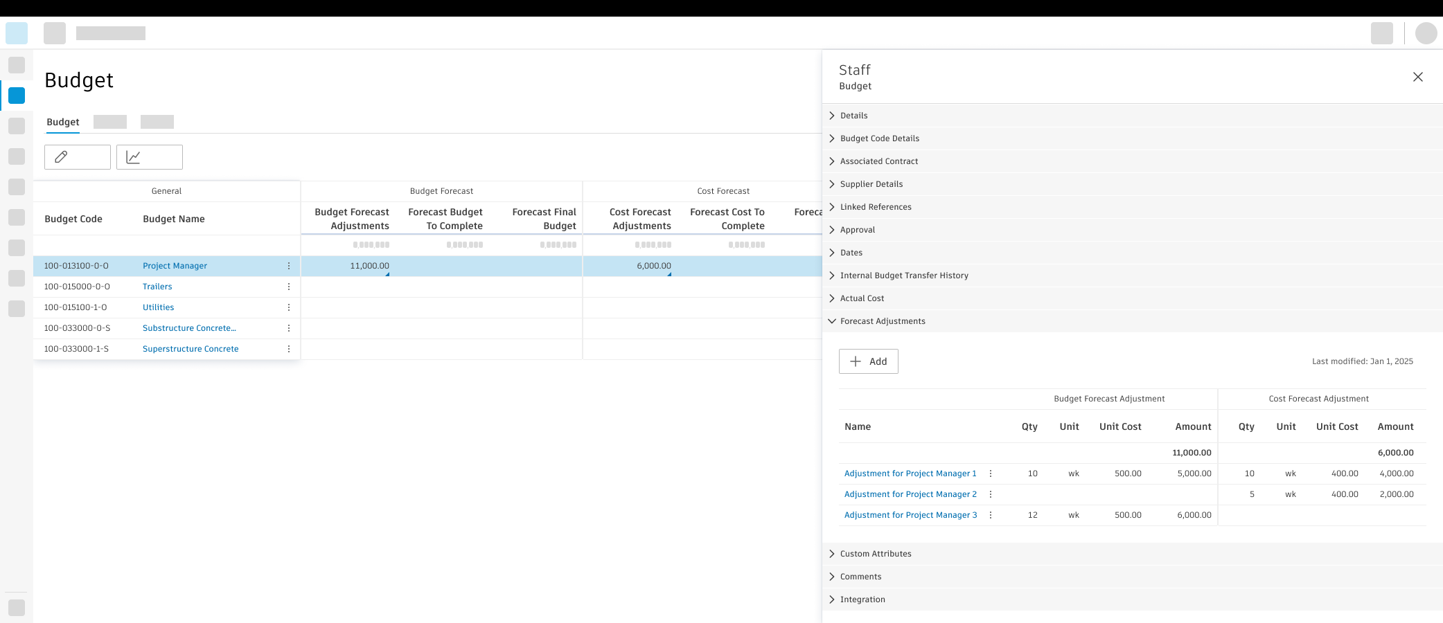

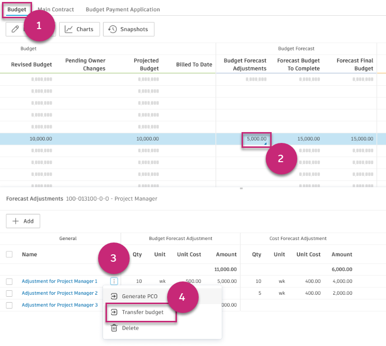

Transfer a Budget Item from Forecast Adjustment
If you work with forecast adjustments and budget forecast was set by the project administrator, you may want to create a budget transfer to request additional budget. To do so, the setting for internal budget transfer must be set on, and then:
  1. Open th Budget tool in Cost Management.
  2. Click the blue triangle in the Budget Forecast Adjustments column in the Budget Forecast section of the table. Those are visible if revenue forecast is on. The bottom flyout opens.
  3. Click the More menu More menu next to the forecast adjustment.
  4. Choose Transfer budget.
Transfer budget from forecast adjustment
Tip: Alternatively, you can follow the procedure from the details panel of the budget. To open details panel, just click the budget name and scroll down to Forecast Adjustments section.
The typical Internal budget transfer window opens. You can check the details of this step in the Transfer a Budget Item section. After budget transfer is created, you'll see the changes in the Internal Budget Transfer column. Budget forecast adjustment Qty is set to 0. As a result, Amount is also set to 0. Unit Cost is unchanged and there will be three activity logs after this procedure.
Tip: Refer to Tips for budget transfers and Important notes from the previous section, Transfer a Budget Item.

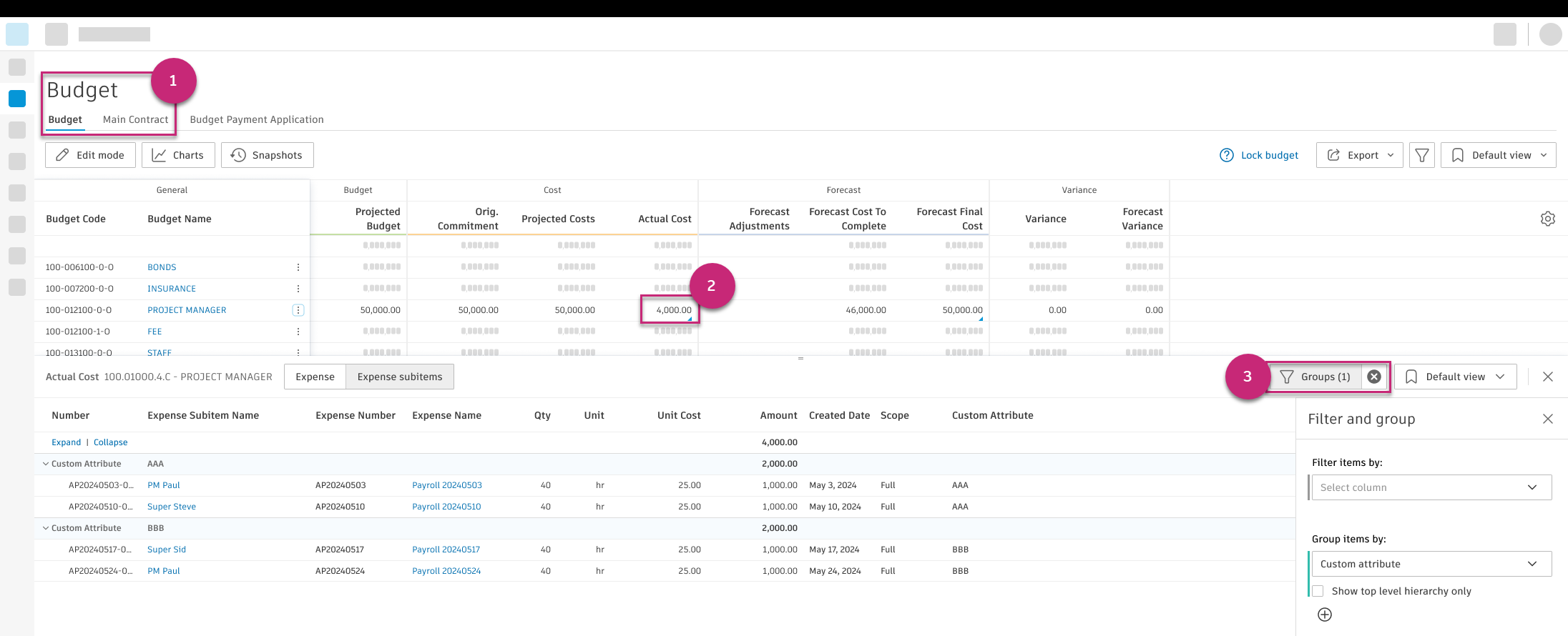

Check Actual Cost in the Budget Summary
Approved and paid expenses are automatically included in the budget summary view. This allows you to see a detailed breakdown of actual costs and make accurate forecast adjustments. Members with Full Control or View All permissions for expenses can use custom attributes or budget codes on expense subitems, enabling flexible arrangement and grouping — similar to how cost items are managed in the change orders view.
To view actual costs:
  1. Select the Budget tool from the left navigation.
  2. In the Budget tab, click the blue icon in the Actual Cost column in the budget row to expand the bottom flyout, which displays all details about expenses, their subitems, and cost payment applications.
  3. Expense subitems are shown in a flat list by default, but you can filter and group them by their own attributes or custom attributes.
Actual Cost Flyout
Note: You can restrict this view for members with No Access or limited View All permissions for expenses.
The expense table and expense subitem table each have their own saved views, independent from the budget saved view. The following properties are saved for each: filter, group, and column width, position, and visibility.
Saved View Actual Cost
You can also see actual cost details by clicking the More menu More menu icon and choosing View actual cost or by opening the details panel - to do so, click the budget name.
Edit Actual Cost

Create Forecast Adjustments
With all cost management activities automatically pulled into the overall budget summary, teams have clear visibility into cost impacts. With a few clicks, you can easily make necessary forecast adjustments to your budget and the changes are visible in the cost forecasting columns in the budget table. See Budget and Contract Tables to learn more about columns in the Budget tool.
If project administrator allows budget forecasting, you'll see additional columns related to this functionality in the Budget Forecast section of the budget table and split view in the Forecast Adjustments section of the details panel.
Split View and New Columns
Budget forecast allows you to forecast both revenue and costs, providing visibility into projected fees by calculating the difference between forecasted budget revenue and forecasted costs. This enables general contractors to manage scenarios where time-related resources may change (such as increased hours) without exceeding the Guaranteed Maximum Price (GMP), requiring either change order transfers or internal budget transfers. See Budget Forecast to learn how to set the setting as project administrator.
To make a forecast adjustment to a budget:
  1. Go to the Budget tab in Cost Management.
  2. Click the Vertical More Menu More menu next to a budget item.
  3. Select Edit forecast adjustment. The bottom flyout opens.
  4. Click Add in the flyout panel.
  5. Enter the adjustment details: Name, Qty, Unit, Unit Cost. The Total calculates automatically.
Forecast Adjustments Button
The total adjustments appear in the Cost Forecast Adjustments or Budget Forecast Adjustments (depending on the type of created forecast) and Forecast Variance columns. The Forecast Cost to Complete (or Forecast Budget to Complete) and Forecast Final Cost now reflect the change.
Tip: You can also generate a PCO from forecast adjustments to request additional budget changes.

Edit Forecast Final Budget and Cost
In addition to adding individual forecast adjustments, you can edit the forecast final budget and cost using different calculation methods. This provides flexibility in how you forecast resources based on actual costs and future projections.
To access the forecast basis options:
  1. In the Budget overview, click the More menu Vertical More Menu next to the budget name.
  2. Choose Edit forecast final budget & cost from the menu.
  3. The forecast flyout panel appears at the bottom.
    Note: You can also click the Forecast Final Cost amount with the blue triangle and then select Edit at the bottom.
  4. In the Forecast basis drop-down, select one of the following options.
Manual Adjustment
Manual adjustment lets you directly enter cost to complete or forecast final values. The system auto calculates the adjustments based on your input.
  1. Select Manual adjustment from the Forecast basis drop-down.
  2. Click Add subitem to break down your forecast into detailed line items.
  3. Enter the Qty, Unit, and Forecast Cost Unit Cost for each subitem.
  4. Click Save.
Output Complete
Output complete lets you enter forecasted units, completed units, or a percent complete. The system auto calculates the final cost and adjustment based on your progress.
  1. Select Output complete from the Forecast basis drop-down.
  2. Click Add subitem if needed.
  3. Enter the Qty, Unit, and Forecast Cost Unit Cost.
  4. Fill in the Completed Qty or Output Complete % columns to track progress.
  5. Click Save.
Note: Output complete requires Actual Costs. If Budget Forecast is turned on, Billed to Date Costs is also required.
Date Range Based Forecasting
Date range lets you forecast resources based on a time period and unit cost. Cost Management automatically calculates the difference between planned and actual costs.
To use this option, configure the frequency settings in Date Range Based Resources.
  1. Select Date range from the Forecast basis drop-down.
  2. Click Add resource to add date-based resources.
  3. Edit the name, start and end dates, ratio, quantity, unit (hour, day, week, month), and forecast unit cost.
    Note: If there are multiple resources, all resources must share unit. Changing the unit in one row will change it in all rows.
  4. Click Save.
If Final Cost Variance or Final Budget Variance is zero, the cost forecast adjustment or budget forecast adjustment will have an amount of zero. However, when the Forecast and Time-Based Variance differ, you can either add a Forecast Adjustment or adjust the Forecast Final Cost. In the flyout panel, click Red warning to add a single forecast adjustment line item.
Key considerations for date range resources:
